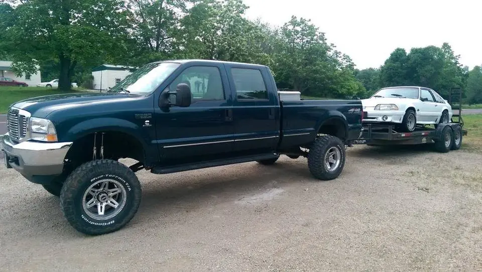

Alright, so I picked this up last week to use for commuting to put less miles on my truck. It's originally a 5.0 5 speed car that has been converted to a 2.3n/a aod car :doh: I checked the vin, it is an original 5.0. So I'm looking for a little advice on it. My plan is to put a carb 302 in, talked myself out of a 351 for fuel economy sake. The car still has a clutch pedal in the floor, so I'm debating T5 or aod. I'm not going crazy with the motor, want to get it around 280 at the wheels. Will a factory aod hold? I know T5s are weak, but I'm not talking a lot of power to the ground either. Which would be the better option for mileage and longevity? Oh, the car does have 3.73 gears, subframe connectors, and a bbk lowering kit. Thanks!
Wow, Did you atleast ask why they put a 2.3 in it?
Sounds like they wanted the better gas mileage AND the style of a GT ;)
I would go T5 especially since the clutch pedal is still there. I have an AOD and hate it, I desperately need a shift kit for it.
He said he swapped it about 6 months ago after he blew up his 306. Had a wrecked lx sitting around so he swapped powertrain. Thats his story at least.

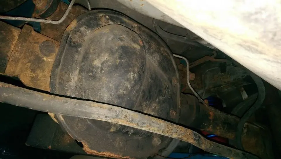

My goal is just to keep miles off the truck. I'll be happy with 15 or so mpg. I pulled the cover on the rear end last week and it's junk, so I pulled an sn95 3.27ls rear and front spindles/calipers and brake booster/master cylinder/proportioning valve. At least that will get the car road worthy again. I think the taller gears will be better, not only for fuel economy but for top-end. And disk rear and some nice 5 lug wheels will make the car look much better.
