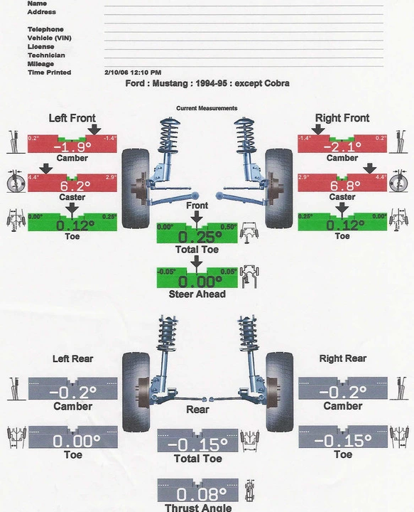

Here is my extremely aggressive alignment from Steeda.
Their road race car has -2.5 degrees camber. Normally they would set up a street car with -1.5 degrees. For some reason they couldn't get mine there. It does handle very well though.
Front suspension is-QA1 Tubular K member, Tockico 5 way adjustable struts, Steeda bump steer kit, Pro3i caster/camber plates, C springs.

Joe, thanks for putting up your sheet - that is interesting to see.
