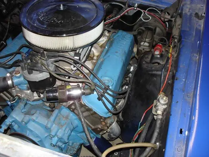

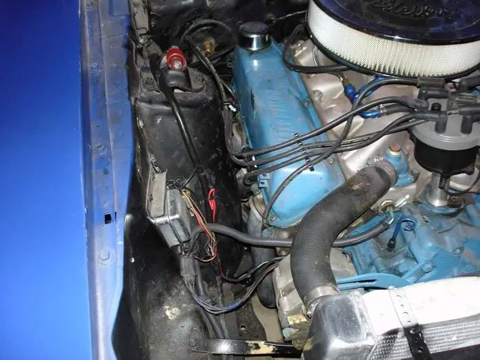

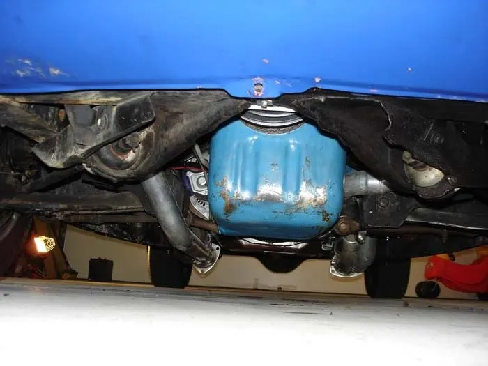

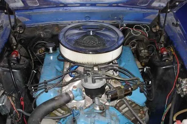

Not a BBF but a BB swap none the less. Probably an easier swap than a 4.6 DOHC.
