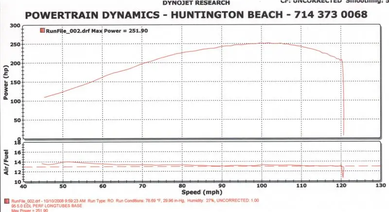

just got back from the dyno.....if anybody cares :)
i dynoed the car before i throw some heads and a cam on it. ill probably change the mani as well too.....for the dyno i had eddy performer intake, LTs, X pipe, borla catback, underdrives, cai, C&L 76mm Maf (which is causing me issues), short belt, and an aluminum d/s if that even makes any hp.....i have more mods but those are the ones that add hp...ohh and i dynoed it with the stock tb, not the 70mm stated in my sig.
i made 251/306
what do you guys think?
im having trouble uploading the graph
Yeah, 251/306 is very good for a long block 5.0 with only "stage 1" bolt-ons and an intake. I'd be interested to see the graph. The best I've seen with a stock long block, stock intake, and only "stage 1" bolt-ons is 235/290 so the Eddy Performer IS adding HP/TQ despite the restrictive stock heads. The Performer is a long runner intake that performs best from idle-5500rpm so that could be the reason.

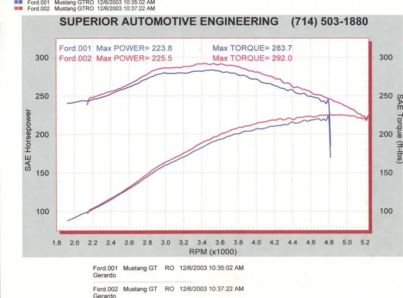

Attached. Impressive #s!
Wes
Shame there isn't a graph with rpm but since the run was done in 4th gear (20.5mph/1000rpm with 3.73 and 245/45R17 tires), the 252rwhp peak is at 5000rpm and the 306rwtq peak is at 3800rpm.
