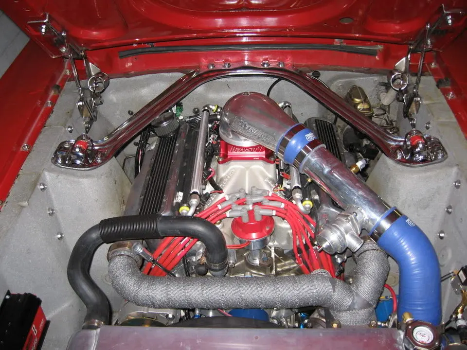

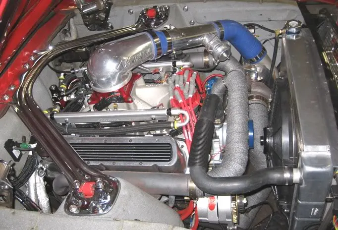

Just got back from the track (new best).
I'm looking forward to that video. How about a new shot of under the hood? How much E98 does it take from your house to the track, passes and back home? Will a full tank and a 5 gallon can do it?

i get about 7mpg, or 8gph. a full tank plus 5gal will do it, but i carry two 5gal cans. my 120# inj were at 95%. i cranked the fp from 45 to 55 and my dc dropped to 85%. fuel consumption is crazy for e98, but 20psi and 26deg timing with no intercooler is alright.
