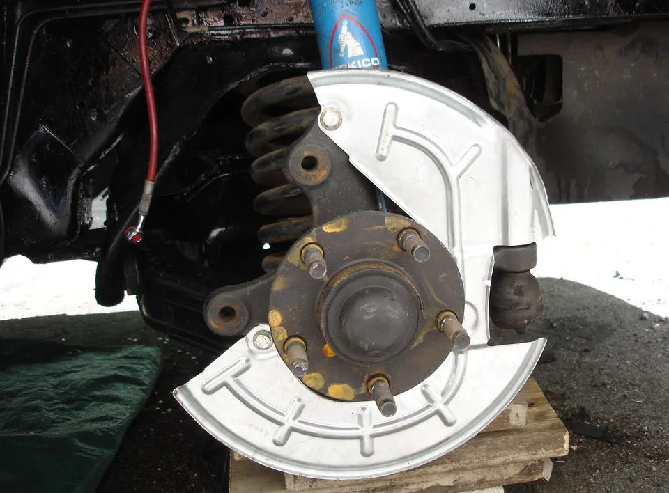

EDIT: Oh, and since it always seems to be a prob....this is how they go on. You don't need rivets. I used bolts with nylon lock nuts and blue loc-tite. This is the pass side
