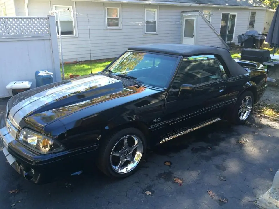

Ive always had a soft spot for the 5.0s. I finally came across a good deal but I have tons of questions. So I got a 91gt vert with 104k on her. Mods the person I bought it off said she had. Cobra uper/lower,bigger MAS air. CAI/no cats/h-pipe/3.73 rear control arms/sway bar/. Questions are i was thinking headers and thats it? Anything else I should look into? and where would you estimate this in the 1/4? Thanks for all the help guys

thanks guy. I was refering to the car as a her haha. Already had it checked out before purchase by a well known speed shop....came back fine.
