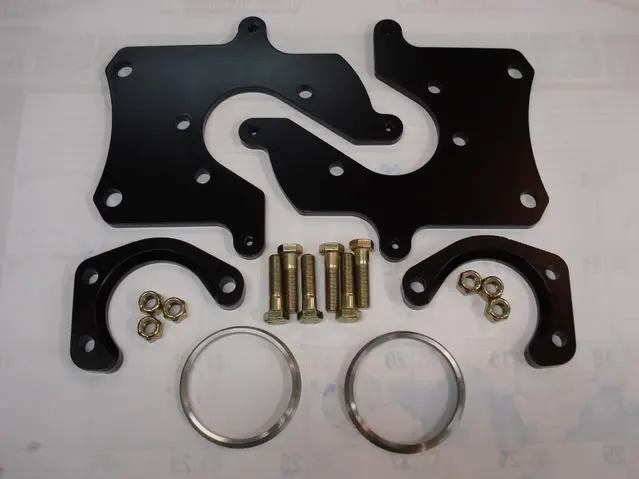

If you are getting the NRC brackets you don't need the stock mounting plate the dust shield bolts to. That is the part the NRC brackets replace.
Now a friend has his own design brackets and they bolt on the inside of the axle flange, mounting the calipers on Ranger axles properly. Here is a pic of one of his brackets, the others are very similar:
He sells them on ebay and other web sites.

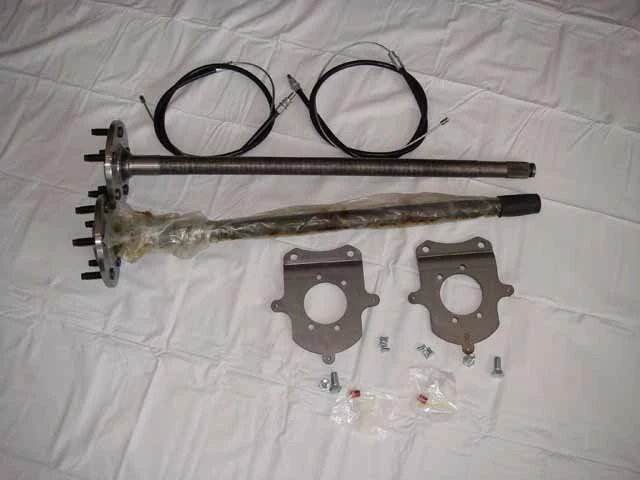

all the cobra parts came off a 96 cobra with around 44kmi. they've been sitting for about a year so they have a little surface rust but im going to clean everything up and paint them again. i got the spindles with dust shields, rotors, calipers, brackets, lines, and bolts for the front. and the rear calipers, lines, brackets, dust shields, cross-drilled rotors, pads etc for $550. the rear rotors and pads only have about 400 miles on them so thats good. i am using 94 spindles so im going to resell the cobra spindles and abs sensor parts i guess.
heres a pic of the kit im getting from NRC
