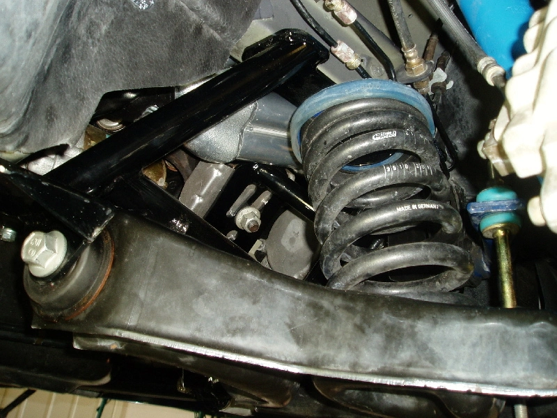

yes if they have perches you can use them. although if it were me i'd just get a k-member where you could use the stock arm. i personally would feel a lil more comfortable doing it like that & here's why........ *note* this isn't factual, it's just the way I see it......... the tubular a-arm has a spring perch welded on, a stock a-arm is cast with the indentions inside the arm. in the stock a-arm there is plenty of metal holding the spring in. on the tubular a-arm with the welded perches, you only have a few different welds holding the spring in. & the front springs are holding about 1/3 of the cars weight. because of that i'd feel more comfortable doing the stock a-arms if i hadn't done the full coil over setup
stangman said:
you know what, i think that k-member will allow for stock a-arms, if you wanted to go that route. i'll have pics up in a few minutes............
I just installed a PA Racing K-member and I used my stock A-arms and current suspension which is Eibach Pro-Kit Springs and Tokico Struts.
Contact PA Racing and tell them what you want to do. They will build you a K-member to meet what ever suspension you want.
