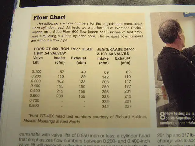

Anyone know anything about these heads? I've seen the reports on Jegs, and a buddy of mine is considering them for a 427 Windsor stroker motor he's already got.
Are they all that and a bag of chips or are they chips of a different kind? Can you even get them?
the new Kaase heads should be really good heads, even though they're just jegs heads. They have a canted head design (if i read correctly) which allows the fuel and air to dump into the cylendar much more easily. Basically, the valve would be on an angle that allows it to flow away from the cylendar wall, vss the straight valve design, in which the fuel and air hits the valve and tries to spread itself out and against the wall of the cylendar. Black70fastback can help you out with this even more. Tell him Lee sent ya.
I just looked them up on the Jegs site and I must say they are quite intriguing, but there are a few things I dont like. The peak flow is ate .800 lift for both intake and exhaust ports, but none of the valvetrain included in the head assemblies is capable of that. The second is that they compare the Kaase heads to AFR 185s, which are not only less expensive, but have smaller intake valves and much smaller intake runners. I'd rather see a comparison with more equal heads like AFR 205s(price) or 225s(size).
Well, the canted valve design is really old technology being brought back to use in these heads. an 800 lift? shoot, and i thought i was making an improvement with .500 lift! True, the prices are up there, and I wouldn't get them until it goes down again. I think the price is just high right now because it's new and has that "Kaase" name on it. With the angled valves, your lift is FAR more effective than a straight on valve, so all the SIZE of the runner is more easily dumped into the head. I'm sure that since AFR has done plenty of research, it probably matches up with the 205 or 225's in flow rate, but does it more efficiently.
They make LOTS of claims, but no one has done a clear article or test on them. They promise HUGE number gains (like in the 100's of horsepower), but I'm really skeptical.

You gents must never read Car Craft then because they just ran a 3 page extensive article on the Kaase heads. The heads outflowed everybody else at .300 and .400 lift along with peak lifts. True that there max is at .800 but that doesnt mean you have to take them to that extreme to make more power than the other brands. It just means they have more potential. They outflow everybody else starting at .300!! These things will make 500+ on a 100k mile 302, so the potential is there. Pick up the articel because I dont feel like breaking it all down for you. The downside is the price, plus you have to get special valve covers to clear the valvetrain. You have to remember that canting the valves and putting the side load from the pushrod to the rocker at 90 degrees greatly reduces valvetrain stress and wear so these heads will last longer by theory. And they do compete with 205s/and 225s.

Here's my only beef. If you look at the CC article, I BELEIVE it said the heads they were using weren't PRODUCTION Kaase heads but, instead, prototype heads that were SUPPOSED to be representative of production. Mmmmmm . . . just don't like the sound of that.
