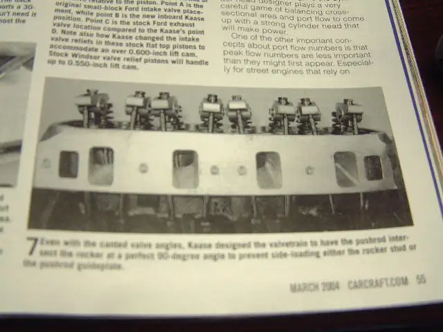

While Side-loading has been addressed to a certain degree I wonder how longevity in the lifter bores would be with a high lift/duration camshaft with that pushrod angle. It is hard to tell from their picture so maybe the angle isn't really aggressive enough to be an issue.

Once again I have to ask: Is anyone actually USING them? I'm not really swayed much by magazine articles or mfg claims. I want to hear from Ed in Ogden, Utah who bought a set 3 months ago for he and his brother to race weekends with. Or an independent engine builder . . .
