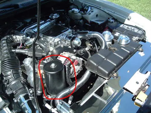

wht does the KB one look like? i saw a pick of a KBed mustang and i didnt see a resovoir.
It's a round canister that sits right by the alternator. Black, I think.

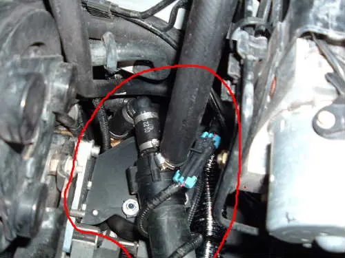

here's acouple pics of mine, the new res mounting brackets have mounting screws on the bottom for the res. pump which is pretty cool.
I would like to find a better looking one though. Polished perhaps
1st pic of res on top
2nd pic is from underneath the car. it's the res pump mounted underneath the the res..

Blue Blurr
Apr 1, 2004

ahh ok. thanks for the pics, maybe ill try and use the saleen one. it looks stock and goes right next to the radiator one
I think the saleen one will work fine.
