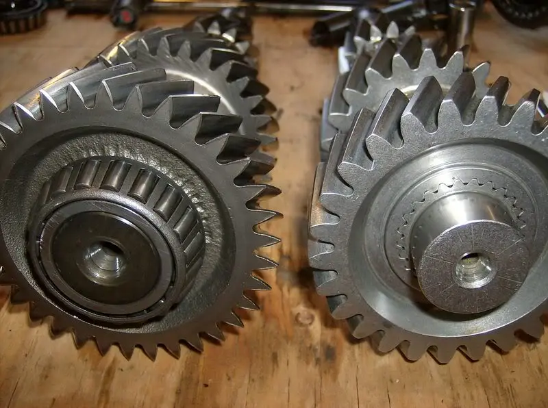

It's good that you figured out what was causing that particular problem, but I wouldn't spend anymore money on stock t5 parts. I believe I read somewhere that you're running a 150 shot? I wouldn't expect stock t5 parts to last very long behind that, mine broke with a stock motor. Next time go with an Astro Performance or G-Force gearset.
Stock t5 on the left next to my Astro stuff on the right.

How reasonable cost-wise is it to upgrade with astro performance or g-force parts? I love the way my t-5 shifts v.s. a tremec, and would really like to stick with the t-5 after my current one pops.

any gear whine with the astro stuff?

Most the time i only run a 125 shot, and dont spray it out of the hole. The t-5s are so cheap to fix thats why i still run it, maybe if i get some extra money ill go with a G-force or astro but the car is a daily driver so cant have it down for long.
As far as cost, the gear set is $1100. It includes mainshaft gears, countershaft, and a 26 spline input shaft. With the gearset, synchros, bearings, a pretty nasty clutch, and shipping I paid about $1600. Worth it to me to not have to change anything else ie:bell housing, shifter, yoke, crossmember, etc. The t5 is lighter and shifts much better than tremecs like mentioned above.
As far as noise, I still haven't gotten the thing together. Haven't had a whole lot of time to work on it. I can say the gears look like they're probably going to be a little noisy, but the Astro guy I talked to when I bought mine said they're not loud at all, and quieter than g-force. I don't really care either way.
