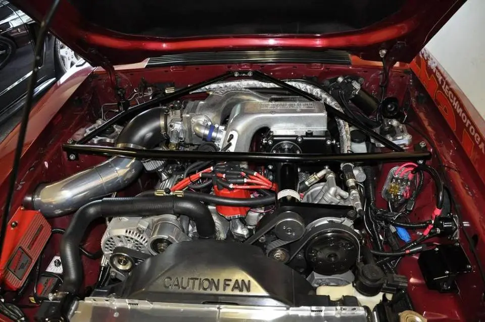

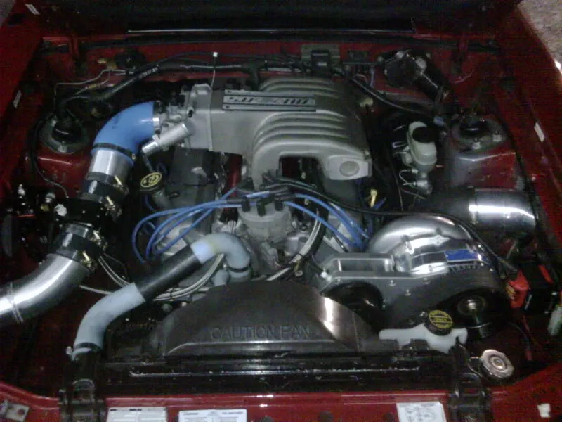

you'll be hard pressed to find anyone that has personal experience with a KB on a Fox. They're few and far between.
Here's the KB I put on my dad's H/C/I '93 GT:
http://s142.photobucket.com/albums/r98/sraldiris/?action=view&current=FASTXFIFirstStart-1.mp4
Here's the ProCharger I put on my stock-302 '89 LX:
http://s142.photobucket.com/albums/r98/sraldiris/?action=view&current=89F1RFirstStartup.mp4
The ProCharged '89 was quite a bit faster than the KB '93, and the KB installation on the '93 was a NIGHTMARE!!! As in, I will NEVER install another KB on a Fox, no matter HOW MUCH the person is paying!!
Cliff's Notes: ATI ProCharger for the WIN!!!

The F1R supports 1300hp. I put it on the stock engine as part of a tech project for 5.0 Mustang & Super Fords Magazine. We pullied it WAY down for the stock 302. The car ran 11.36 @ 122 on 12 pounds of boost. It would have been faster with their entry level P1SC blower. (less parasitic loss) In fact, I've been 10.17 @ 132 on a stock block 306 with a P1SC pushing 17psi.
Incidentally, I beat on that stock 302 like it owed me money and it WOULD NOT blow up under that F1R. (tune by Rick Anderson at Anderson Ford Motorsports) When we swapped the 427W into that car, I installed the stock 302 into another Fox of mine and beat on it for another year.
