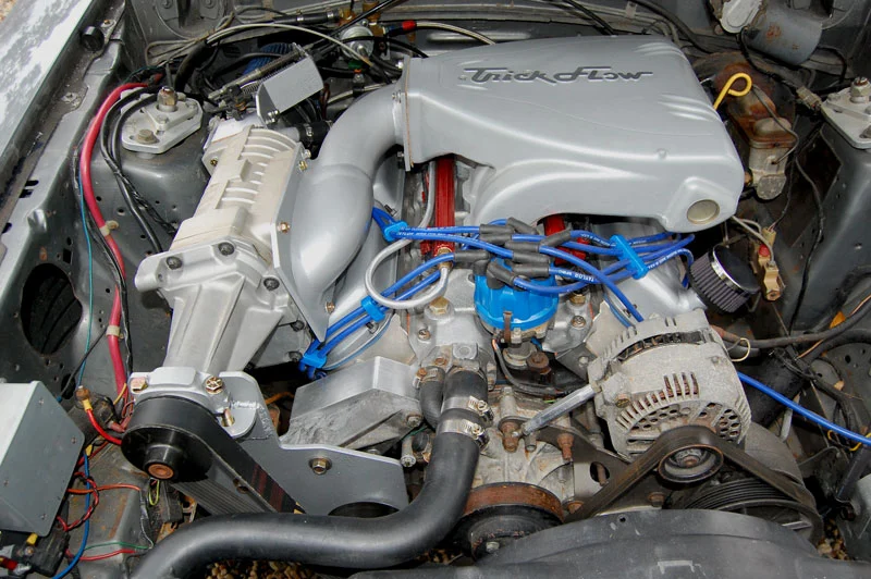

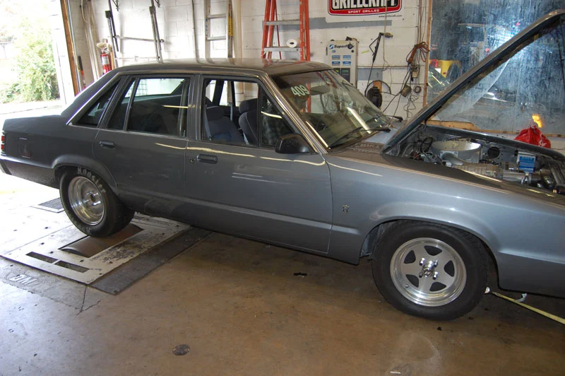

Stumbled across this on "that other" website. It's an '84 4-door LTD with a junk 5.0 shortblock, some Trick Flow top end parts, and a used Eaton M112 supercharger at 10lbs boost. It ran low 11s before the shortblock came apart (ate a piston). The owner seems pretty confident that it has 10s in it with a fresh bottom end and a better tune, and I don't doubt it from what I've seen.
What say you?!
What say you?!
While i've seen the m112 adapted to a pushrod engine, it wasn't a pretty sight.
That one actually looks pretty good.
