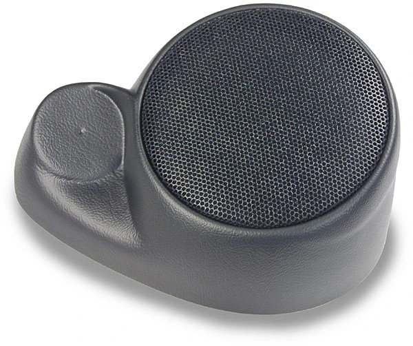

These, just get these!!!
those look like Q Logic's. Im in the process of opening a account with them
Those look like the ones I have. Picture on the 1st page.
I found them here:
http://www.crutchfield.com/S-H8xALk13W9H/cgi-bin/ProdView.asp?g=182850&I=044U50011
They are $120 for a pair, the website says they WONT fit a 67 Mustang and the only review that was written says this...
Rating 1 out of 5.
a lot of money for so little product
Written by Lee, Longmont Colorado on October 12, 2005
These aren't even cut out for the speakers and no template & no mounting holes. Cheap plastic & certainly not worth the $120.00. I thought I would at least get an enclosure that had good acoustic capabilities without having to buy more material to pack it. In my opinion $20.00 would have been a good price for this product.

Edbert said:
I found them here:
Hmmmm...well my friend put a set in his 82' S-10 and they sounded great. Who knows

Thats a lot of money for something with no speakers. I am thinking that the setup that chelle came up with and the addition of a directional mounted tweeter would work pretty well. $6 for the pair of rings, $25 for the kickpanels and then whatever you want to spend on speakers is not too bad.
tweets something like this:
How did he mount them? Are there tabs or something on them that get screwed on from the back?
$120 is a lot of dinero for some plastic housings regardless of sounds and mounting.
He got some off of Ebay. We bolted them together and then covered the back in Dynamat.
