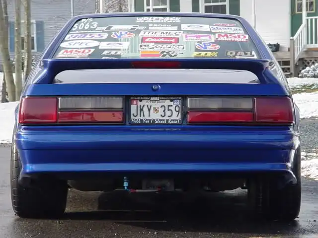

There is some guy who used spacers to move the license plate out, then mounted the kill swtich behind that. That way, you cannot see it from outside the car. Total sleeper look. Plus, you don't have to punch a hole in your tail lights. He posted a pic looong time ago, somebody might have it still...
I have mine mounted right behind the licence plate. I remove the small screw and take the turn handle off and mounted the plate normally. It kind of slopes out a little, but it stays under the lights and you can't tell at all.

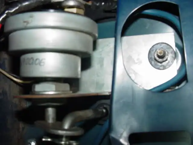

There used to be a switch called the Pony Switch that came with a bracket to mount the disconnect to the RH tail light bolts and placed the push handle inbetween the tag and the RH tail light. I dont know if they still make em or what, but it was a nice set up.
Here is the Pony Switch on my old GT....
