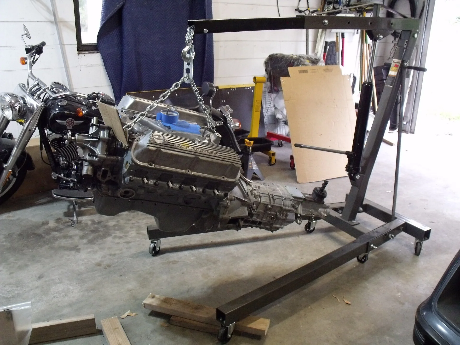

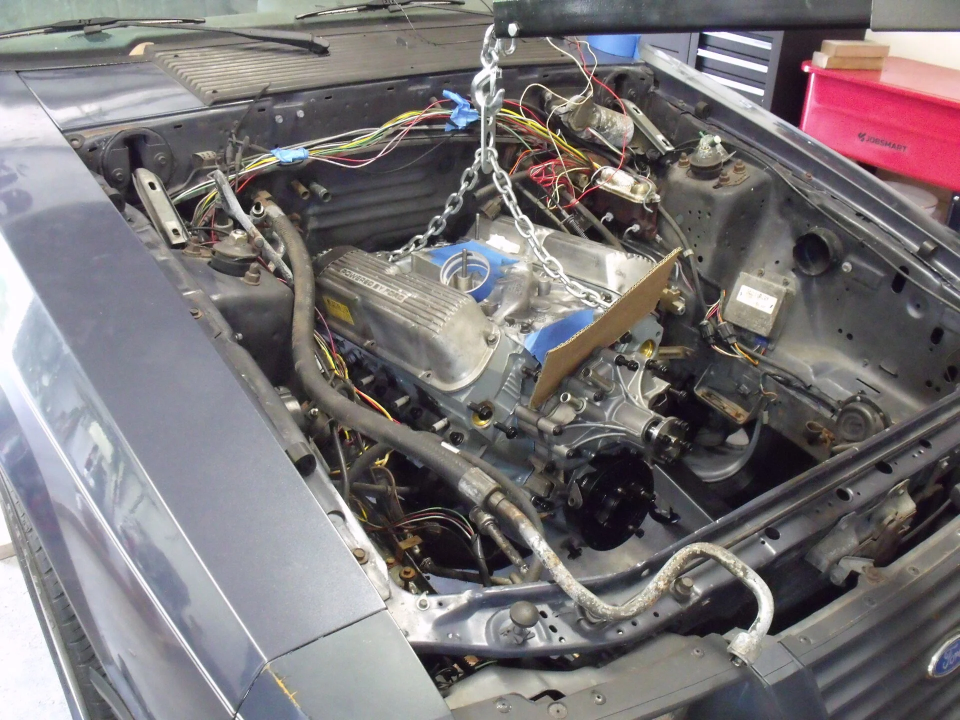

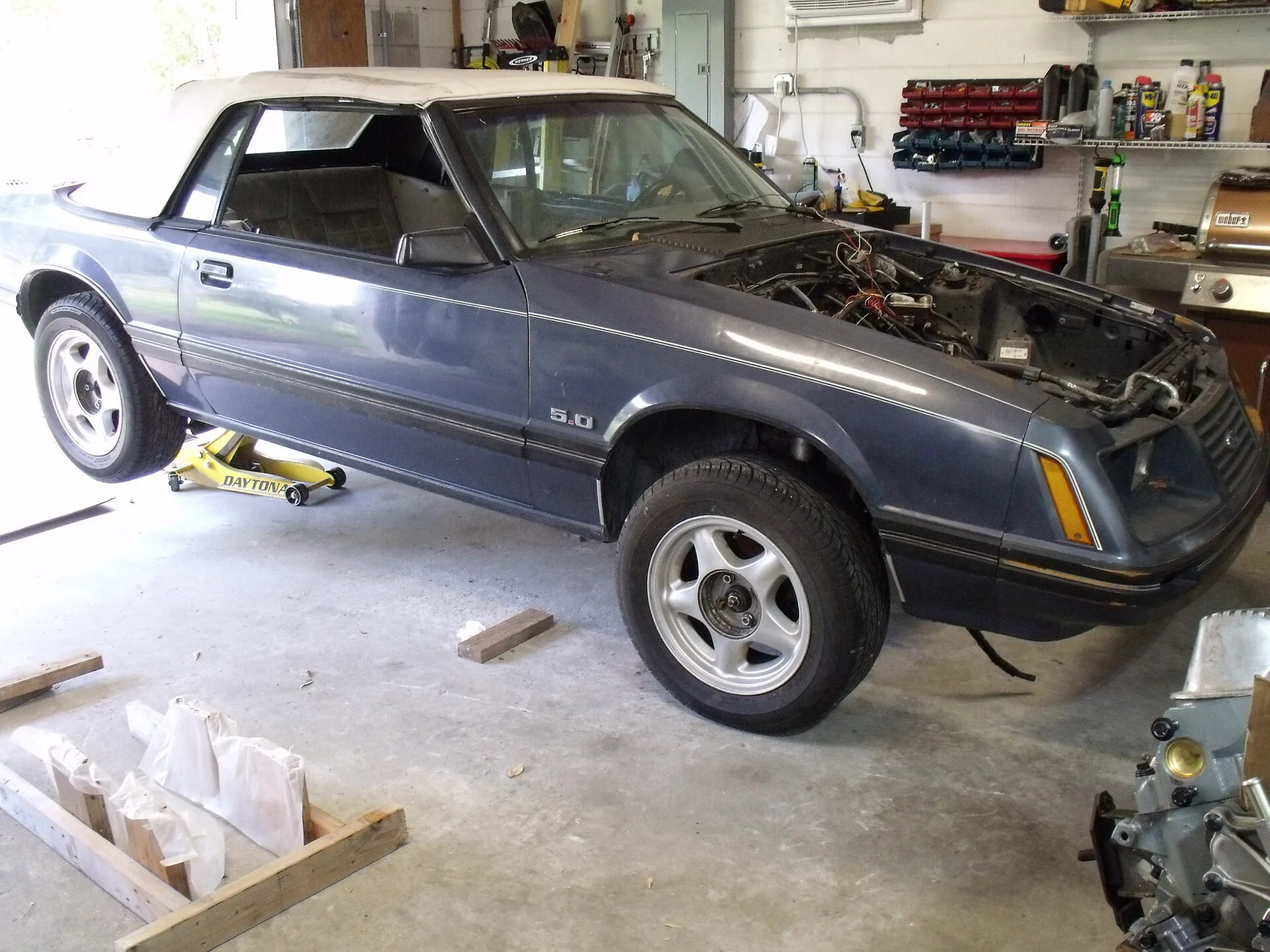

After spending too much money on spring compressors I gave up
The OTC one I think might have worked, but as a cranked down on it, it got almost too hard to crank on my 24" breaker bar.... Just didnt like it...
So I spend an hour last night reinstalling the 4 lug rotor/hubs ( sure glad I didn't throw them away) and spent this AM installing the motor so I have the weight to compress the springs and remove them.....
Yes, the engine is going to come back out, but that might take an hour or so.... Better than the two weeks fkn around with ordering compressor tools...
