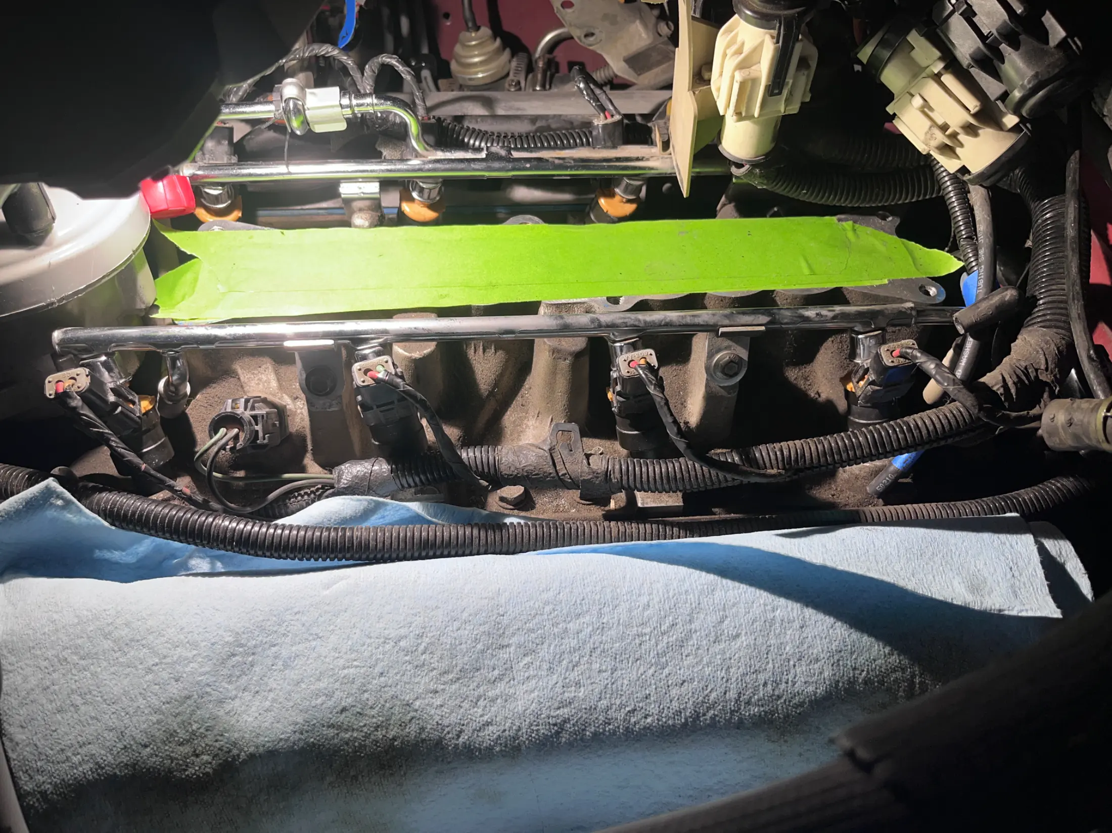

Got the injectors back in and fuel rails tightened down. Put a little motor oil on the o-rings and they all slid in easily.

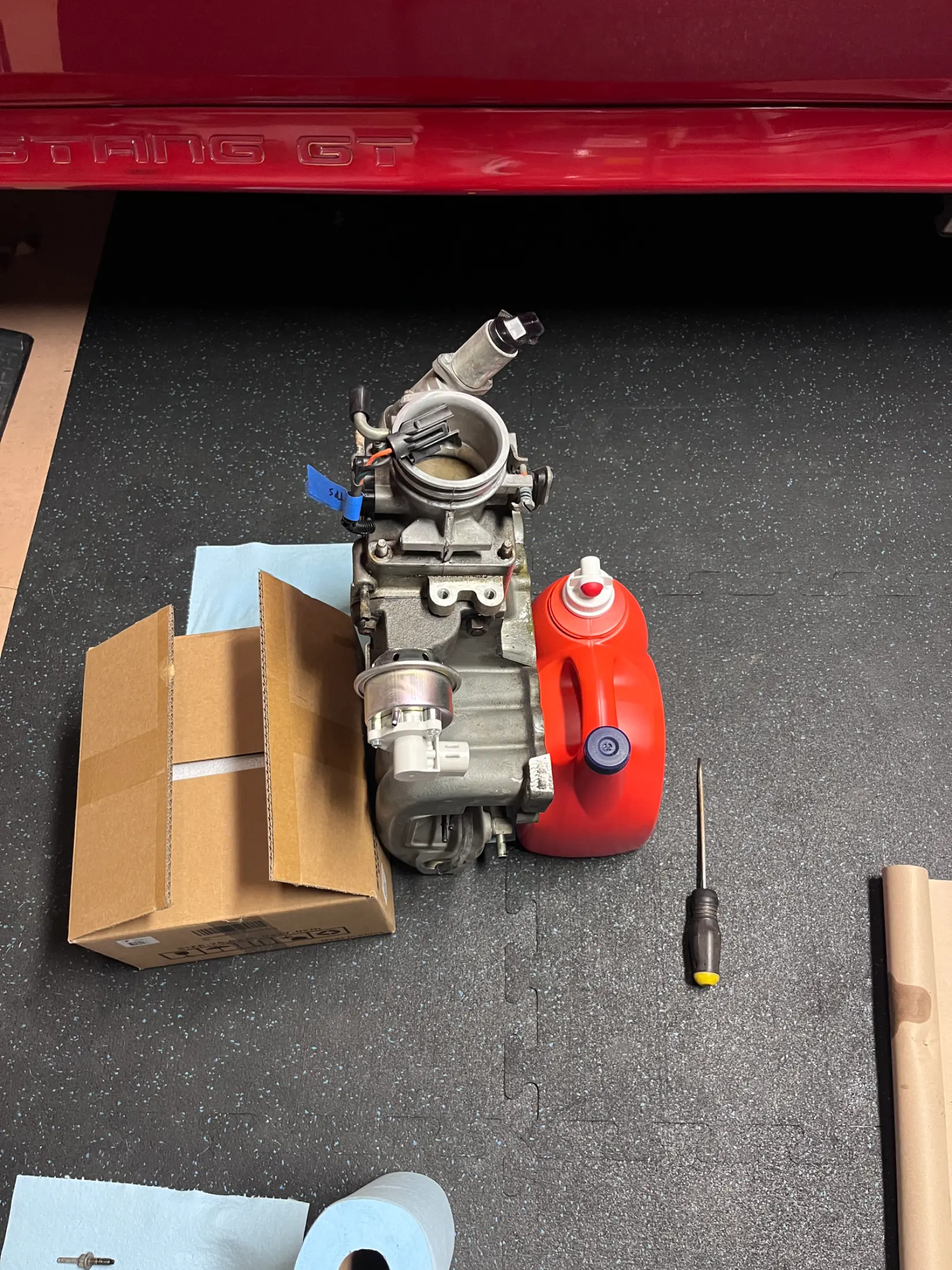

Tried removing my crossover air tube that goes behind the heads, but bolts were stuck so I sprayed them with penetrating oil and will try again another day.
Speaking of penetrating oil, I couldn’t get my throttle body separated from the studs, so I propped it the whole intake upright and sprayed penetrating oil to let it sit overnight.

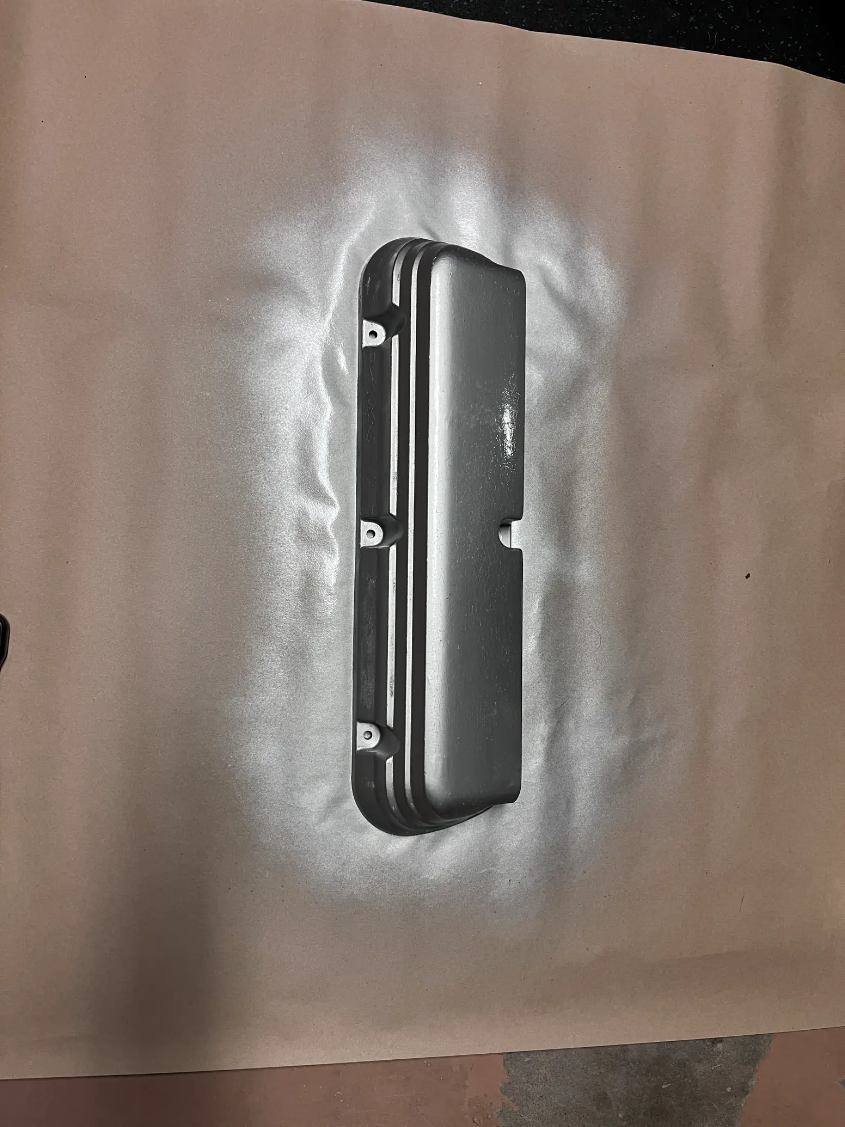

Lastly I put two coats of clear on the valve cover. Not going for show car quality, just something better than it was.

Watch out on the TB studs. If the coolant was leaking a little bit it seems to really wreak havoc on the studs.
Good post, I may have to go that route. I bought a trick flow gasket and stud kit so I have all new studs to go back in.
