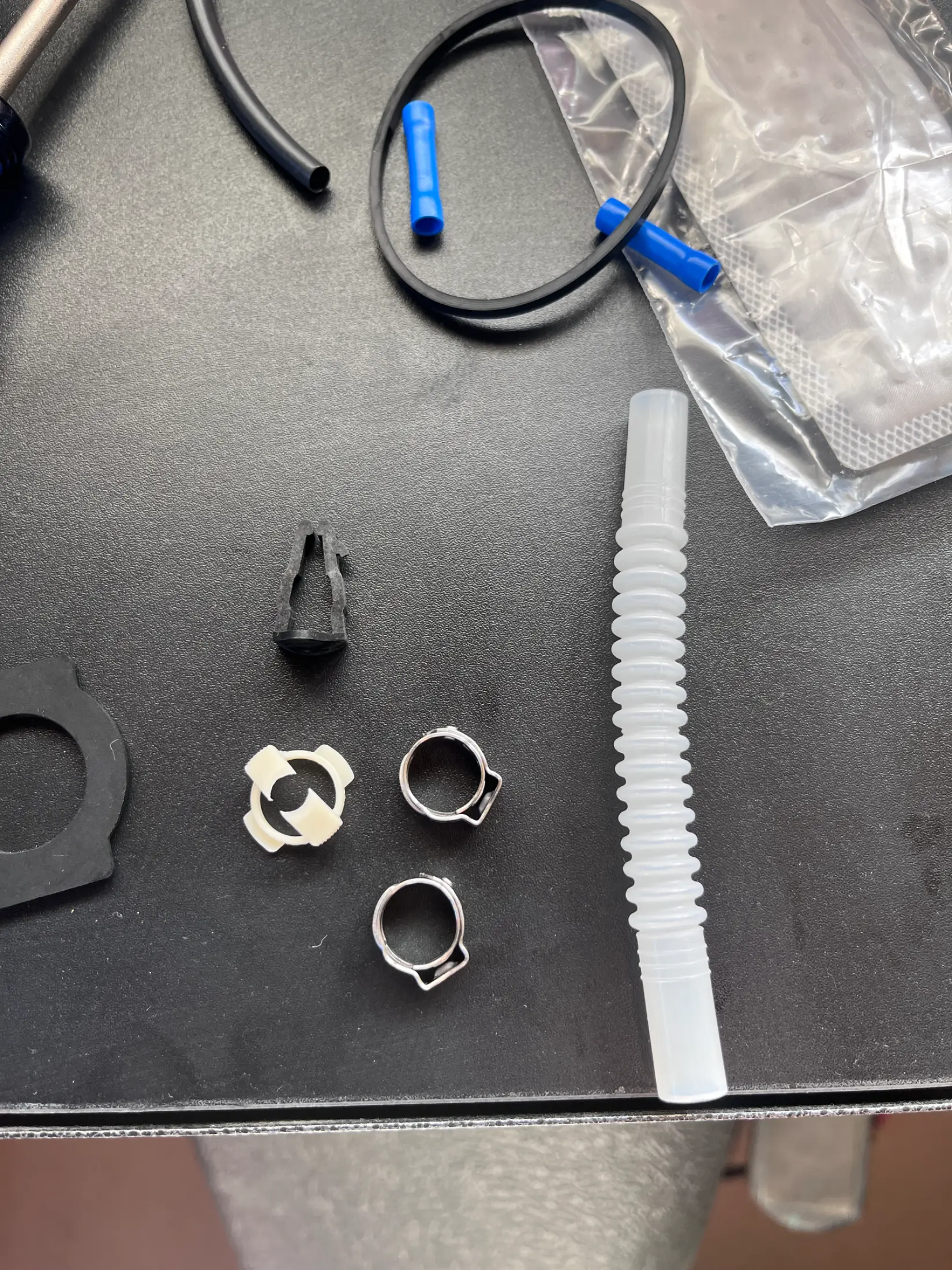

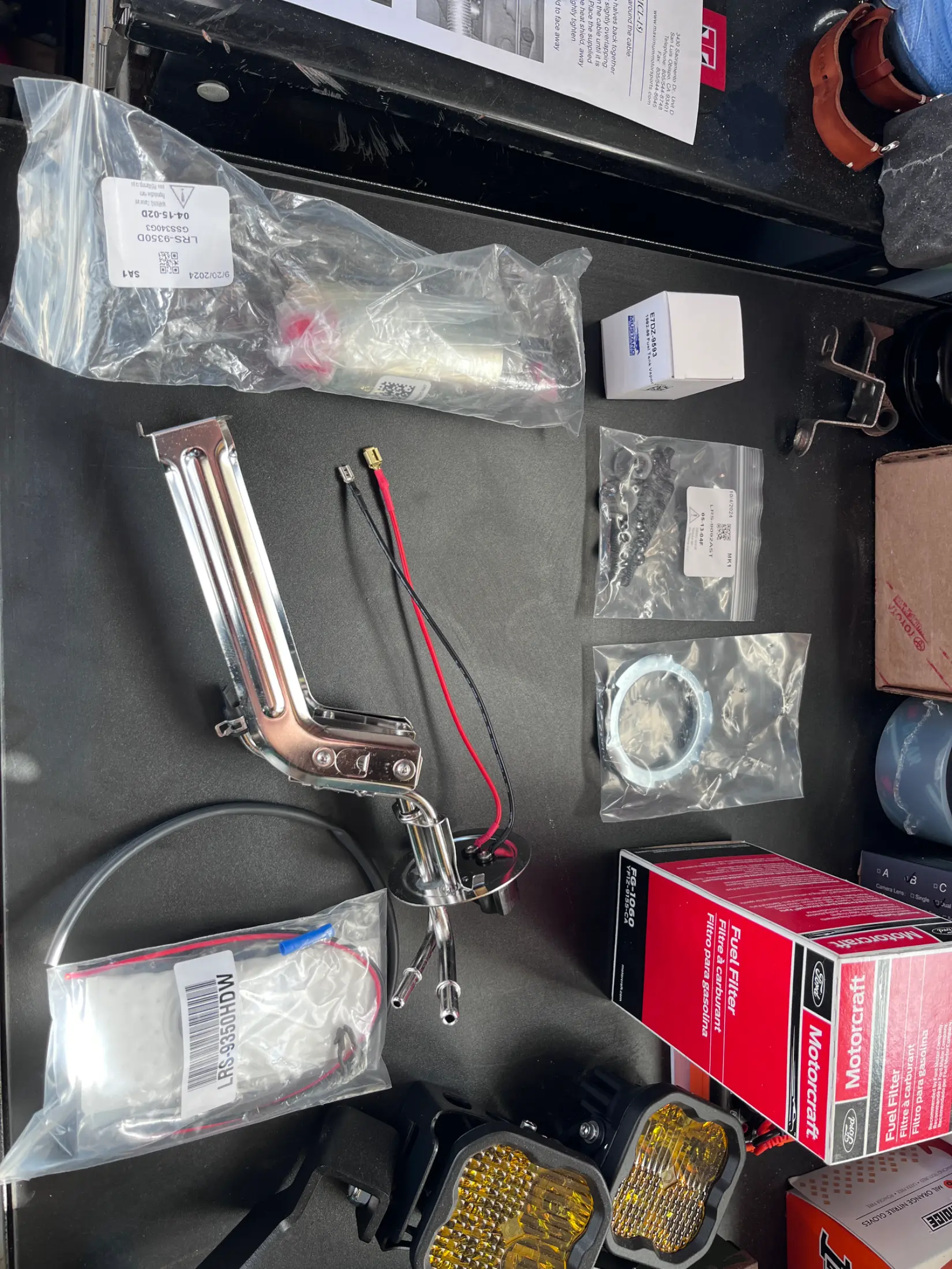

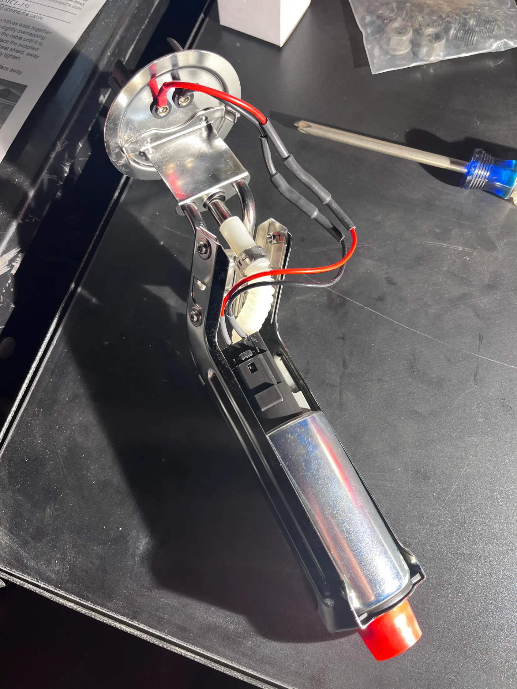

Ok so all the install videos I’ve watched have like an actual fuel line hose and socket clamps… the kit I got from LMR has the white flexible plastic hose and those weird hose clamps. I feel like the ridged plastic flex hose would create turbulence with the fuel flow compared to a smooth fuel hose. Should I spring for actual fuel line hose and different hose clamps?
If anyone knows what those other two pieces to the left of the hose clamps are please share.
Edit: ahh the plastic flex line is E85 compatible. Not that I’m running E85 but at least I know. I did buy some fuel hoses but not an actual ‘s’ hose.

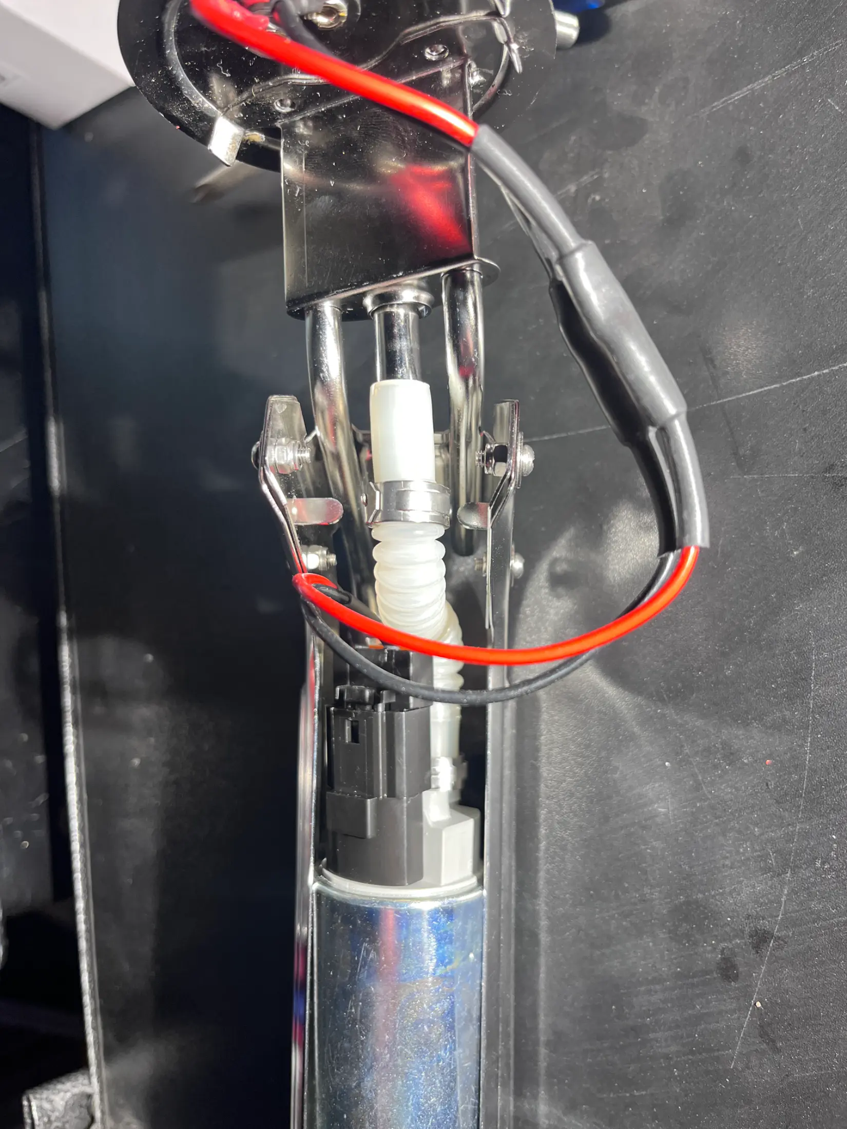

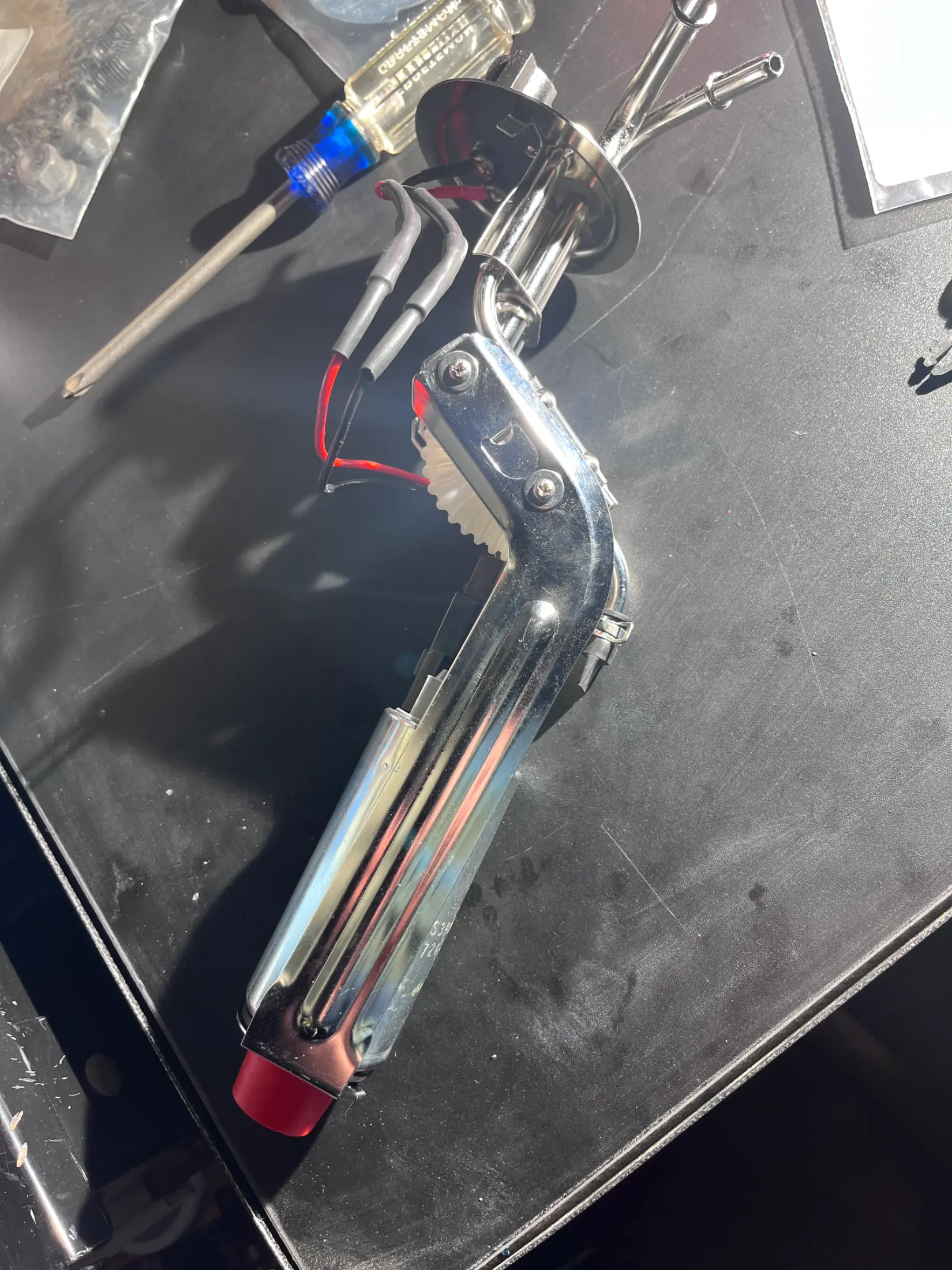

Got the pump assembly completed, anyone see anything glaringly incorrect with it?
I haven’t done the pinch clamps yet because I don’t have the right tool for that type of clamp, debating on removing them and putting normal screw type hose clamps on.
Ok thanks everyone. So last question tho, the ridged plastic fuel line (shown circled in green) is totally fine? I’ve never seen this type of hose for fuel pumps:
One other thing I did was ziptie the electrical wires to the hangar. Is that a no no?
The white flex hose is just fine. Aeroquip also supplies it with their pumps and they know a little about fuel systems.

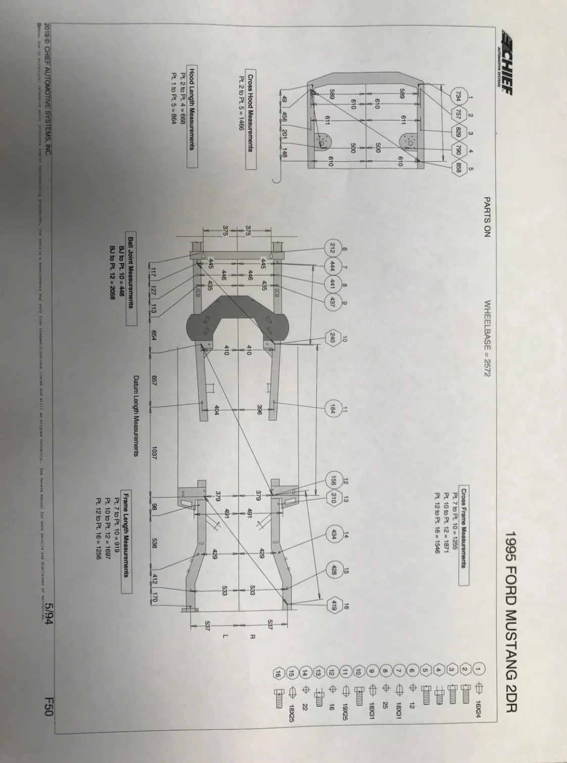

Ugh, nothing ever goes right, lol. Got a call from the welder to come on down, needs to show me something. Never good news to hear that. I go down to his shop just now and he shows me that the drivers side front and rear subframes don't align right (like not in a line down the car), like if you put the subframe connector where it should be on the front, the rear is off by like 1/2" side to side, and vice versa. TBH, both front subframes look beat to hell but he said the passenger side will work fine. Its almost as if years of jacking the car up has pushed the drivers front subframe up and inward to make it cockeyed compared to the rear.
He called MM to get their opinion on what to do. I'm just hoping they don't suggest taking it to a frame puller or something.
It’s for a 1995 but if memory serves me correct the frame dimensions are the same for the Foxes.
The rear of the front subframes and the front of the rear subframes don’t line up from the factory.
Thank you, I’ve passed this along to him. I see where it shows the subframes not being perfectly parallel but he literally showed me by holding up the subframe connectors and the passenger side all lined up nice and neat but the drivers side was off when holding it up. So something isn’t right I’m just curious what lol
