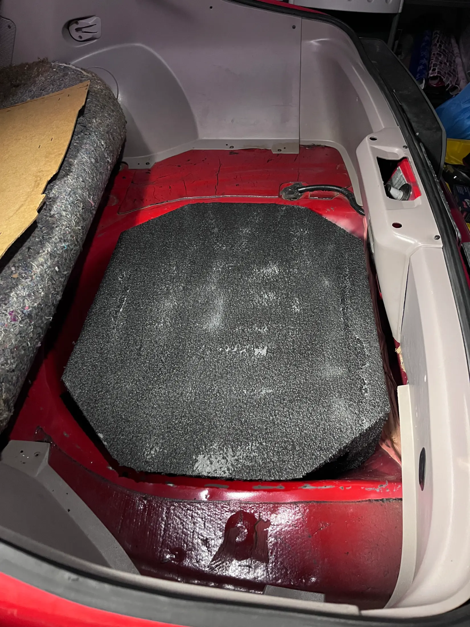

Ok finished my spare tire ‘spacer’ using high density foam. Basic idea was to fill the void of the spare tire with something light but also could withstand some weight sitting on top of it so the wood panel and carpet wouldn’t sag into that space:

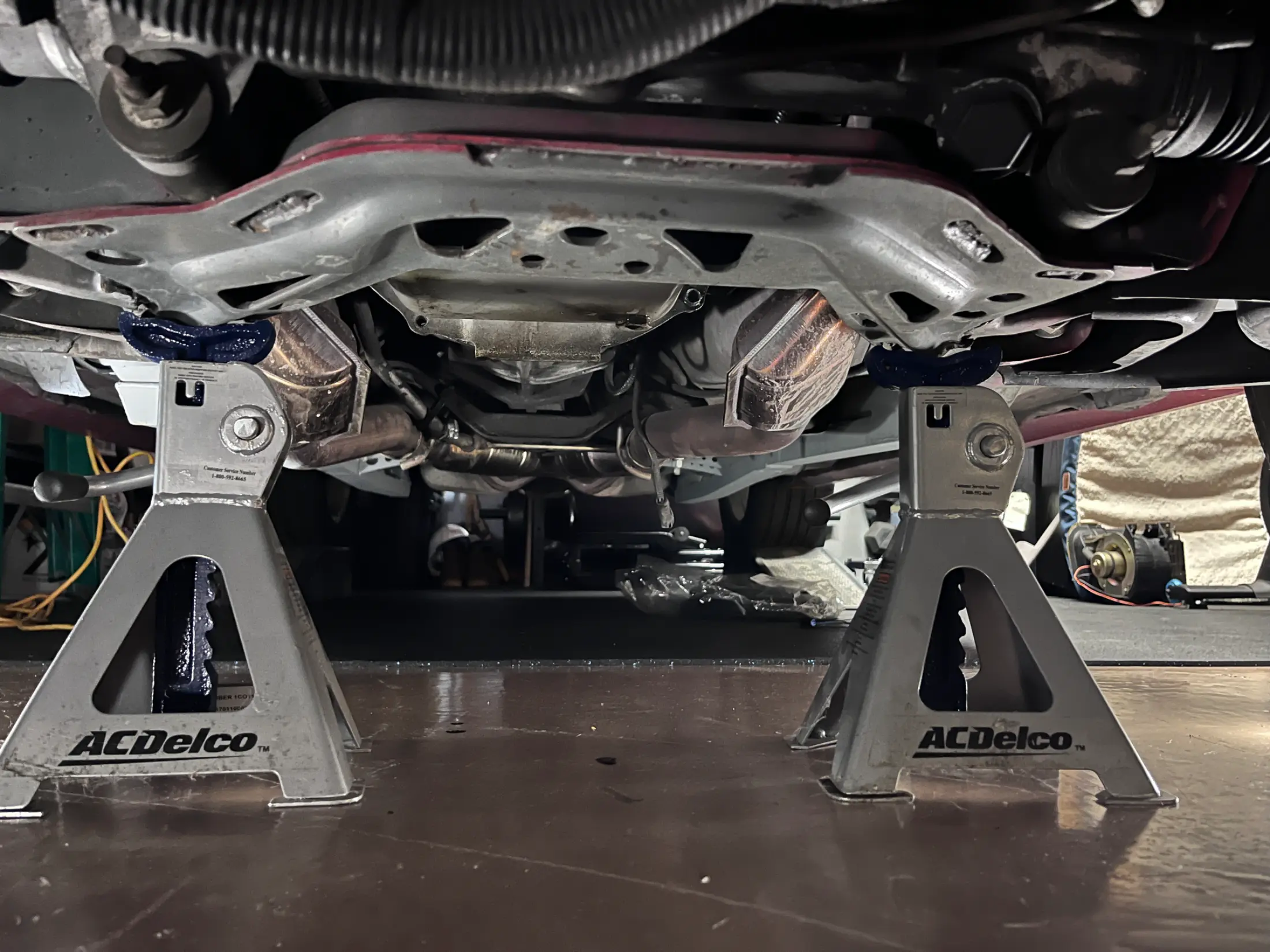

Second, question: are these safe jack points?

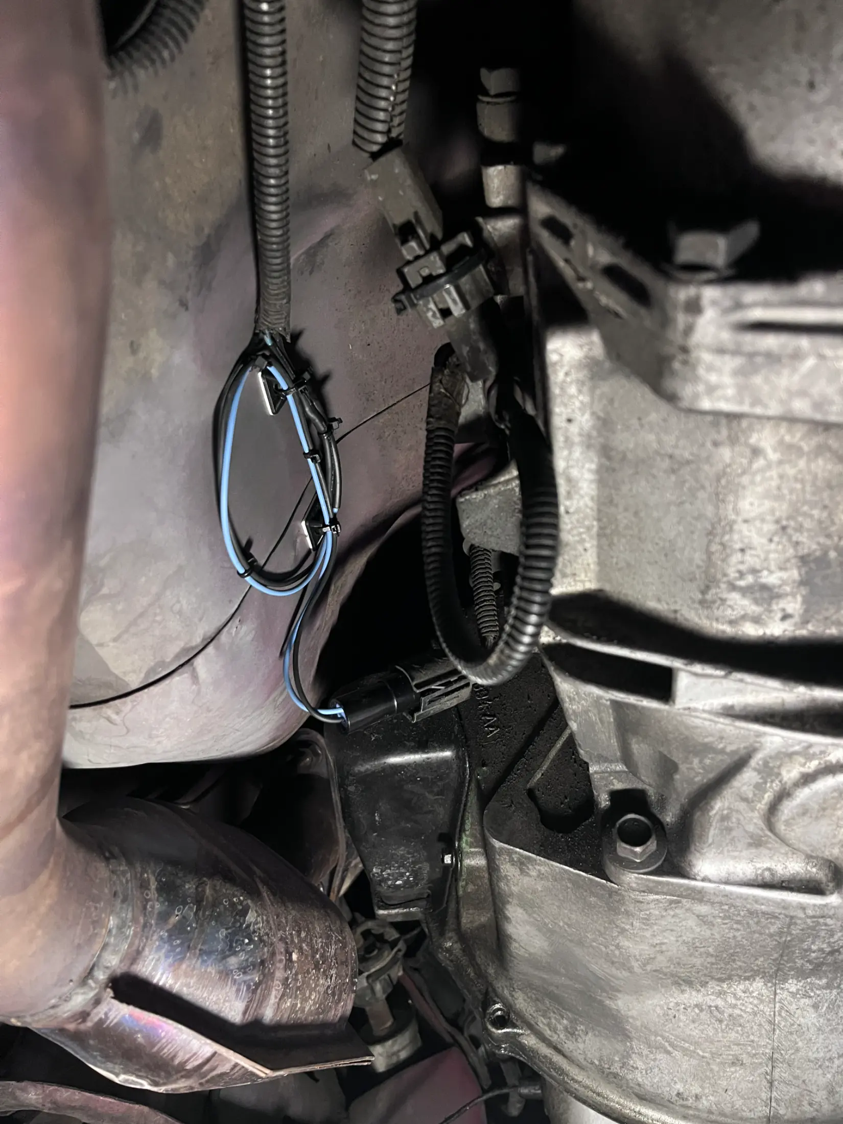

Got the NGS harness side connector spliced in to replace the melted one. Connected it up and held the wiring in place with some tie mounts. May undo it and wrap the ‘exposed’ wires in some kind of wiring wrap and re-secure them. I think I have some wire loom/wrap at work I could ‘borrow’.

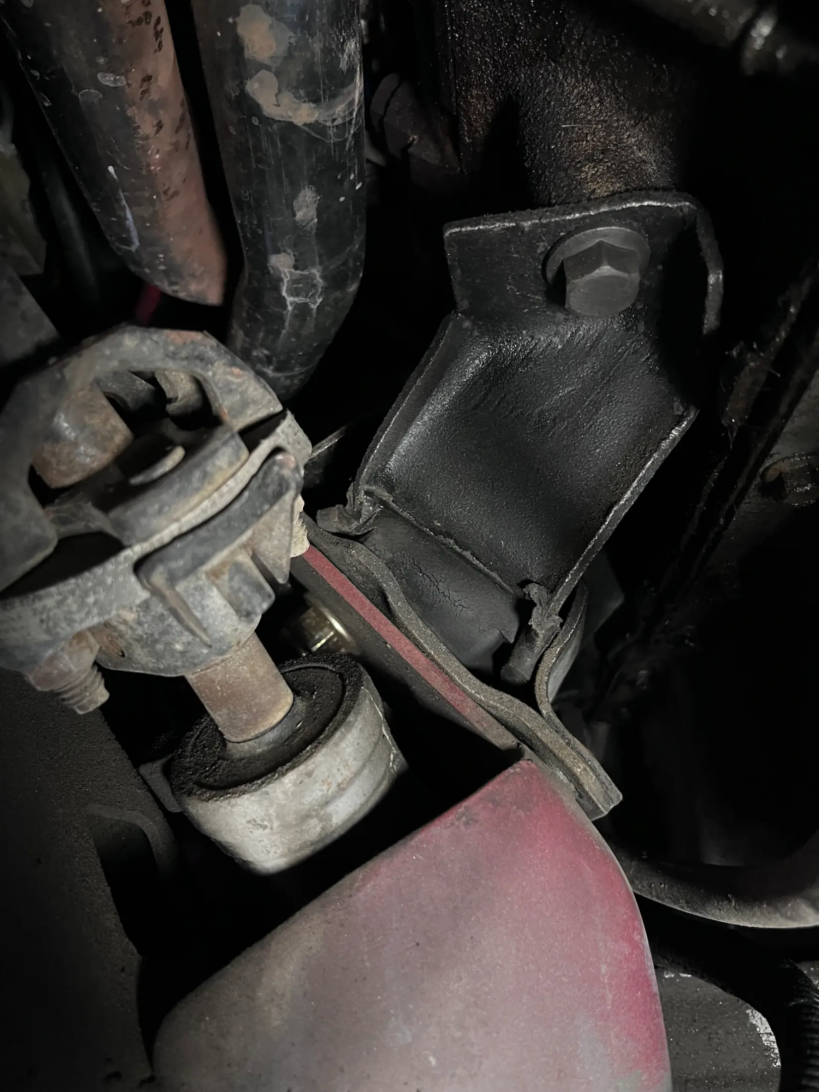

Also, I think my suspicions about needing motor mounts was correct. While under the car was poking around and noticed the current ones look dry rotted and are cracking:
This is just the drivers side mount.
Yes the K member is safe to jack up from and put your stands. Always do the shake test before crawling under. I also remove my wheels and place them under the car for added protection just incase.
Ask the "which mount" question before you order. The way I understand it, the OEM mounts are hard to come by and the replacements are slightly different however, I don't recall all of the particulars.
I know there's folks in there that do.
Well whoops, I already ordered and received the Energy Suspension motor/trans mount kit from RockAuto. If my research is correct these should slightly lower the engine like 1993 convertible mounts do?
Reactions: Scrapla347
Admin Dude
Jan 4, 1985
43,178
21,348
Box behind Walmart
www.stangnet.com
Mar 23, 2025
#613
  • Mar 23, 2025
  • #613
I guess we will see.
What I recall is 'hearing' the same and they ended up being taller.
The other thing that comes to mind about the 'convertible mounts' is that they are captured. I think all the replacement mounts are now that way.
I think it’s the Prothane mounts that tend to raise the engine. Just what I was reading when trying to decide. Any pros/cons to captured versus open?

gkomo said:
Any pros/coms to captured versus open?
Captured is the way to go. Even if the insulator is completely gone, the 2 pieces cannot separate.
I also remember being recommended if you get poly mounts for the engine get rubber for the trans to allow for some shock absorption but it's been 20 years since I replaced mine. I bought all poly mounts then remember someone telling me I should've got a rubber mount for my T-5.

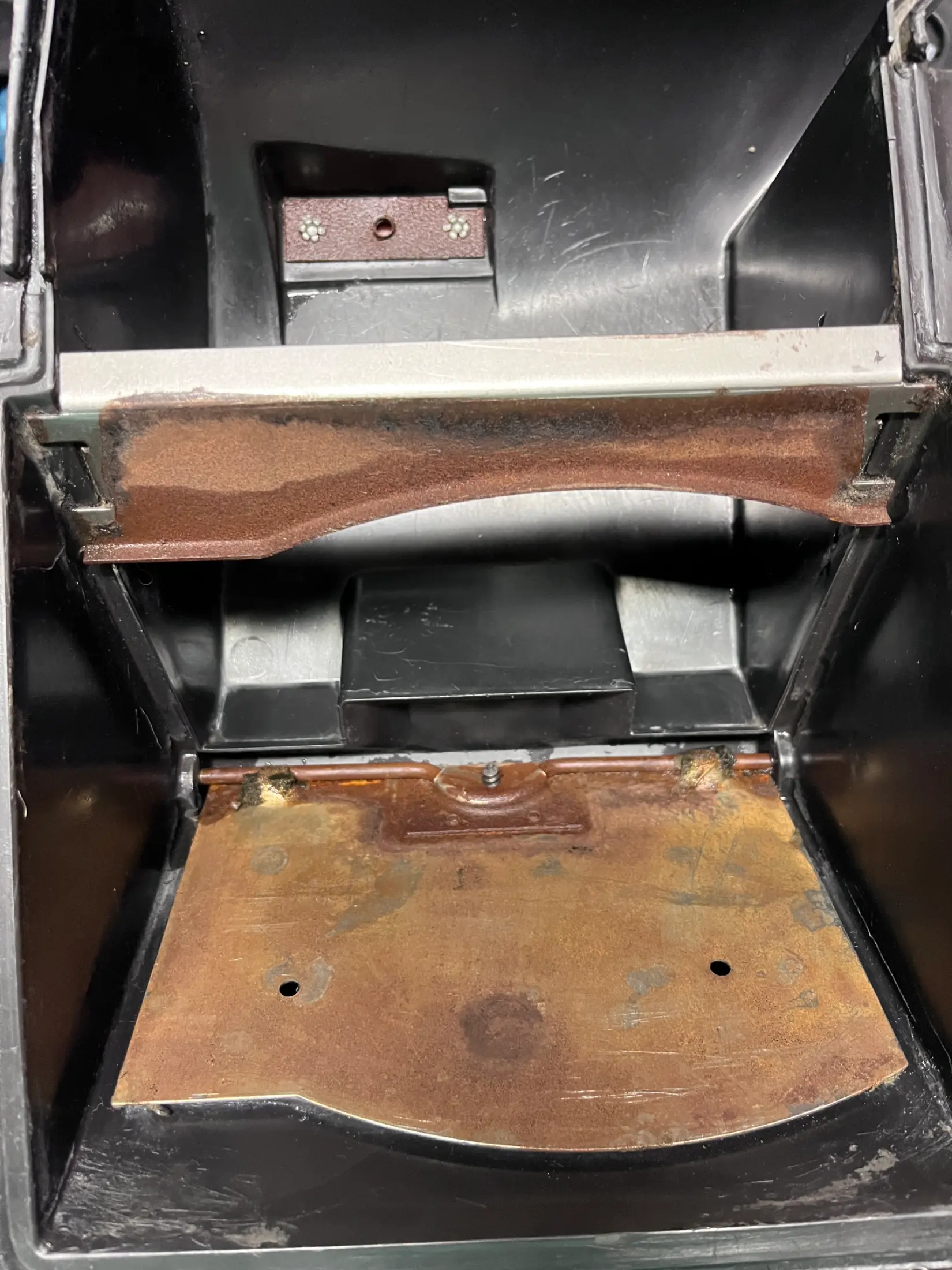

Got the blower motor all cleaned up and back together with new seals:
Old:
Mid cleaning (getting the adhesive off this flap was a pain):
New:
One thing I did not like about the LMR kit was the butyl strips were completely stuck to the package they come in… basically had to just rip chunks off then ‘roll’ them into the right shape and place them in the channel.

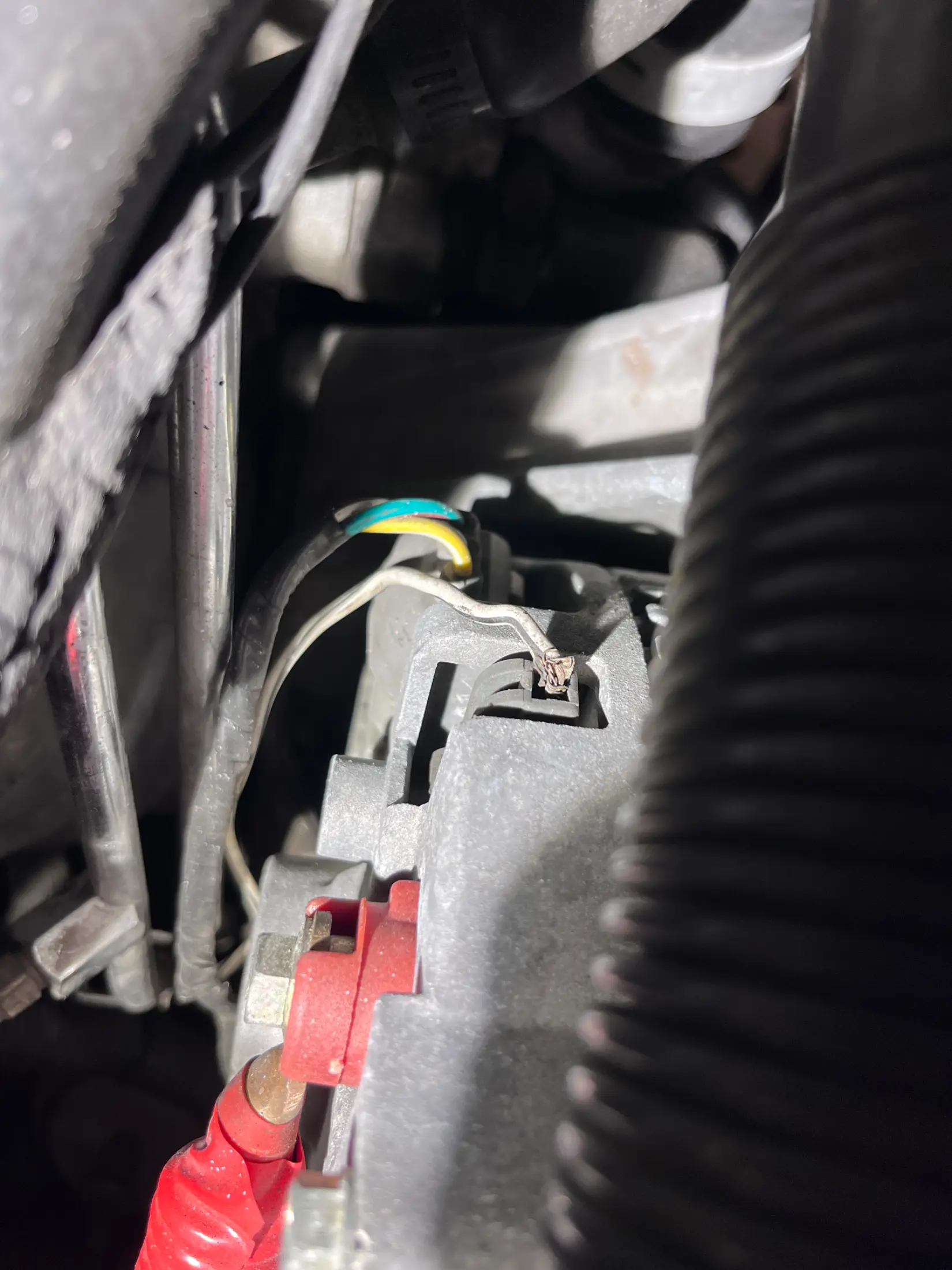

Somewhat productive night, also fixed my stator wire by splicing in the new pigtail connector. This was the shape of the original one:
Old:
New:
I removed my blower to fix a water leak and didn't even think about doing this. Did you just use generic sticky foam?
LMR sells a blower motor seal 'kit' that comes with the flap foam, opening foam seal and some butyl strips for mating the two halves together. I'm sure you could accomplish this cheaper by buying some foam seals and doing it yourself, but i'm always in a hurry so i pay for convenience.
LRS-19555BK
https://lmr.com/item/LRS-19555BK/mustang-hvac-box-seal-kit-83-93
