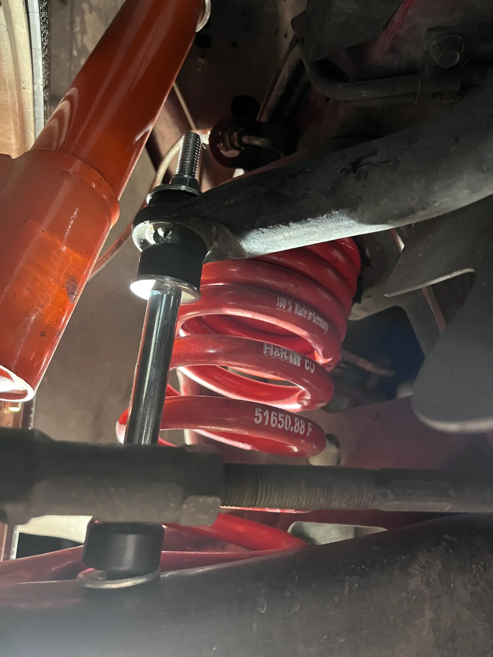

While i was under the car just holding the lower radiator hose cracked open letting it slowly drain, i was just looking around at everything. I noticed my passenger side end-link was just flopping around, i could physically move it up/down like 1/4" and the bushing wasn't even in the 'pocket' of the sway bar. I tried tightening it but realized i need the car on the ground, not jack stands. Is this a just tighten till tight or is there a torque spec for end links? Drivers side looked fine.
Does 6-12ft lb sound right? Thats what LMR has listed for the torque specs.
Edit: I should note that the end links are new and seem to have poly bushings. The slop isn't from like bad bushings or something, its physically not tight enough.

Typically the bolt only has 1-1/2” of threads so you may need a shorter bolt. Would be weird but just something to check.

Here’s how it’s looking at the moment. I did tighten it a little bit last night but then realized (I think?) the suspension needs to be loaded, which it’s currently not:

Stick a jack under that control arm and raise it up enough the lower bushing on the top contact the sway bar then tighten it down, don't worry about torque just get it tightened up.
That bolt does look a little long but it should work.
Check it a couple times after some miles, still tight, your good.

Will do, I’ll compare bolt length to the drivers side. Hopefully it’s not too long and there are more threads available for the nut to be tightened down onto.

Got the floppy end link off. Measured the bolt at roughly 9”. It’s too long I’ve bottomed out the nut on the threads which is why I couldn’t get it any tighter. It’s also longer than the drivers side end link just based off looking at the exposed threads left on that one.
Anywho, will need to buy a new one, or a set just so they are the same. Do I need the 94/95 end links? I’ve read they are shorter and since I’m lowered (H&R race springs) the shorter ones could be better? Or just get a set of poly fox end links?
Just guesstimating based on how much thread was exposed on top plus the slop of the sleeve, I’m guessing I could take 2” off the length. I saw on rockauto they sell energy suspension end links which measure 6 3/8”… I wonder if that would work or be too short?

What if you ran it through a die and threaded the bolts further down on both sides.
I mean... If I were going to buy parts for it, might as well replace it with MM or something.

Funny enough I was just on MM’s site reading up on end links. They state for cars lowered 1.5” or more to buy their 5 3/8” end links. The race springs are listed as 1-1.75” drop. However, reading more I believe my sway bar arms are ‘pointing up’. I’m going to buy the MM ones for lowered mustangs.
