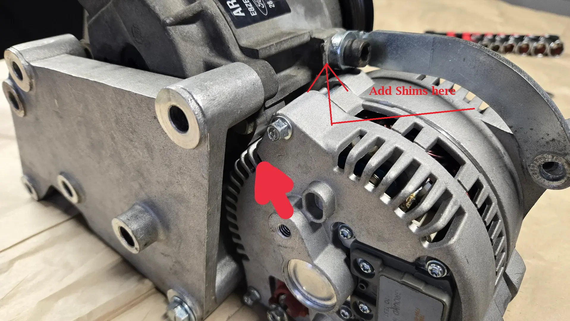

Noobz347 said:
I was looking back at your alternator install images.
It looks like you could shim that 'arm bracket' out another 1/8 inch if you wanted a "smidge" more.
Do you know which post #?
Lemme go look...

From here: https://stangnet.com/mustang-forums/threads/komos-1990-gt.928567/post-9435051

You talking for belt alignment or just overall fitment? Thankfully, if needed, I put the alternator long bolt in ‘backwards’ so I can easily remove the alternator and not the entire bracket. I did have to trim the end of that bolt to get it to clear the drive belt.

I'm talking about if you want just a hair more belt tension. If you put washers under that bracket, it will push the alt pulley [out] and give you another 1/16 - 1/8 inch.
It will push out and down so, you won't get the entire width of the washer(s).
Ah, I see what you’re saying. If this belt stretches anymore that may be the perfect solution.

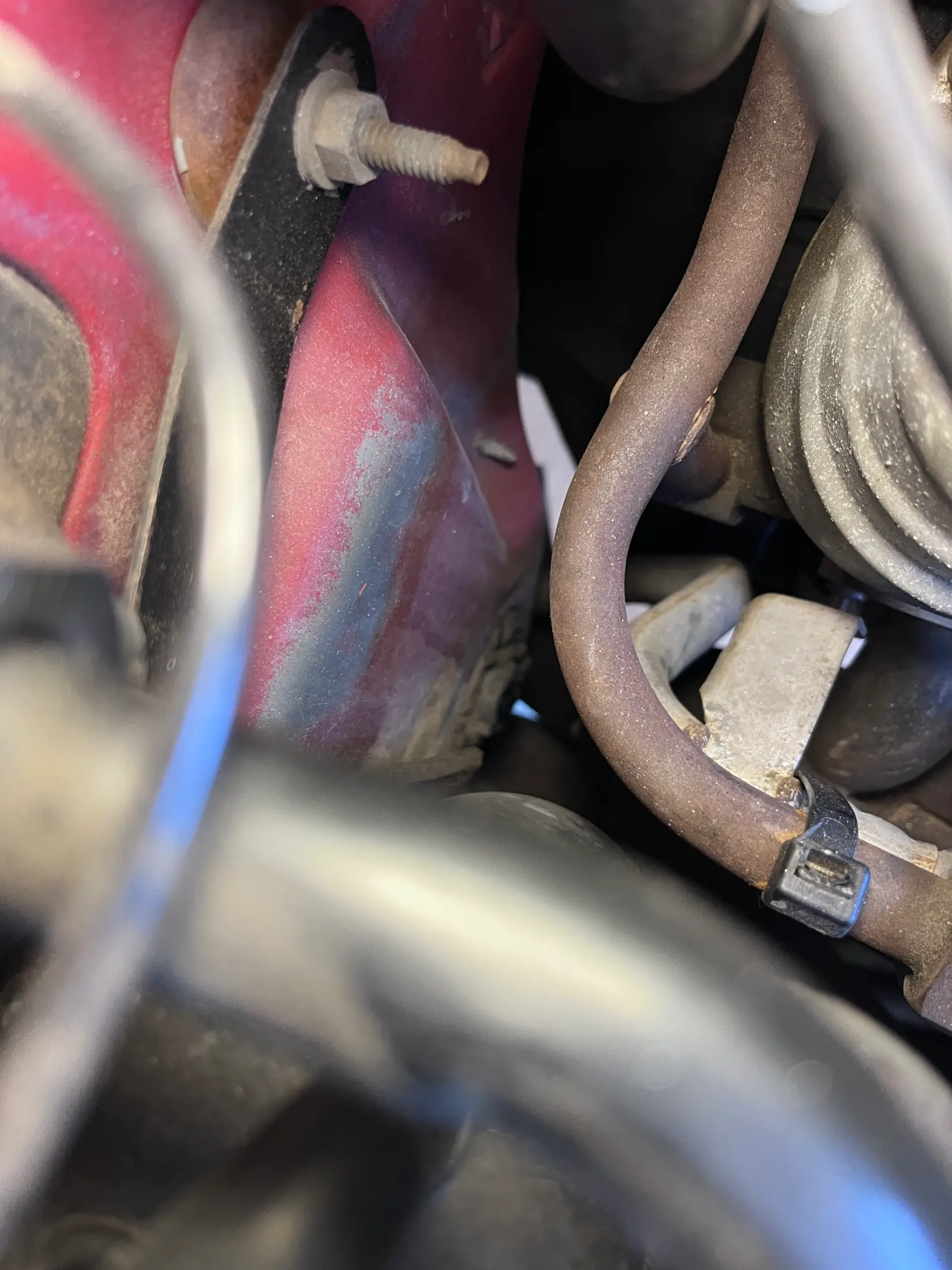

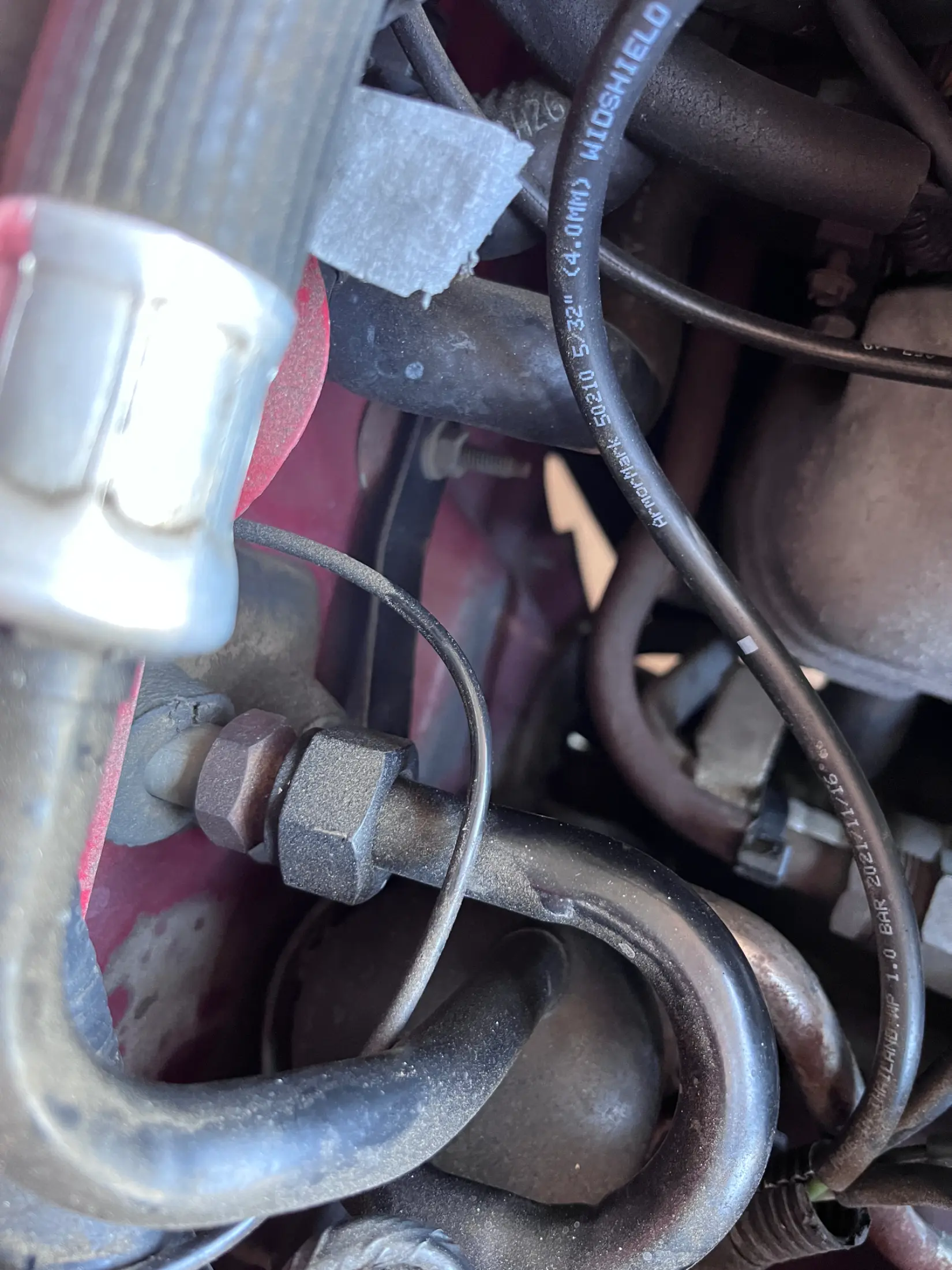

Does anyone know what the port way down there on the firewall is? It’s the hole with nothing coming out of it.

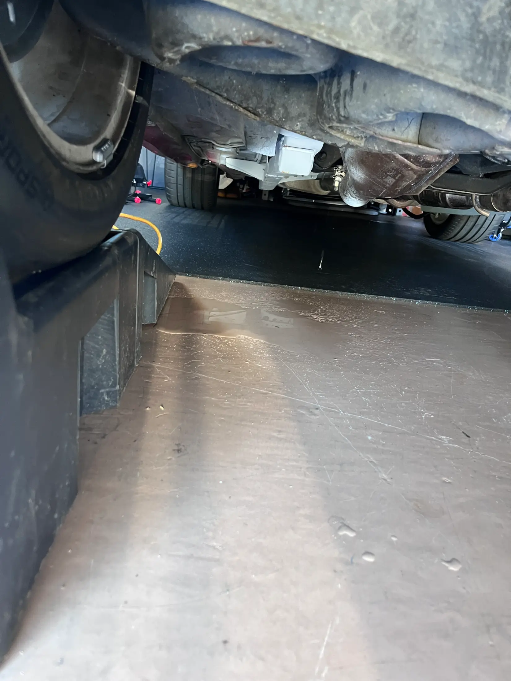

I let the car idle for like 25 minutes trying to burp the cooling system. Had the heat on high but it never seemed to get hot hot… was like just warm. Anyways, near the end I noticed I was leaking like a good amount of clear water. It wasn’t leaking anything for like 22 of the 25 minutes. Mind you I’ve filled up the cooling system with green coolant 50/50 mix. Maybe it’s something to do with the heater core and it’s purging out (unintentionally) the remaining old water/coolant mix? Like it’s clear clear and the old coolant was super dirty so I would’ve expected dirty water/coolant leaking. It was enough to soak up two towels:
So down below that metal pipe, kind of hard to see. It looks like just a hole, but I doubt it supposed to be just a hole? Is there a hose that maybe broke off? I didn’t see a dangling hose anywhere.

I don't see what you're looking in those photos but more than likely, it's the drain for the A/C condenser.
Mine spits water right onto the header (which I'm not amused by).

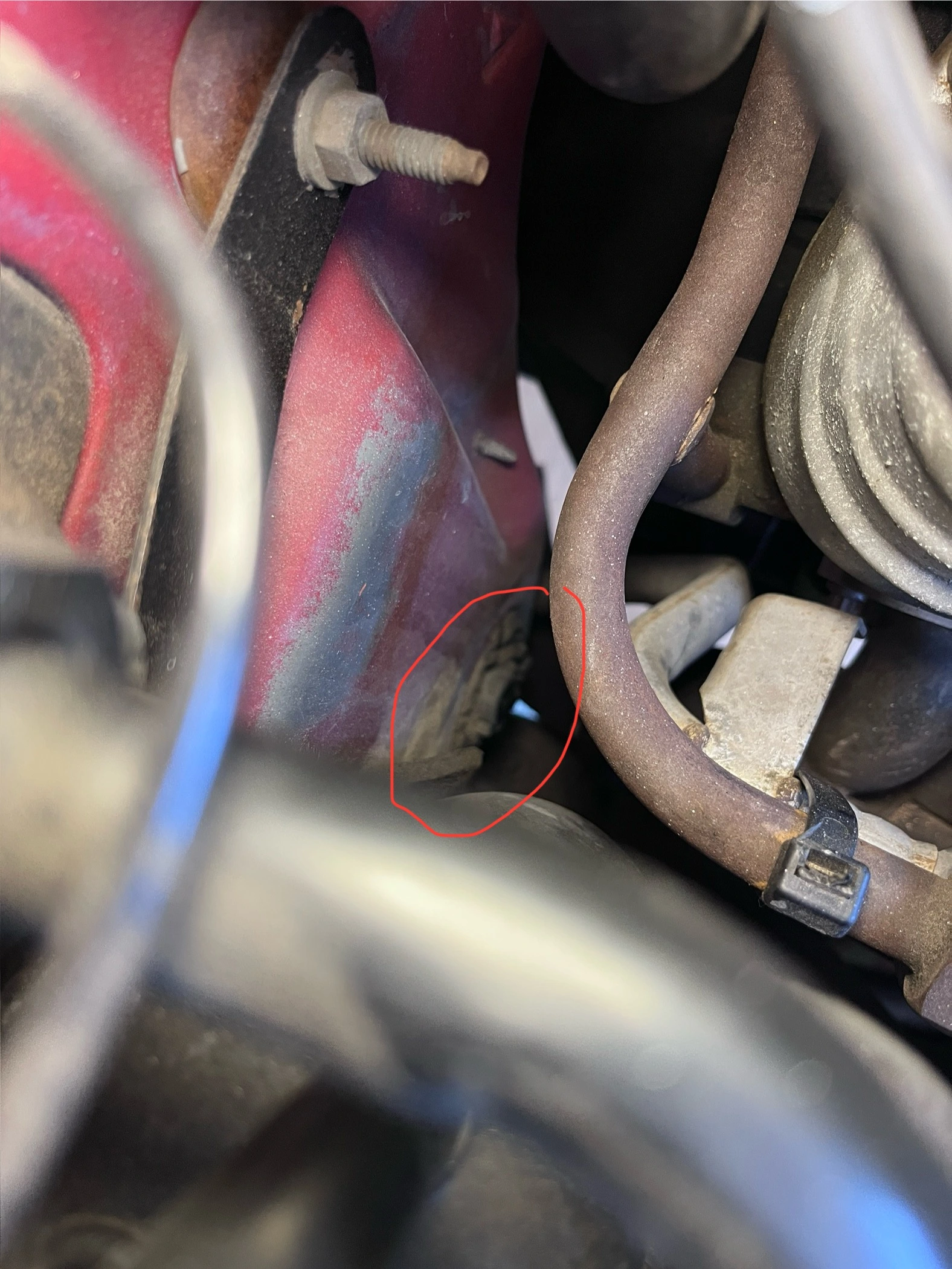

Here I circled it in red. That’s a lot of water/fluid for ac condenser drain right?

Yep... right out onto the header. That looks like the one. lol
