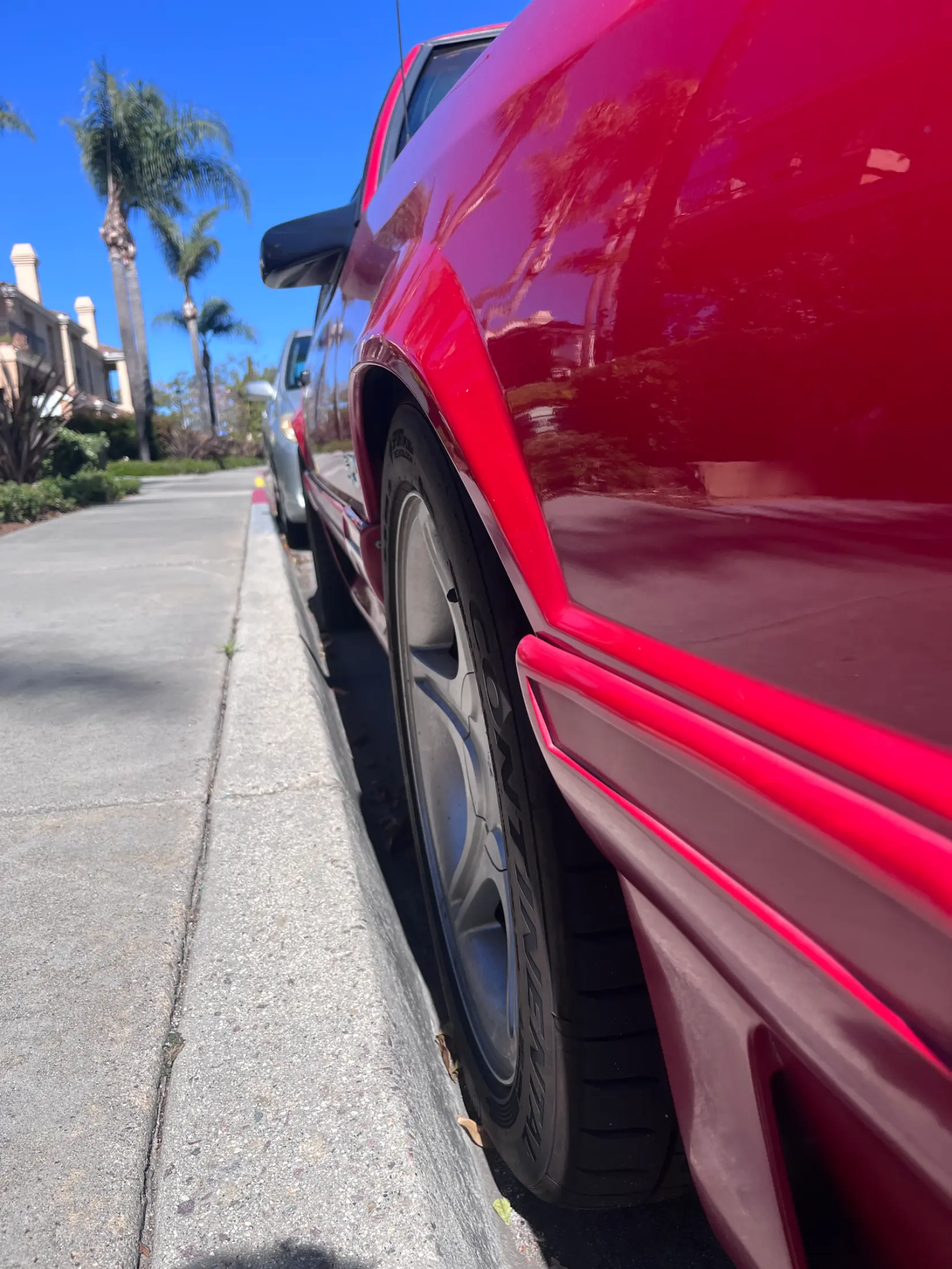

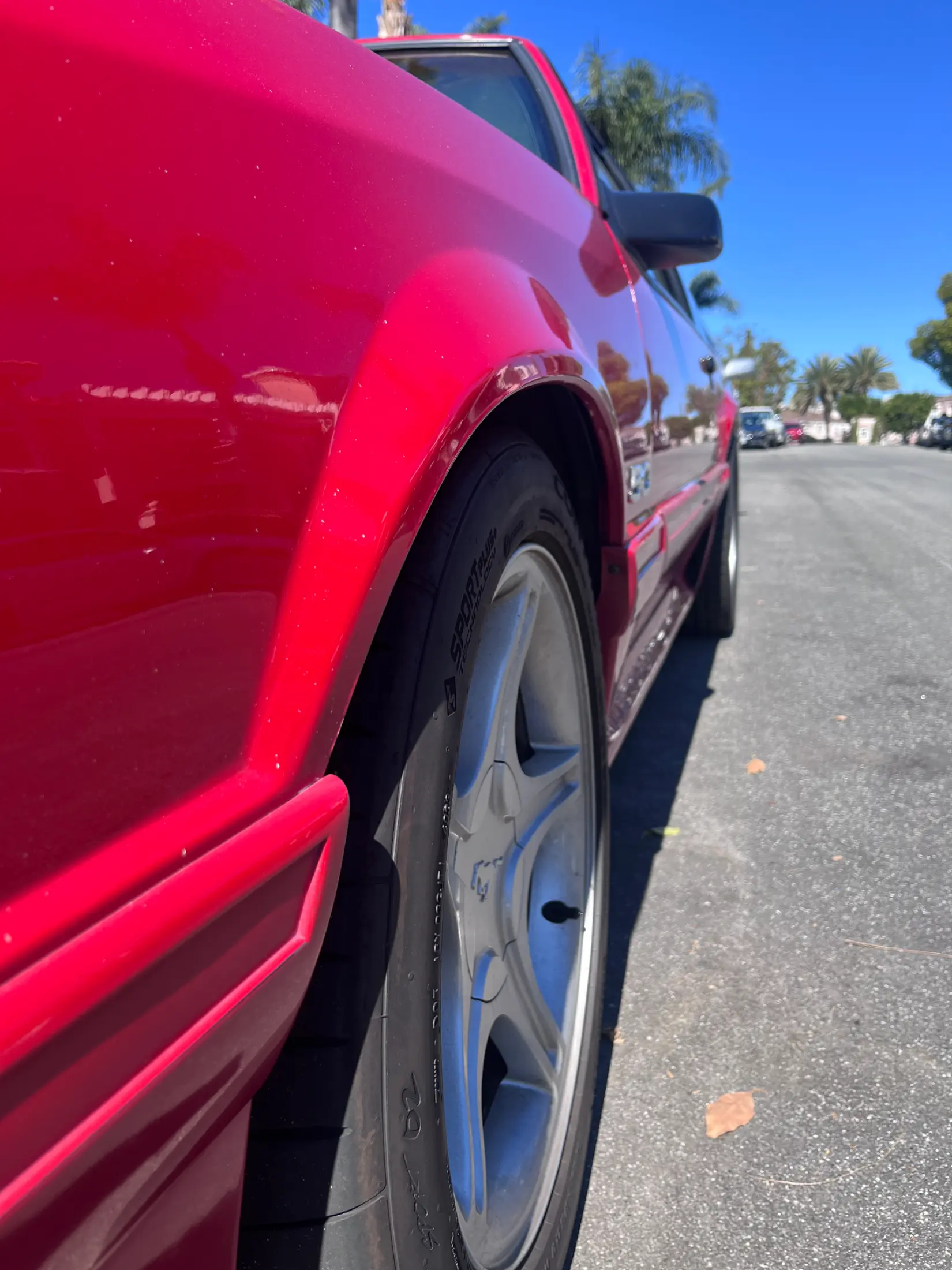

I need to check my wheel to fender distance now, eyeballing it they look tucked in a bit so I’m wondering if I have room to move them outward (if I went with the SN95 version) due to negative camber (MM specs for a street car). I don’t want to have to do flares or cut metal… I don’t mind cutting the ground effects though since I already have.

This is where I’m at now… just seems like there is room to go wider:

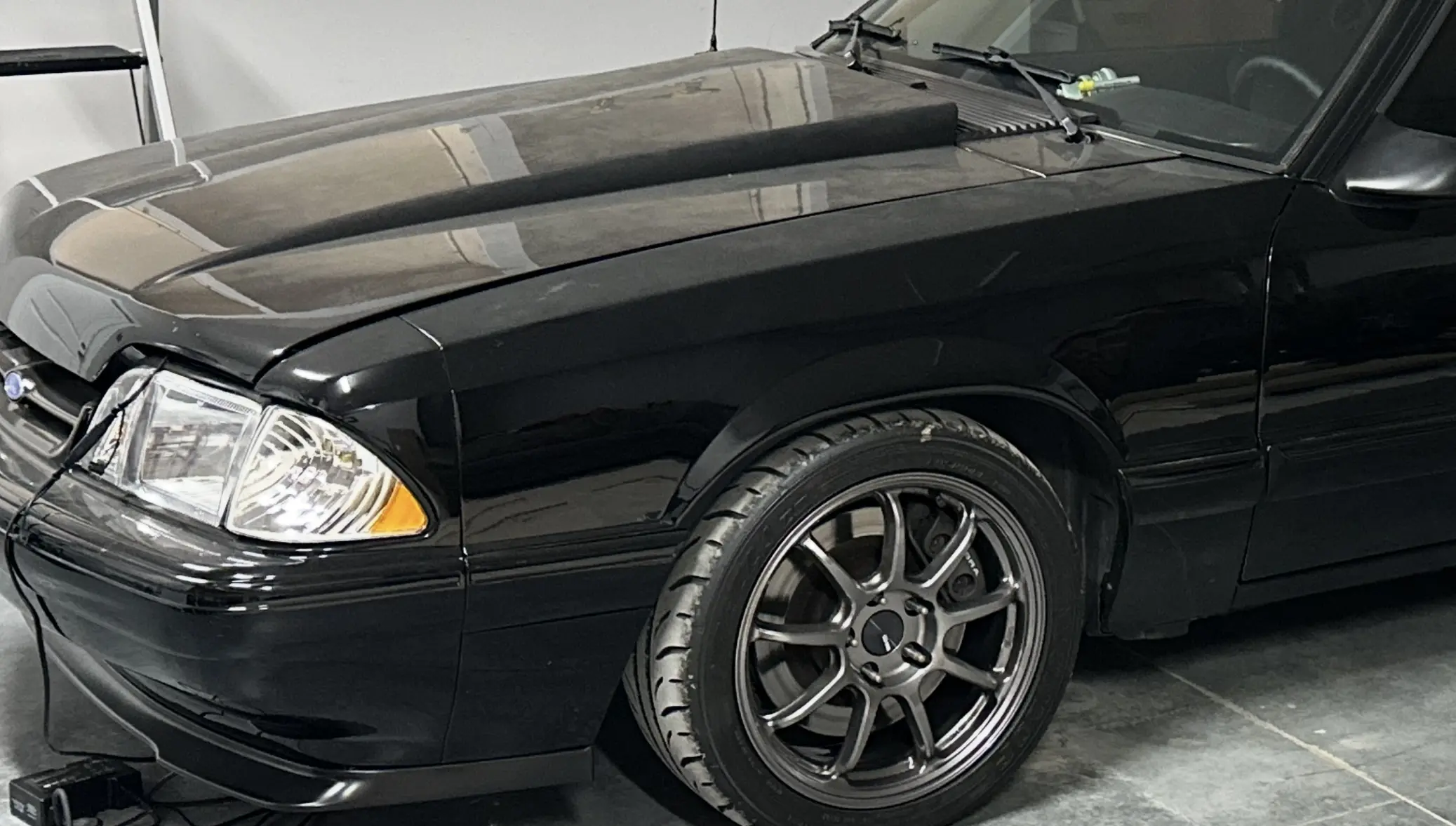

Found a picture of my 93 Coupe so this is with the wheels moved forward 3/4”. Front suspension is as follows: MM k-member, non-offset control arms, 96+ spindles, 17x8 wheels (+35mm offset), 245/40R17’s
90 and down have the smaller wheel openings and from what I recall require some trimming if set up like this. Mine is really close.

Found a picture of my 93 Coupe so this is with the wheels moved forward 3/4”. Front suspension is as follows: MM k-member, non-offset control arms, 96+ spindles, 17x8 wheels, (+35mm offset) 245/40R17’s
90 and down have the smaller wheel openings and from what I recall require som trimming if set up like this. Mine is really close.
3/4" looks way better than the 1½" in the photo gkomo posted the link to. All that extra space towards the rear of the wheel well is uncalled for.
