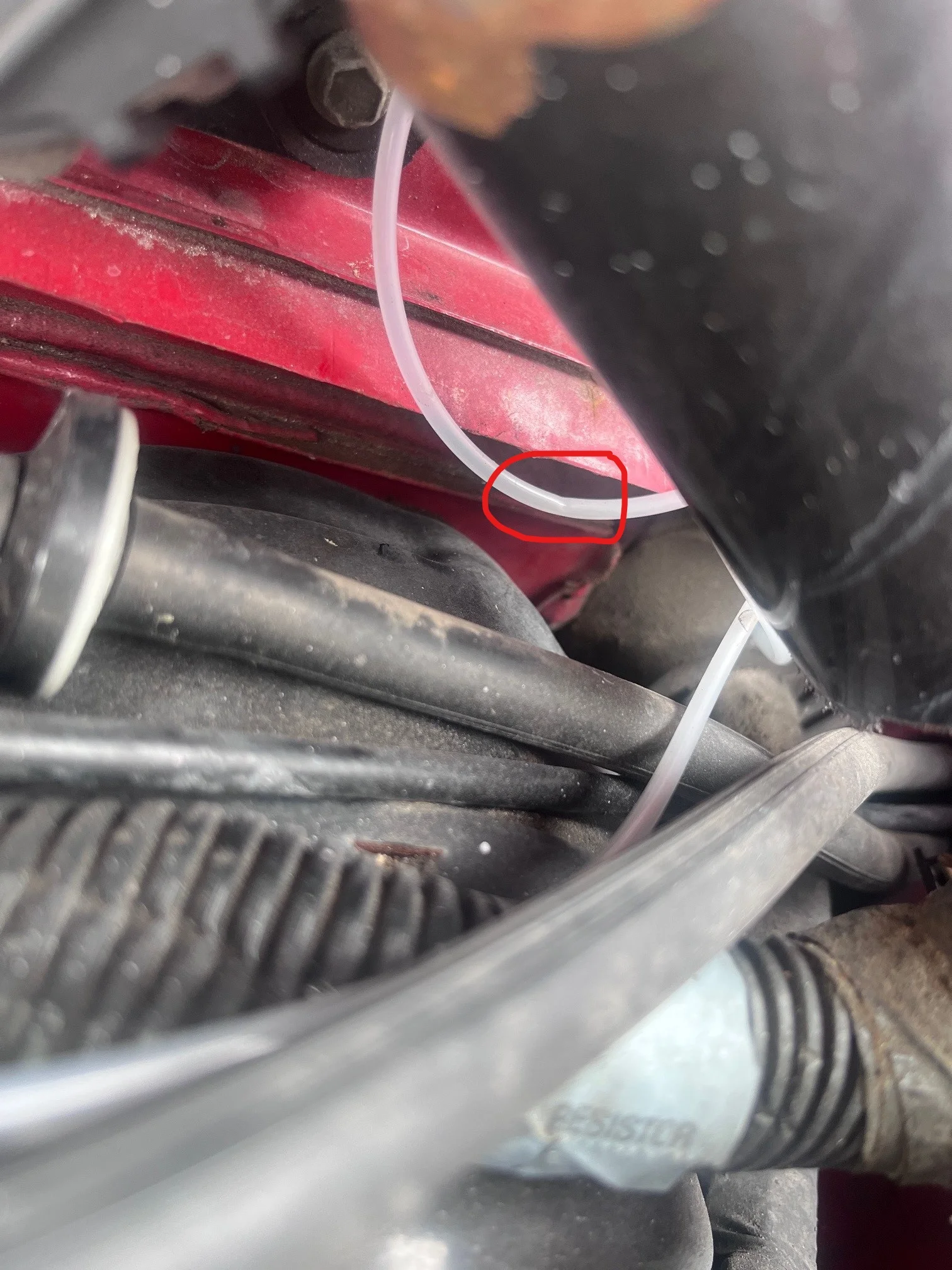

ty engine conditions could be affecting that. Just curious about this line though.Do you have a carburetor fuel pressure gauge? You could swap that and tape the gauge to the windshield to double check.Was just checking my oil today (all full still, all good) and poking around for 45 seconds. Noticed this little 'kink' in my boost vacuum line. Its hardly a kink, but does anyone think this is enough to affect the boost pressure readings on my gauge?

No, so you’re saying just undo the vacuum line from the “t” and run it to a different gauge and see if there is a delta?Do you have a carburetor fuel pressure gauge? You could swap that and tape the gauge to the windshield to double check.
Yes.No, so you’re saying just undo the vacuum line from the “t” and run it to a different gauge and see if there is a delta?
