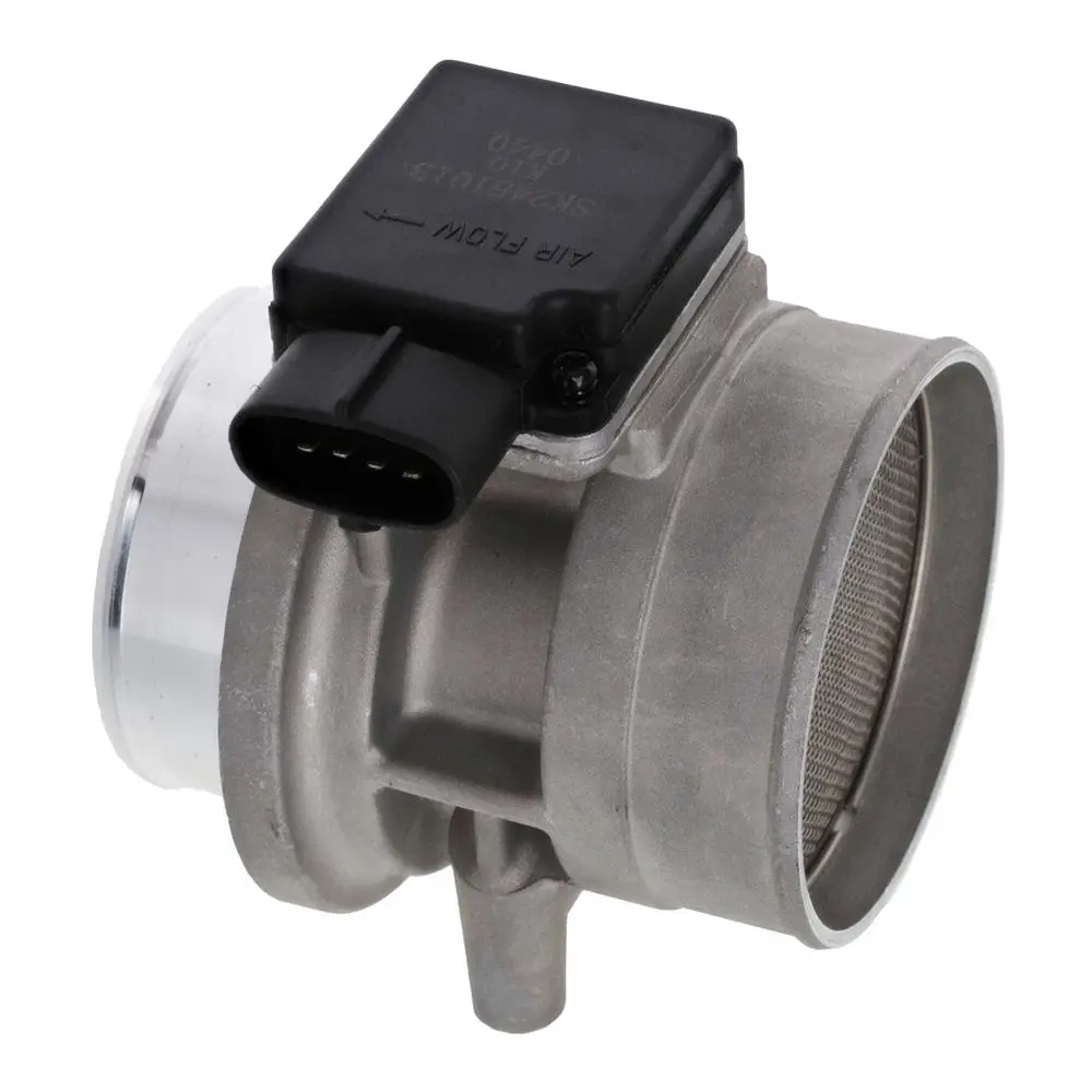

In my quest to stockpile more parts for future things, I bought a Ford 1994/95 GT MAF and housing. From my research this is a direct swap and the transfer functions will work. Can someone sanity check me?
I read (multiple threads on the internet) but also one by jritchker where he listed compatible and directly swappable MAFs into a Fox.

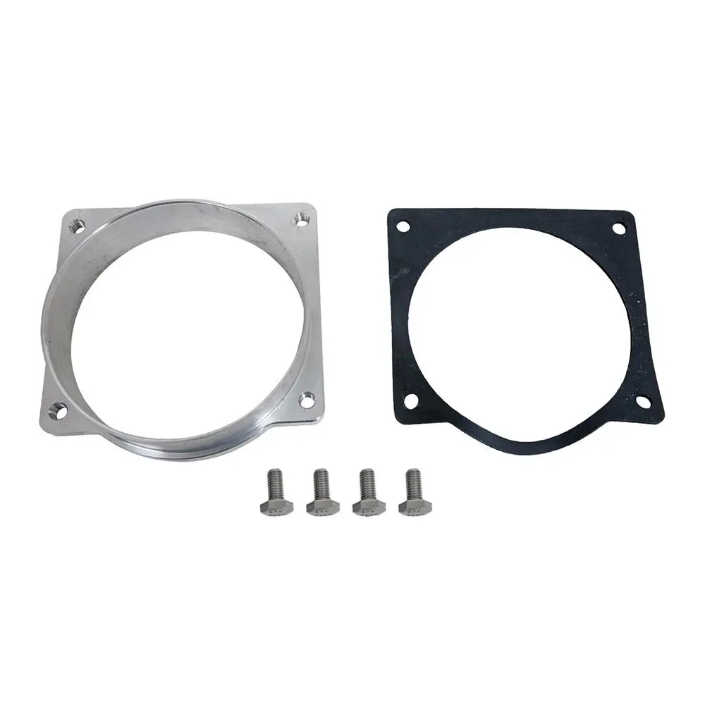

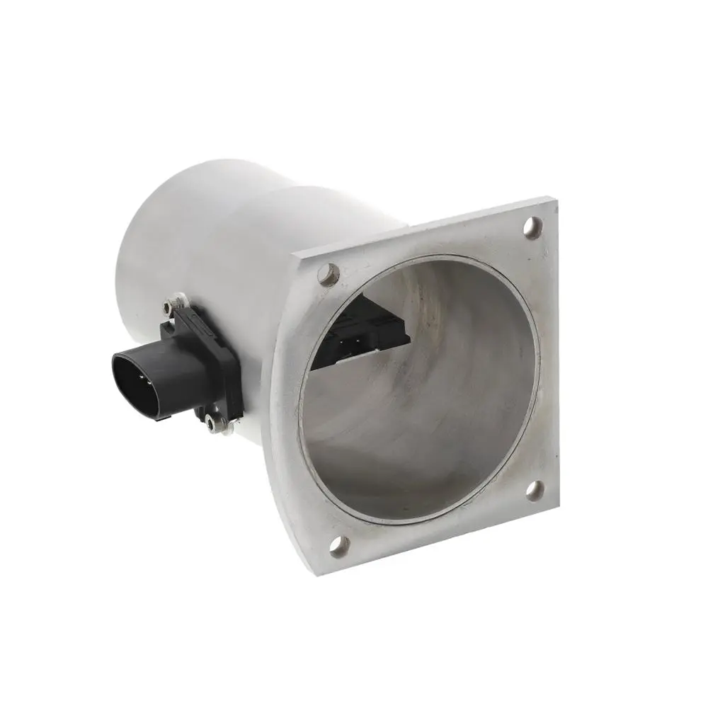

I was planning on cutting off the flange to keep it more 'stock' looking for a Foxbody. Then just running my piping over whats left.
I think that adapter is too big (80-90mm) but i know what you're talking about.
If you modify the housing you will mess with the flow over the sensor.
How much is anybody's guess.
Hmm i'll have to think of something then. Maybe cut the flange off not parallel to the flange but perpendicular to it, like 'outside' of the MAF tube, or something.
Or just try to find a flange adapter. Not gonna happen for a while anyways.
