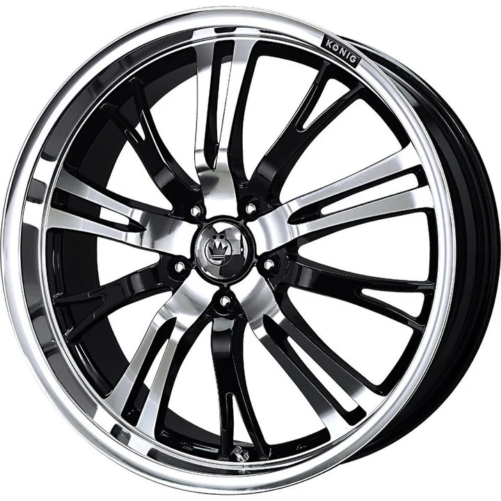

Konig Unknown Wheels
:SNSign:
bleedingvayneAD said:
I have a screaming yellow GT and am going to get 12" black stripes painted on and was thinking about getting these wheels... but their offset is 40mm, so would that fit our cars and stock tires?
