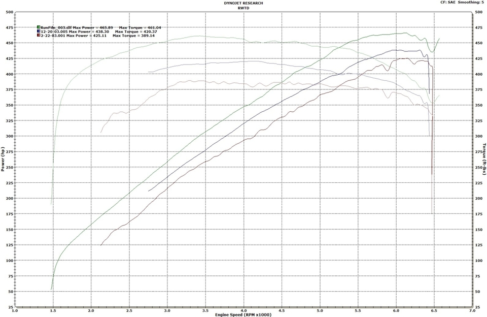

I actually saw great gains with my JBA shortys.
U.M.
Run #1 was CAI / catted X-pipe / Cat-back
Run #2 shows my gains after installing the JBA shortys. 13 RWHP & 31 RWTQ. *Note* I had the car re-tuned to take full advantage of the headers at the time of this pull.
Run #3 is the addition of a 2.93 pulley and a C&L intake tube.
