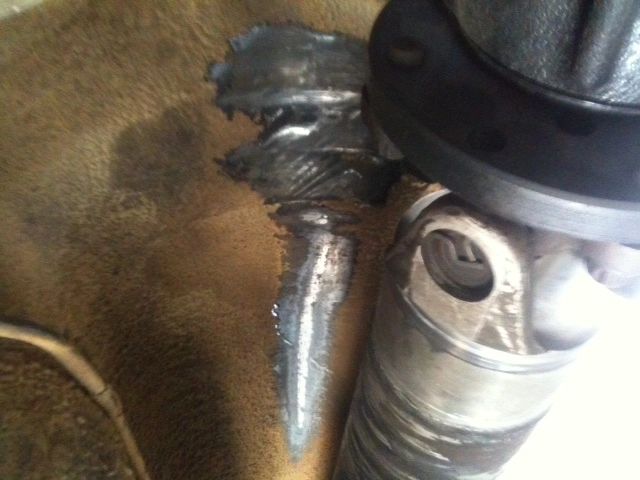

well I was looking over my car before I headed over to irwindale and noticed that I have a lot of dent marks where my drive shaft meets the rear end. I checked to make sure all the Ubolts and driveshaft bolts were tight. Everything checked ok. I have noticed that in the past few days my upper end power is a lot stronger but my low end felt a little sluggish and I kept hearing a banging/grinding noise from the rear. This was after taking everyones advice and changing the timing and fueling a tad. So ive came to the conclusion that I fixed the lack of power but now im going to need a set of traction bars hahahaha. But ya im getting quite a bit of wheel hop and loss of traction, the rear reaaaally has to be twisting hard to bring the snout of the rear end that high into the tunnel wall. You guys think I should run it tonight or will I snap something hahaha? and also is there really a big difference between some cheaper slapper bars and caltracs? I know im going to need new springs and traction bars soon but I don't really feel like dropping 340$ on caltracs, thanks for the help guys!!
So I got back and my best time was 8.4 @ 81.38 I only got 2 runs and this was my first time on the strip ever, the 60 ft was 1.889 so I didn't to bad with stock suspension and a ton of wheel hop but the only issue was on the 3rd run I blew the tranny... 3rd gear is gon, I was planning on rebuilding it soon enough but does anyone know a good performance rebuild kit that will last 500+ hp?
