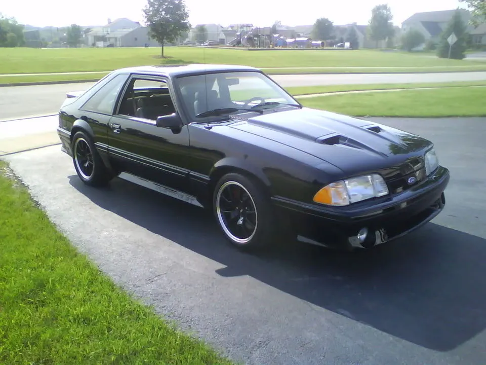

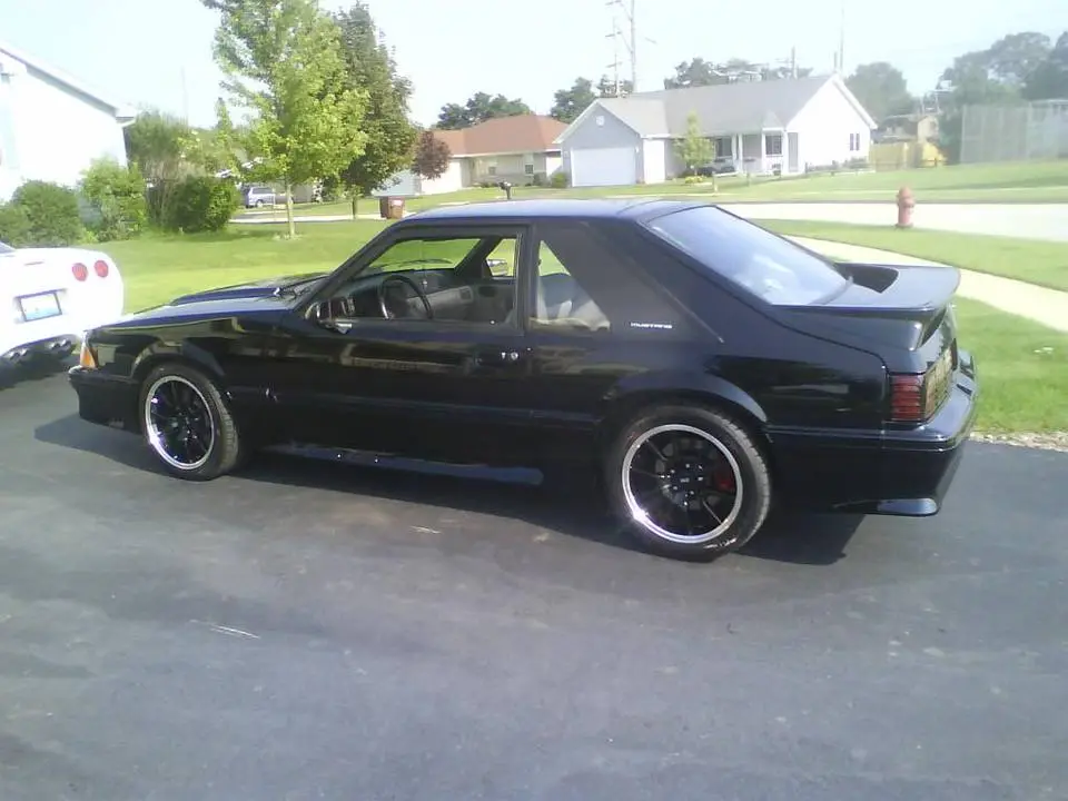

Here are some pic's.

Thanks for the pics Hawaiian5.0GT! Very helpful. Your car sits really nice!
