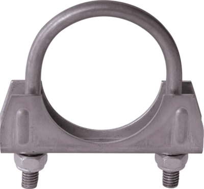

Just something to ponder. Anyway, your idea sounds fine and should be no issue. Band clamps are fine, just don't use these:

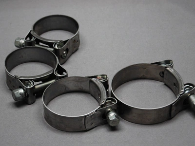

Something like a t-bolt clamp is good:

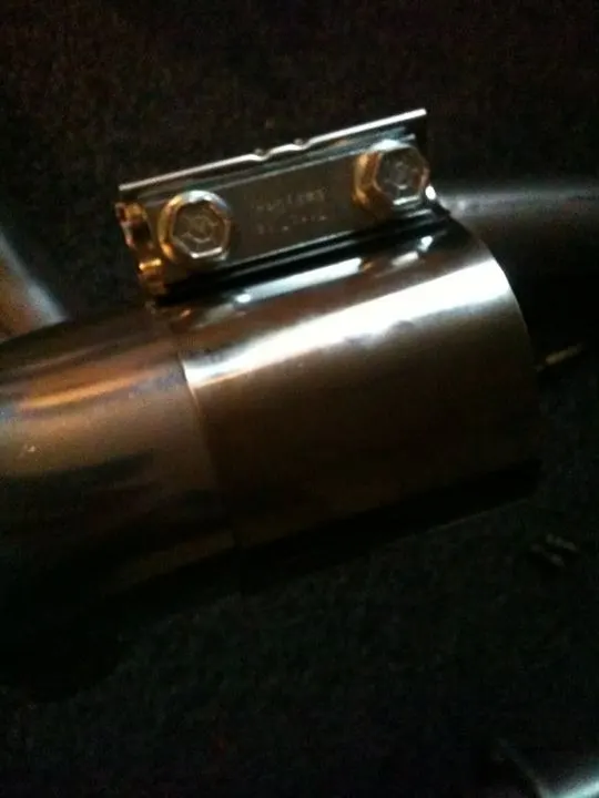

I dont think anyone here really cares they are not that anal about it. They only care that it has a working exhaust system with no holes or that is is not falling apart and that it has cats and mufflers. I am using these for clamps.
