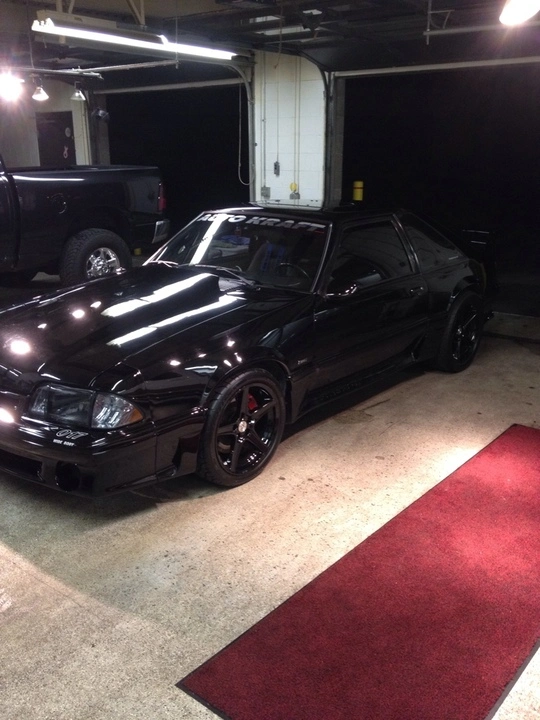

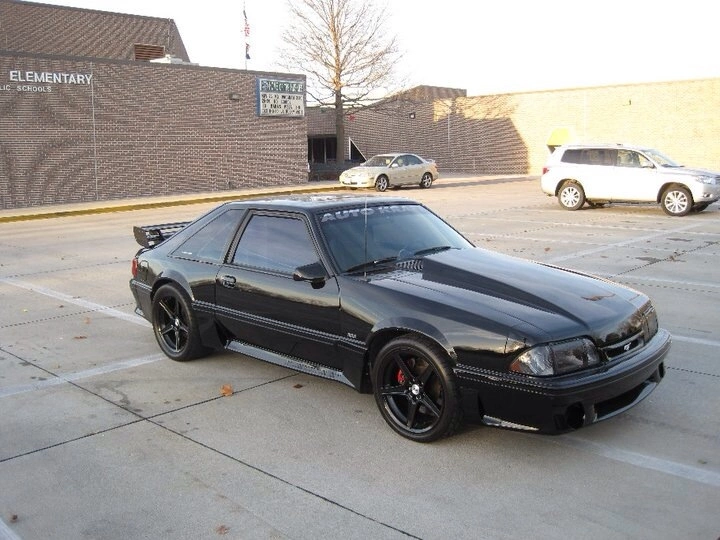

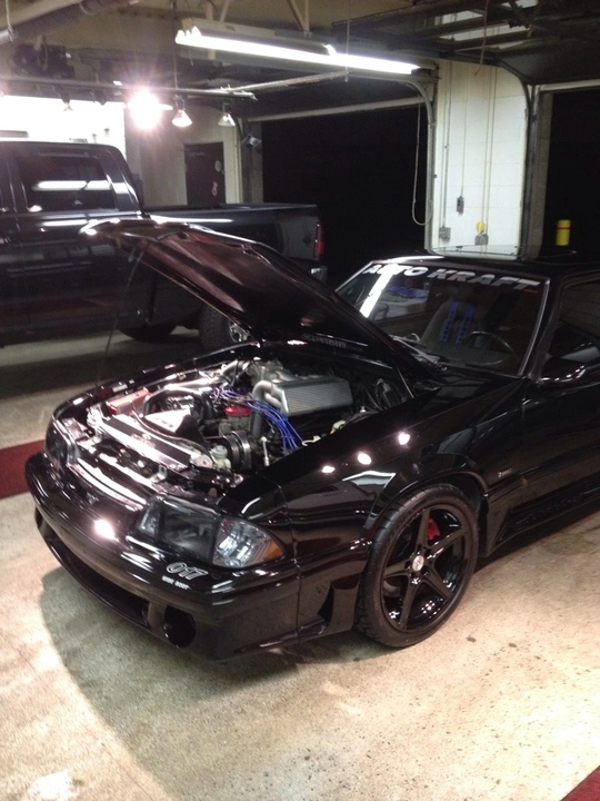

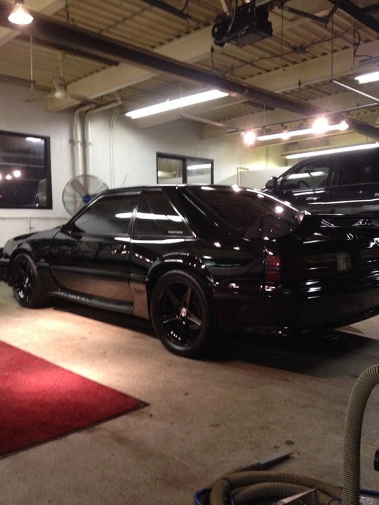

Going to the body shop soon for a cobra rear bumper and cobra spoiler
so I washed it up and put a few miles on it even though it's still winter,
and colder than s**t!

I was going to talk crap about the wing lol but I realized you're changing it.
That black is beautiful.

Yep, it's going bye bye...been on the car since 1996
Time for a change

As stated in corral, its gonna rock with a cobra wing/bumper treatment

Hey, your car is gonna be the darker, evil version of mine when you swap rear ends! Nice!

So, am I retarded, or are your fenders/quarters wider than stock?

That's what I thought at first, too. But I think it's a combination of the angle and the GT side skirts that make it appear that way

I think they are widened... Look at the reflection on the front fender .. It sweeps out. And the gt kit doesn't line up to the body well right behind the front tire.. Gotta be pushed out... Regardless , it looks very bada$$

Those are definately widened...Just lose the saleens and go with some CCW classics and you'll be right on the money.

The factory fenders and quarters are widened 1.25"

absolutely beautiful car, however i don't like the clear corners with the smoked headlights. that's only my opinion however

They look clear don't they? They are not however.. they are uniform when looking directly at them

The car was widened back in the mid 90's at Autokraft Paint & Body in Lincoln, NE.
I do not have pics of my car being done but I'll post a link to their website where you can see Doug building his
Smurf blue GT with the chopped top and widened fenders and quarters. Doug uses the factory Ford fenders and does his thing
The hatch has to be widened right around the bottom of the back window to match the width of the quarters otherwise
there would be some big gaps...
Then he mends the front valence, side-skirts, and rear valence to the widened fenders and quarters
We repainted the whole car. Technically you do not have to repaint your hood or doors..... but nose, skirts, rear bumper
roof/rear quarters, hatch, front fenders all have to be repainted

I think the widebody looks great. It's very subtle. Is the body shop going to heat up and contour the cobra bumper to work with the widened rear quarters?

They are, a friend of mine just had his quarters widened an inch and he used a cobra bumper. Doug had no problems making that bumper fit nicely...mine is .25" wider, but he sees no problems with that either....and yes his blue stang was taken a bit too far...kinda his rolling business card back in the day tho
