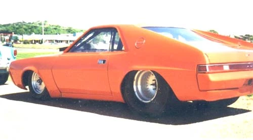

I tried running a pro-street car I built a few years back when it hooks up its like having a better clutch that doesn't slip.This car scared the living bejesus out of me,sold it :D
