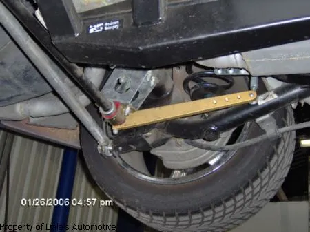

I got their whole rear box. I love it. If you can swing it, get the panhard rod, sway bar, and lower arms. Leave the stock uppers until you can afford a torque arm. I had the BBK specific rate springs on my car for a while. The ride sucked ass.
