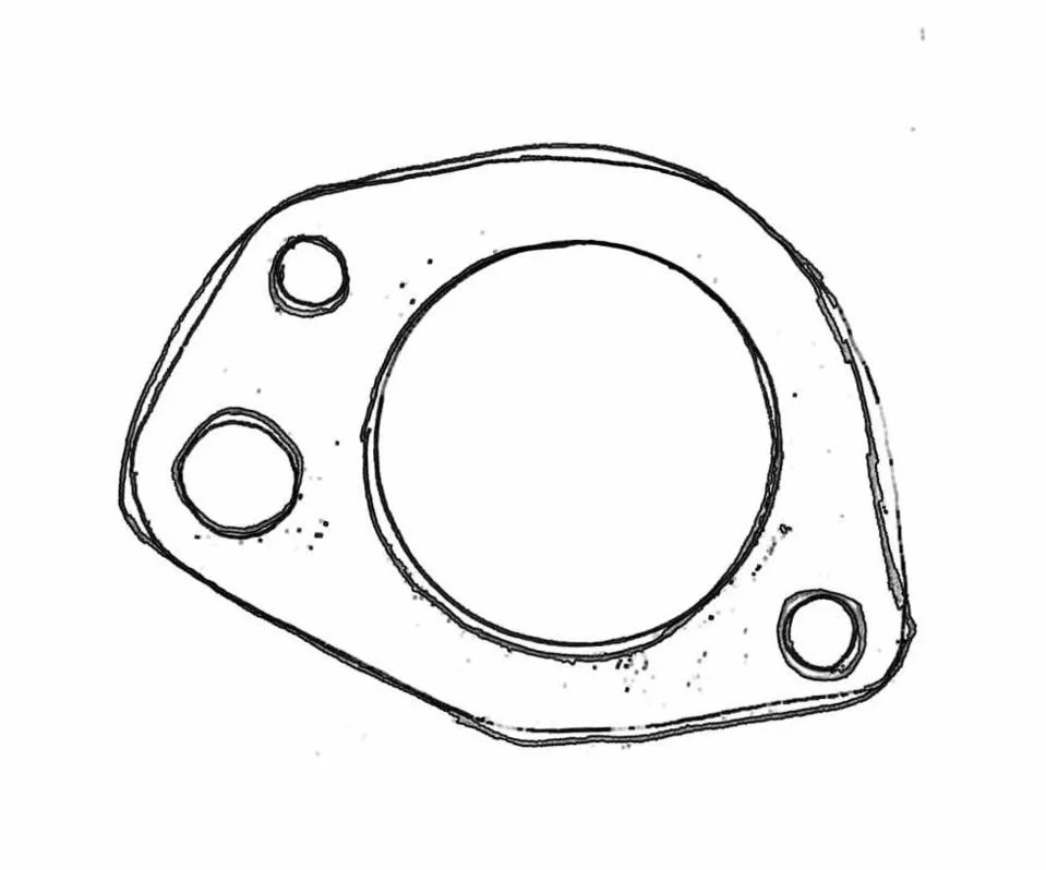

It was not the fact that I had an aftermarket intake manifold (Edelbrock Performer 289). See attached pic from tracing the mounting surfaces and superimposing - really no difference. Some argue that Edelbrock did not cast a good replica of stock, but this doesn't seem to be the case.

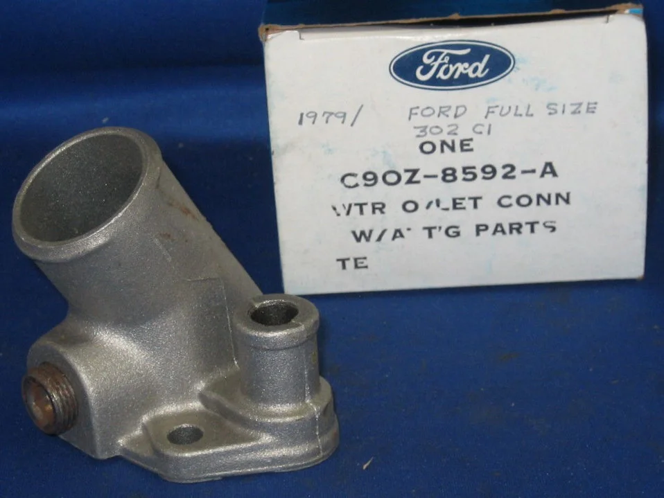

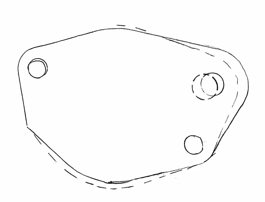

I got my hands on a FoMoCo C9OZ-8592-A housing (ported also). Note that there are a ton of others that are practically the same from C3OZ-8592-X to C8OZ-8592-X, except the older ones appear to be cast iron and later ones are cast aluminum. I traced the configuration of the thermostat opening, the mounting holes, and the bypass hose opening. The aftermarket units have bypass hose openings about 5/32 outboard of the FoMoCo unit. The mating surface on the intake manifold tracks with the dashed line so the aftermarket housing has that much less contact area to seal against cooling system pressure. See attached pic (the dashed line is FoMoCo) .
So lesson with these is find NOS instead of aftermarket for this application. Configurations ARE different!
Adding a couple pics of a FoMoCo housing and the common aftermarket housing...
