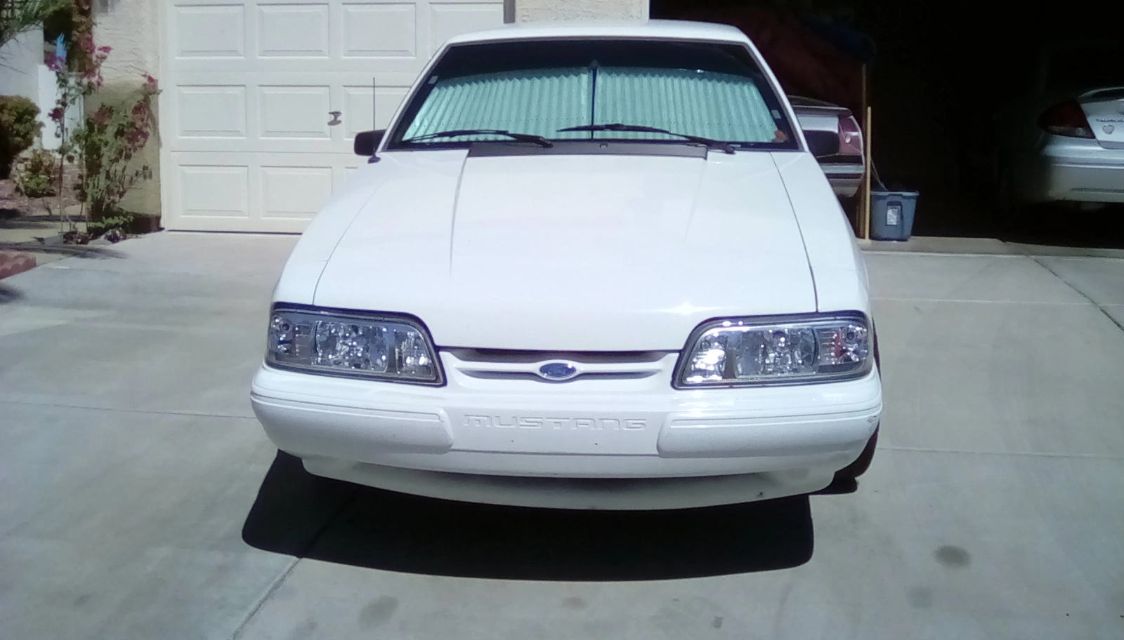

I got h.i.d. Headlights for about six years now. Got them on Amazon after reading a couple of the more then 5,000 reviews.
Back then they were $60 for the kit,all plug n play. I think they are kensun brand .

Are those HID lenses? I’ve heard the light goes all over the place if you put in hid bulbs and don’t have hid lenses. Makes people think your brights are on.
