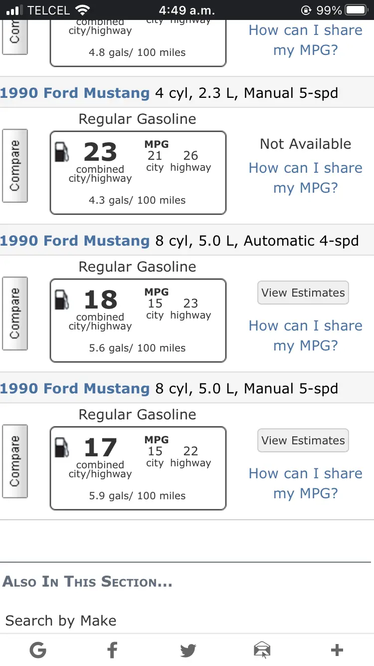

Si let me get this straight, some of you are replying with some very impressive numbers, FoMoCo published some numbers on MPG City/HWY/ and Combined. So with some mods can we get better MPG than the numbers published by Ford?
My carbureted 1989 gt convertible with an E303 camshaft and 3.73 gears got a verified 26mpg on the highway cruising at 72 mph. It got better mileage than almost anything we've owned. So, I'd say, with modifications, you can beat the factory fuel ratings published for our mustangs.
