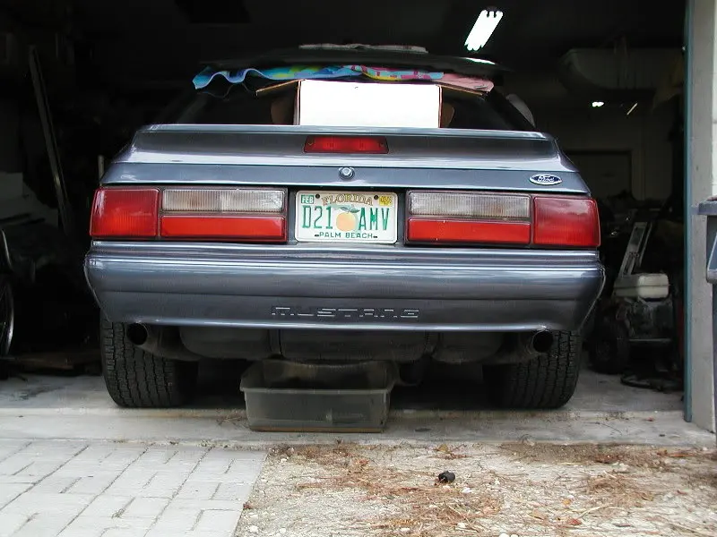

I have a 15x8 weld with a 295/50/15 BF goody radial. Rubs a bit around turns but my car isn't lowered and I have 5.5" backspacing. A 275 will fitthe rim fine but without the right backspacing u may have a problem with it rubbing the outer fender. Heres mine

exactly. I know the 275/50 will fit the 8" but will it fit on the car with the 4.5bs? I don't want to buy another set of wheels cuz they don't exactly come cheap to us in the great white north. however if anybody knows or has the widest tire with a 4.5bs on a 15x8 draglite please let me know.
