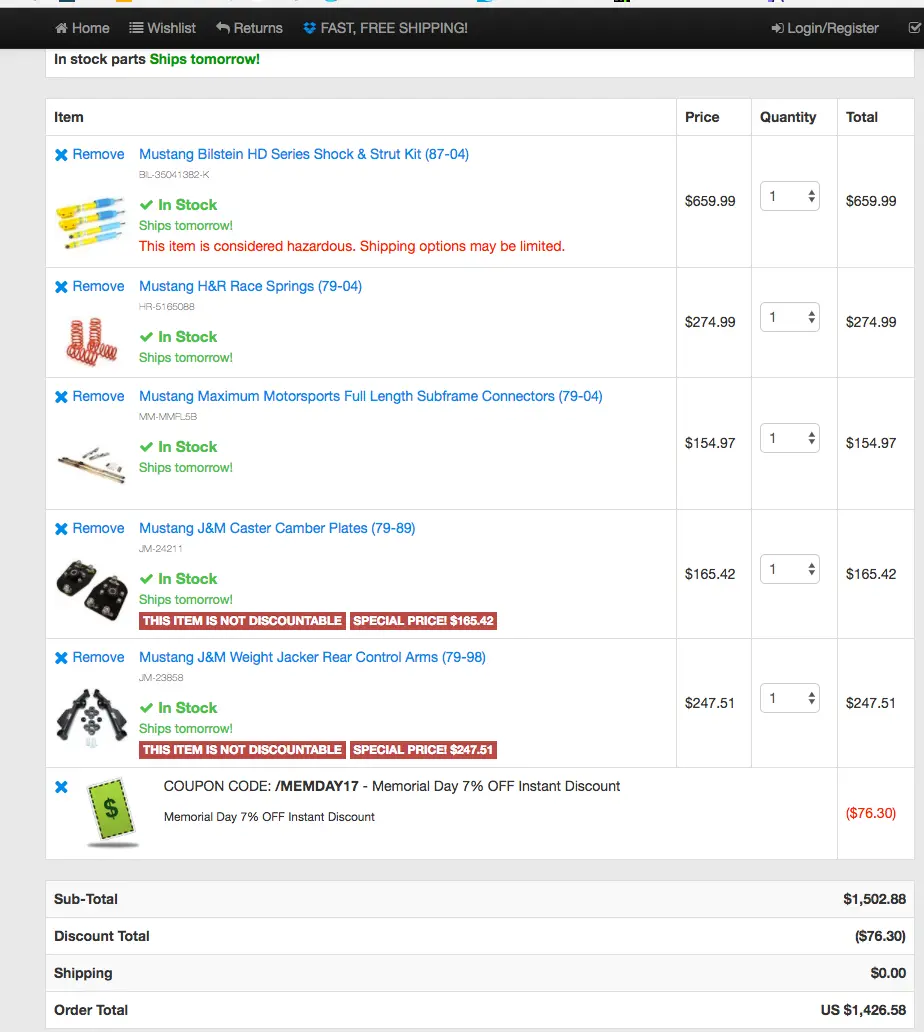

I agree but I have had many other shocks/struts over the years and IMHO the HR race springs and Bilsteins combo is hard to beat without going to full on coil-overs, which in this instance I am not interested in.

  • Mustang Bilstein HD Series Shock & Strut Kit (87-04)
  • Mustang SVE Bump Steer Kit - Power Rack (79-93)
  • Mustang J&M Caster Camber Plates (79-89)
  • Mustang J&M Weight Jacker Rear Control Arms (79-98)
  • Mustang Maximum Motorsports Full Length Subframe Connectors (79-04)
  • Mustang H&R Race Springs (79-04)
