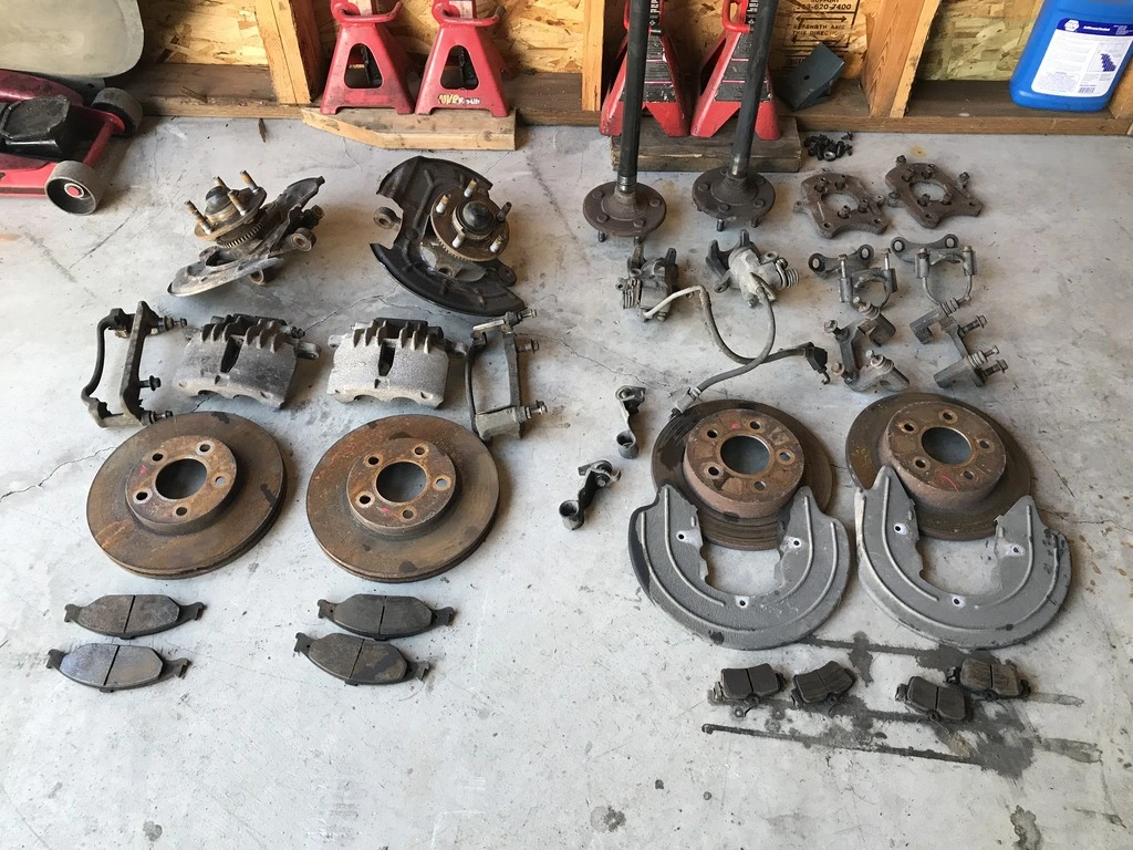

so going through and cleaning up the junkyard brake parts I discovered some damage.
1. rear caliper bracket has what seems to be a fused caliper pin, now complete with a busted ass bolt in it :)
2. calipers all have damaged seals and need some rebuilding some have scored/pitted pistons

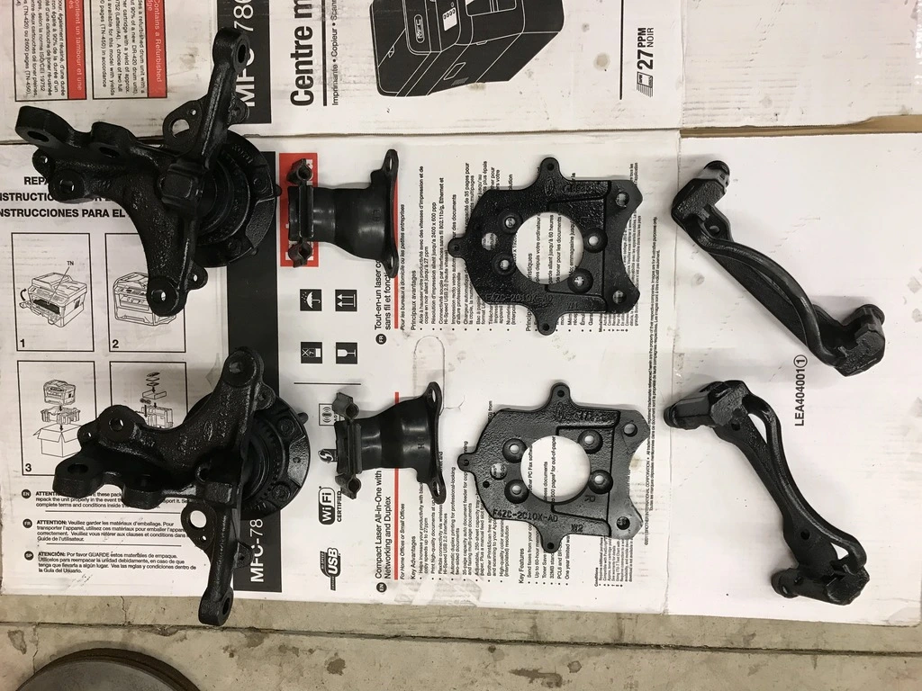

I think it was the smartest move cost wise. I was at $380 for just 4 reman'd calipers, so this was a no brainer. I mean this is the complete kit so yeah, now the question is do i paint the calipers or just leave them as is. I think I wil spray bomb the brackets at least.

How about black for the brackets and then aluminum for the calipers, not looking for flashy but since spending the $$ I want it to look decent and stay looking decent.
