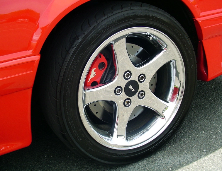

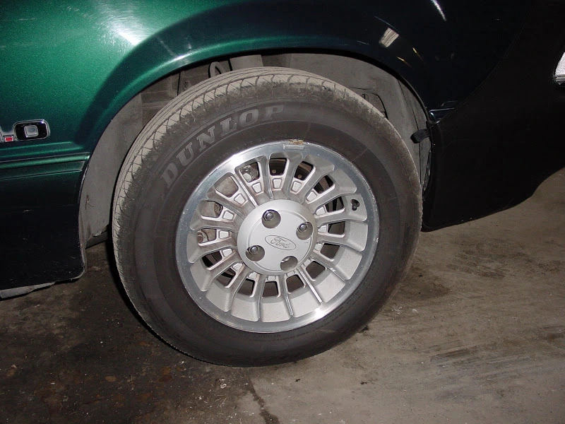

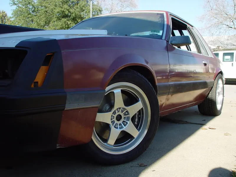

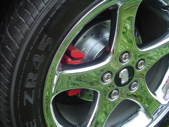

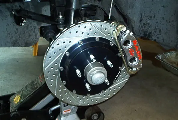

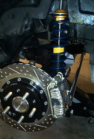

M-2300-K Brakes- havent installed the front yet since K member isnt installed!!

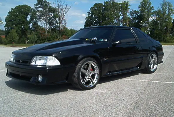

04 chrome cobra rims 17x9

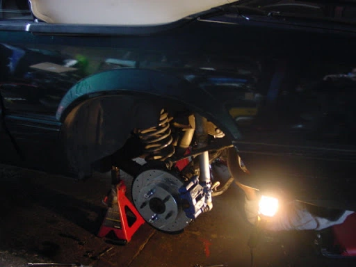

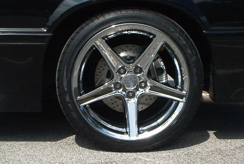

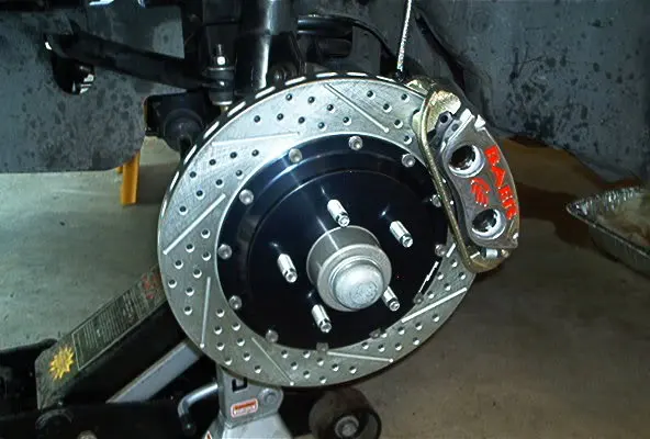

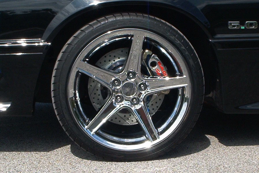

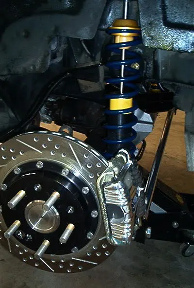

Baer M2300K Killer Kit - polished calipers, 2 piece rotors, ARP studs, blah blah blah. Brakes are a great upgrade on the foxes!

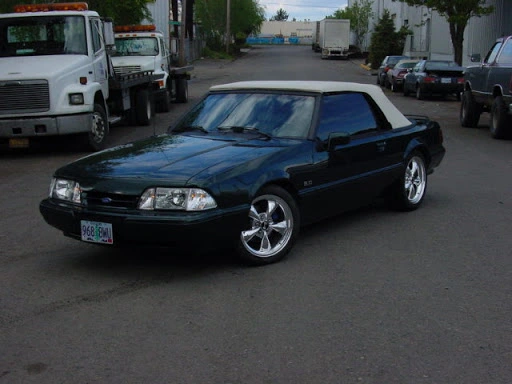

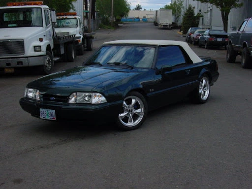

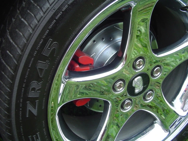

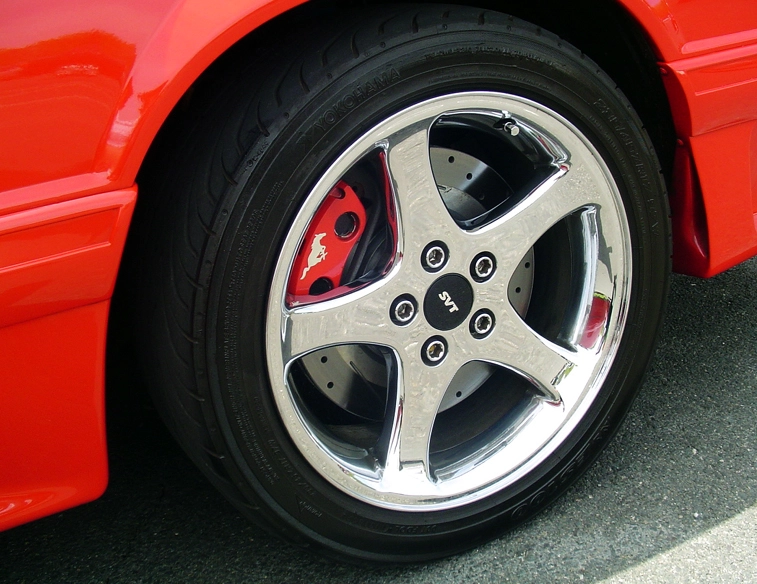

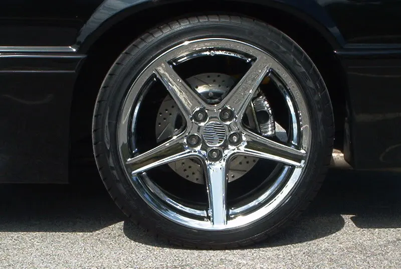

Bullitts w/99 Cobra rims. Specs are as they were from Ford, all around:
And you can see them peeking through here:

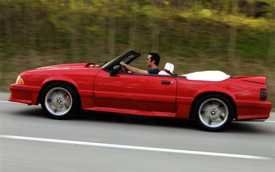

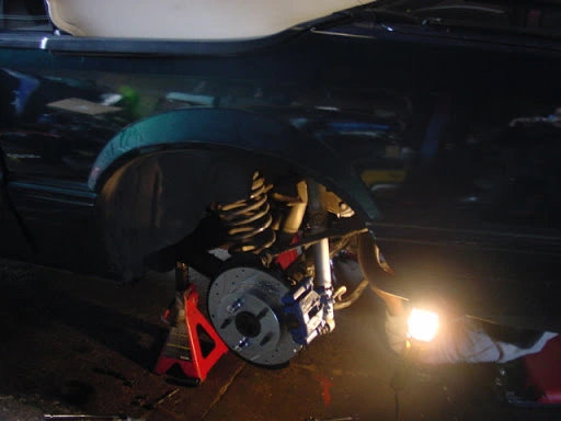

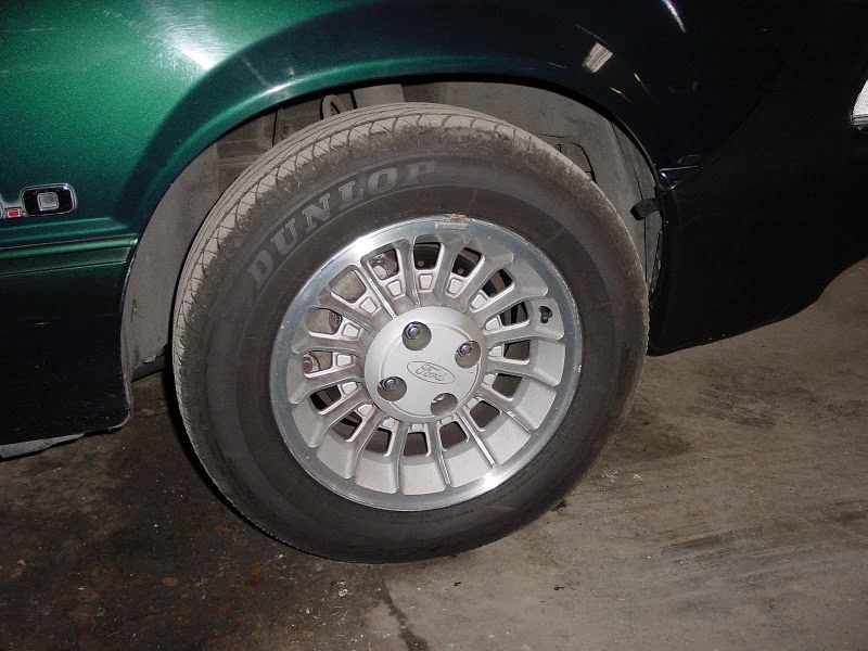

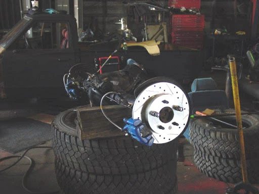

Rebuilt rear end with 3.73's and ranger axles, SN95 brakes, drilled/sloted rotors, 01 Bullits 17"x8", SS Brake lines. SN95 Front spindles/brakes, drilled/sloted rotors
Before, sport'n the turbines and stock suspension
During and After

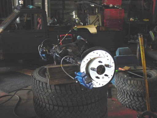

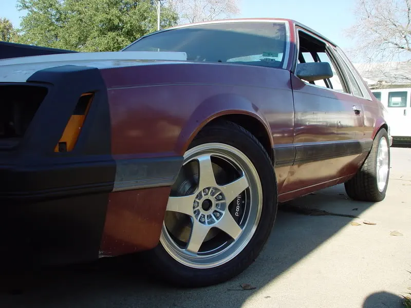

Mine's a little wierd but I'll post up. I'm running Wilwood Forged Billet Superlites (4 piston) all around on custom brackets, '95 spindles up front & an '03 Cobra IRS out back. For rotors I have c5 Vette rotors that I redrilled and the rear are the stock Cobra rotors. I guess a Cobra setup would have been a little easier, but I got the calipers for free & my work has a cnc machine shop that I can use during breaks. Before pads, m/c & plumbing I have nothing in it.
