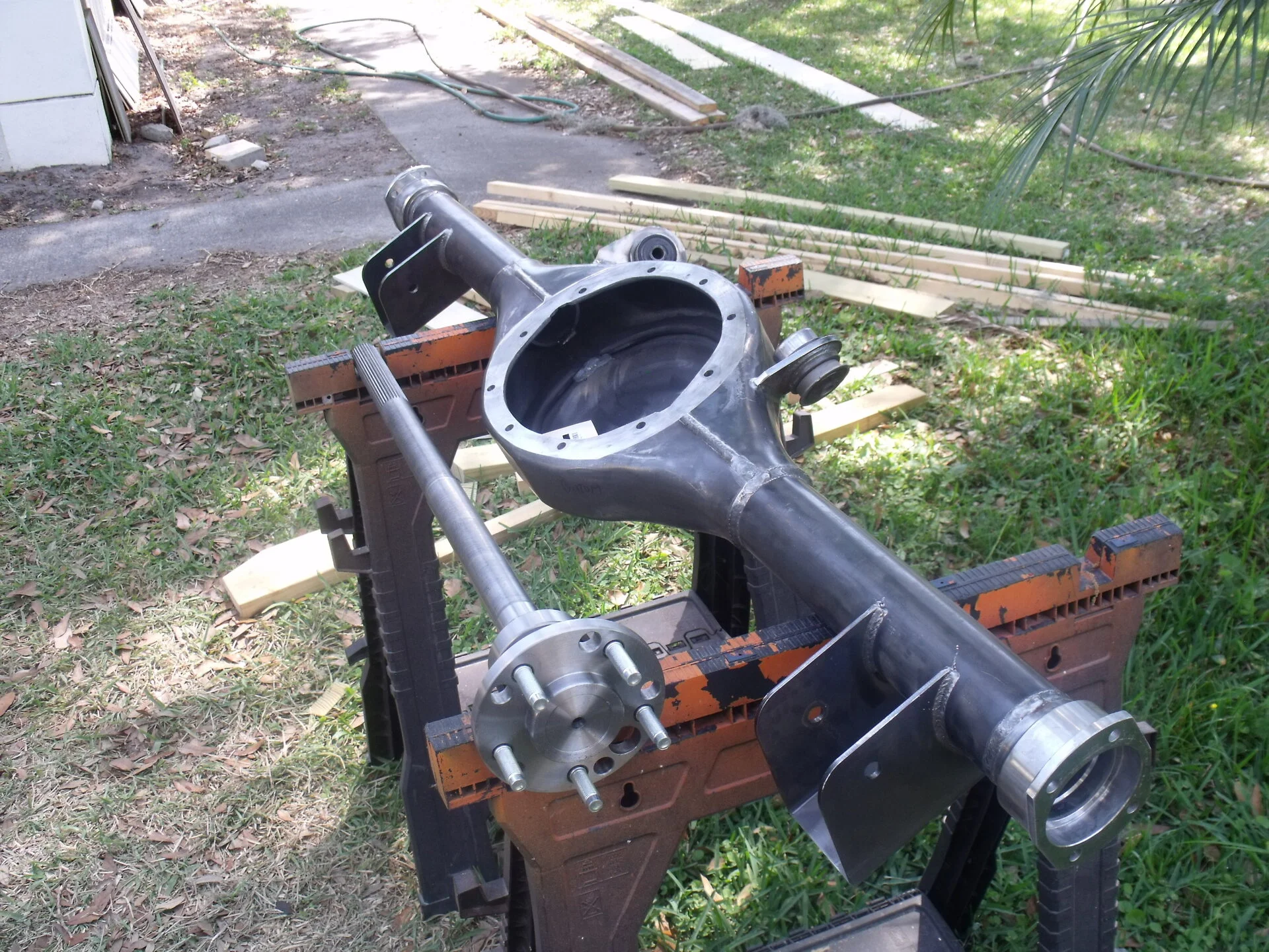

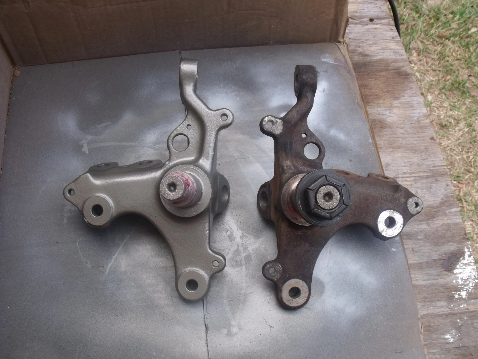

The rear end is being replaced, and I have SN95 front spindles to install, so then would be the time to do it...

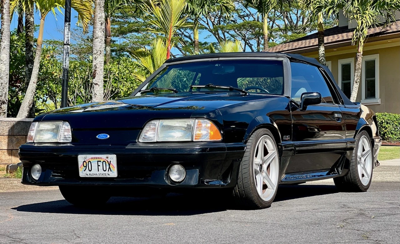

93SSP, your car sits nicely..... No rubbing ?

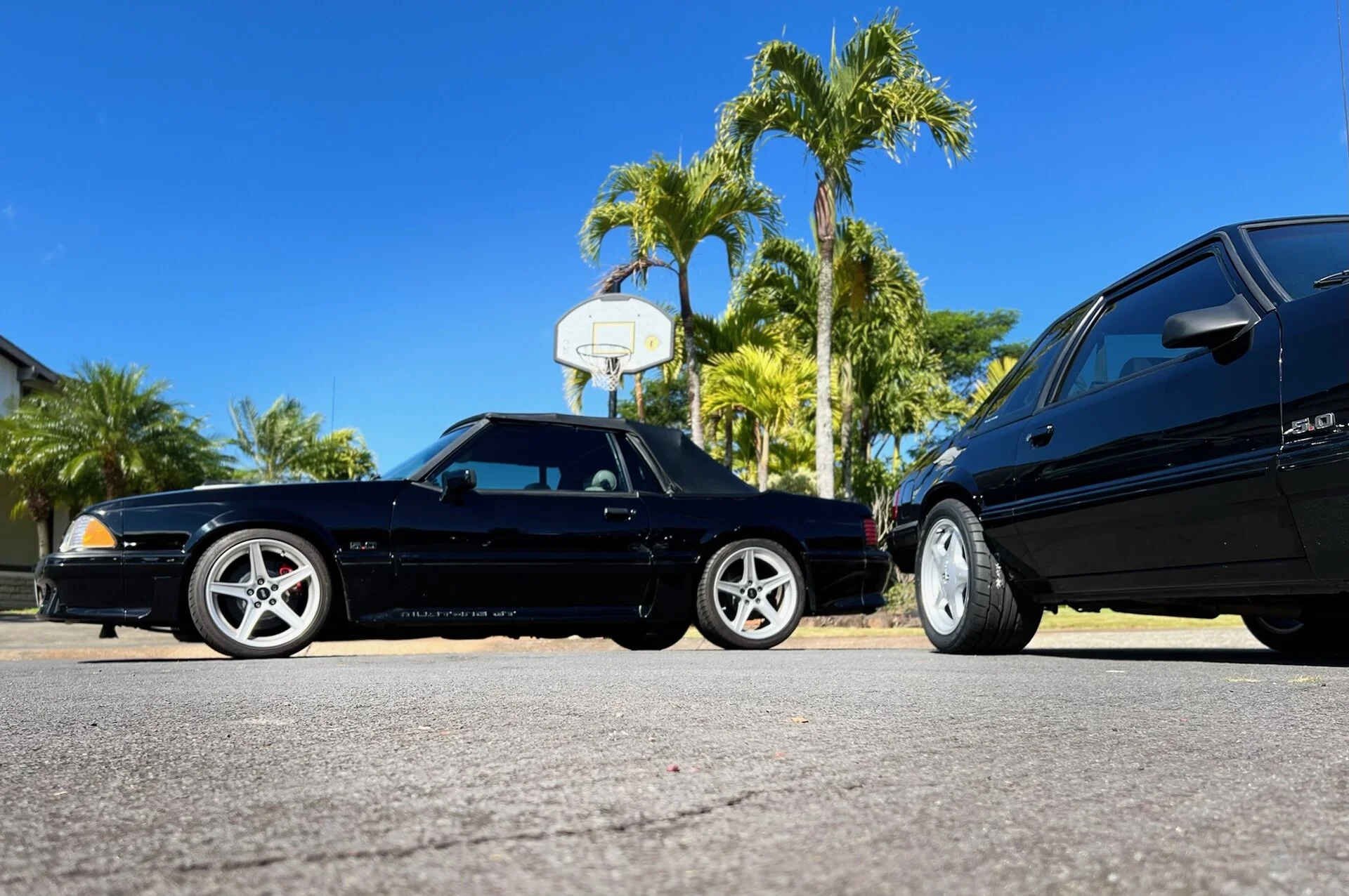

Ah, I thought i remember reading your coupe had the pro kit. I’ve considered these springs but wonder if a lighter coupe would have the same stance as your vert (which is great).
