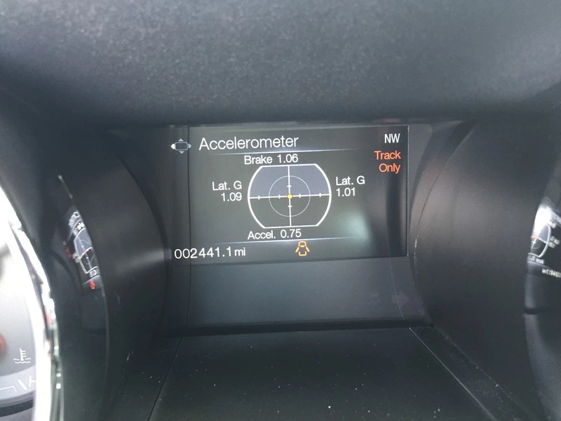

I've pulled a little over a lateral G in mine. Its stock with PP. I believe I had slightly higher numbers before I went to the autocross. There's a couple of back roads that I'm very familiar with that I believe I pulled 1.17 lateral left and 1.10 right. The 1.09 and 1.01 were from when I autocrossed an unfamiliar track. Can't wait to get out at Sebring and see what she does!

Question, what Tires are your running. With my stock tires, My acceleration is about the same .74, I've only pulled in the mid .80's on lateral G's but that's just driving to and from work.

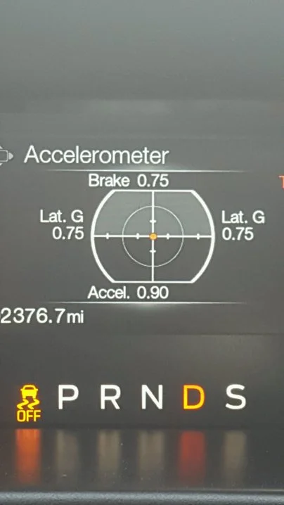

Reviving this here for a second... Out of curiosity I was in "Mexico" on a set of street tires and wanted to see what the linear G meter would read on the street. This is what I was able to see:
It's a shame that the battery has been disconnected since the last trip to the road course as I would have like to see those numbers there as well......
There are some traction issues as you could imagine but just hazing the tires in 1st gear with my auto car I was able to see .90 G in forward acceleration. I expect this to improve at the track and expect noticeable improvements after the headers and converter are installed this winter. It seems that we will be going to the track Saturday for the first time with my 15"
