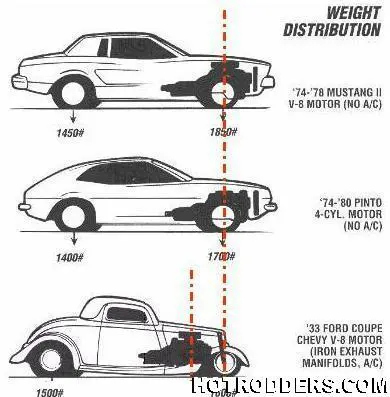

Since the MII front suspension or some derivative is popular with the circle track racers, they might be a good resource to go to for advice. They would also be a good resource for finding the front weight of your car as most will have access to a 4-corner scale. Other than that, the best I can tell you is to have the whole car weighed, then figure your front weight from the published MII V8 front/rear weight distribution of 59/41. Of course if you have taken some weight off of the front end (removed the AC, replaced iron parts with aluminum like brackets, heads, and water pump), your weight distribution may be different.

I came across this weight diagram on the web a while back...it might be useful in deciding on spring rates. It may have originally come from a spring or suspension parts manufacturer. I recall seeing something like it years ago.
Find a local warehouse that deals with big rigs, or asphalt or gravel business, or even a highway weigh station and run just the front tires onto the scale to get your nose weight. Do it all the time in the Peterbuilt when hauling asphalt/gravel. We're only allowed so much weight on the front axle of the dump trucks or you'll get a big stinky ticket for being overweight even though you're not on the back axles.
