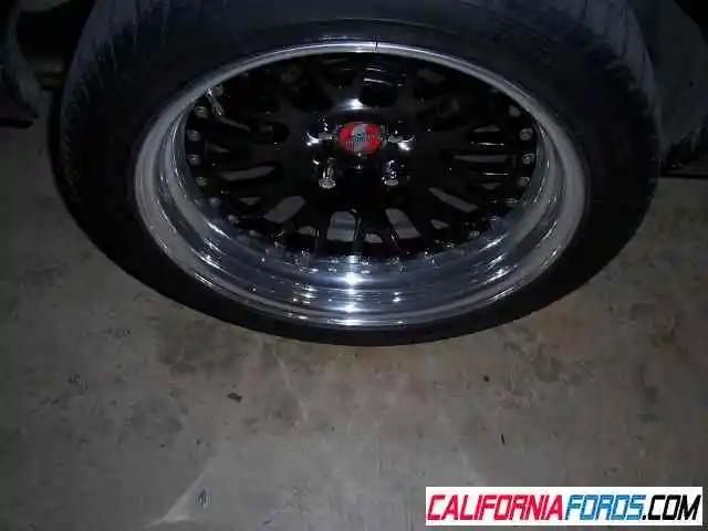

car pics
GT Trooper said:
Do you have any pictures of your car with those 10 inch wide wheels on it?
yup just took some, ill put some daylight ones up later, from the rear
those wheels are simply amazing, what are the called?
BlackDrop50
Jul 14, 2002
217
Bay Area, CA
Dec 23, 2004
#14
  • Dec 23, 2004
  • #14
CCW 17" 3 piece modular street wheels, anodized black in the middle with polished lip. Those are real ARP bolts all around the rim. They are custom made for a fox body with 4 lug. I haven't seen anybody else with the rims, even on the internet, well I've seen em on new cobras, but never on a 5.0 in 4 lug.

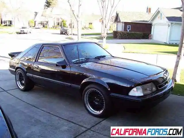

thanks, heres a daytime shot, i took some rear shots but they didn't come out too good, now it's raining!

haha wow.. i forgot how tiny my old 5.0 was... you can fit 295s up front in the 94+'s going with 285-35-18s all around as soon as my stuff gets here

W O W.....wow!!! sweet rims..and ...car Makes me wanna say to hell with saving up for heads and get rims instead
