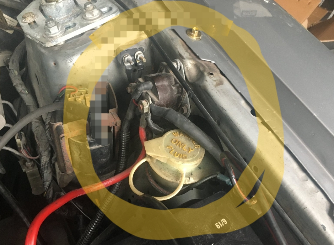

In looking at this picture of your solenoid, it looks like your positive battery cable is connected on with a large black cable that goes into the fender well. Does that black cable go to the starter, or is that the black cable you bolted onto the timing cover to ground?
It must go to the starter, because I never touched that one. I’ll take a look and see if I can figure out where it goes.
Just want to verify that it is not the cable that you grounded.
I understand. I'm not sure exactly where it goes, but it's not the one I played with. It was definitely the negative battery cable that I bolted up. I tried starting it again, and it seemed ok. Could I have a bad solenoid and the fact that it's happening after I hooked up the ground just be a coincidence?

What starter are you using? One has only the cable from the solenoid to a bolt on the side of the starter, the other looks more like a gm starter ( :eek: ) with a smaller wire along with the positive cable.
I have no idea, I'll check tomorrow.

My previous statements were based on the assumption that that cable was the ground. If it isn't there is some weird stuff going on that needs to be sorted out.
Again, I would start at the solenoid and start tracing wires. Look up some wiring diagrams and make sure things are going to the right spot.

Can an ignition switch stick so bad that you remove the key and it still keeps cranking? I'm honestly asking because I find that hard to believe.
Yes, but on this particular car it's more common for the starter solenoid to stick, usually after shorting internally due to not being grounded correctly. (Both can happen on a fox though.)
