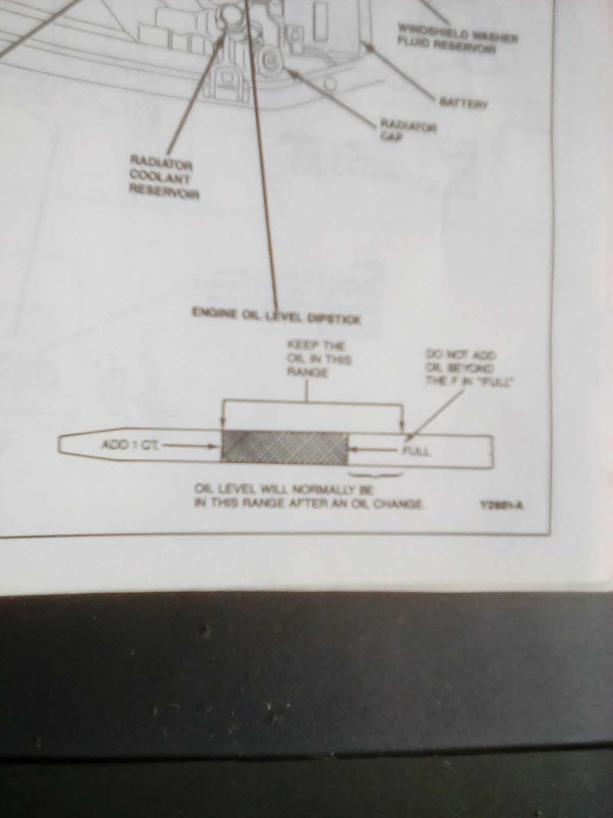

I took this with the kindle so not really clear but you can see that the factory assembly manual shows that it will be as high as the F (full) on the dip stick.
start it up, get it warm, change the oil, drive it like you stole it.

Is that an 87-93 dipstick? Mine just says “fill” at the bottom of the rough part and “max” at the top. I imagine the principle is the same though.Right now, the oil trails off at max when the engine is cold. I’ll take a closer look and maybe drain a little bit more when I get home.

Thats a 89 manual, don't over think it. If you feel the need just change the oil at 1000, then at whatever regular interval you usually do. then get on with life, I change mine with synthetic every 5k. 5 quarts and a filter.

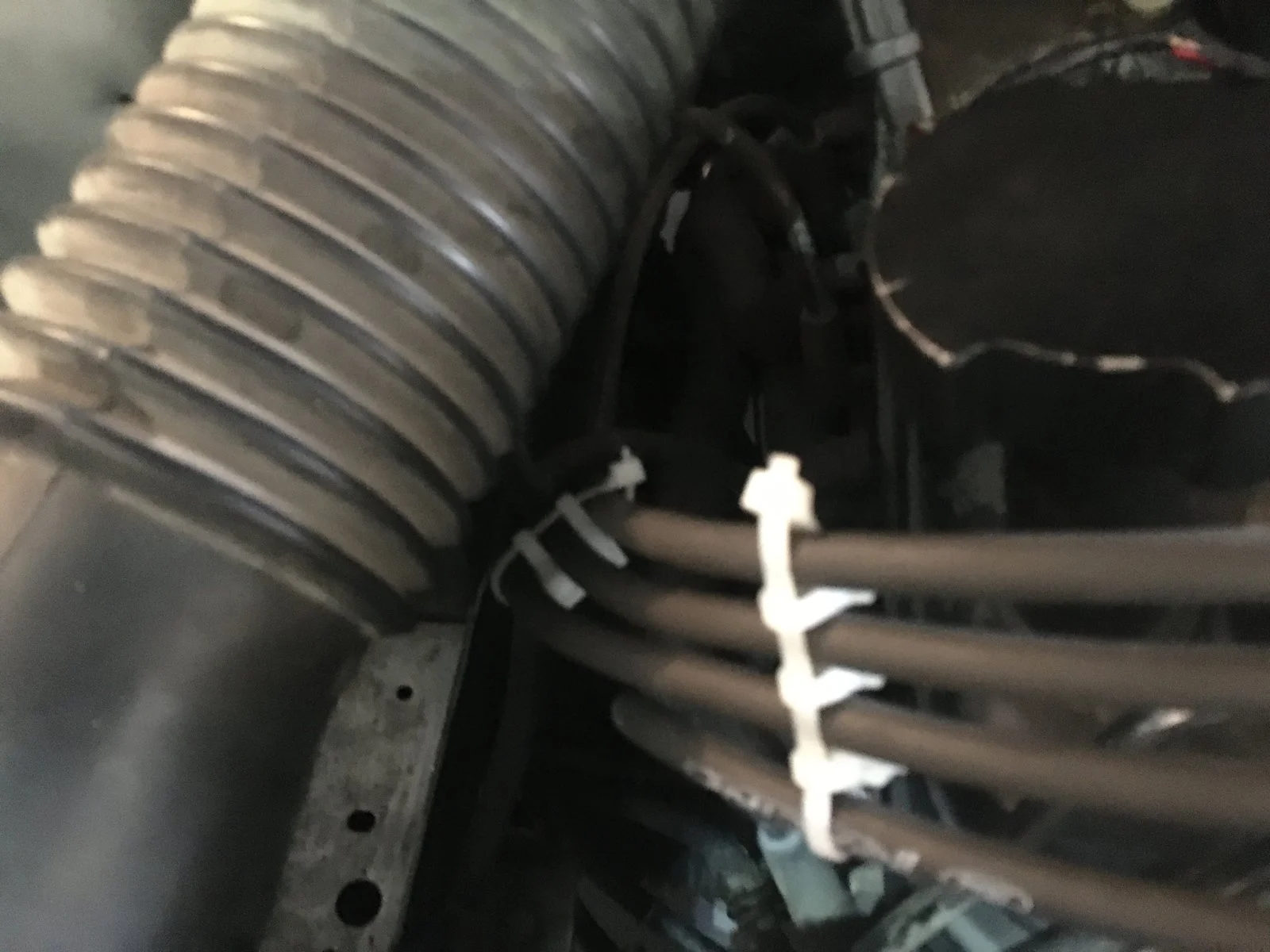

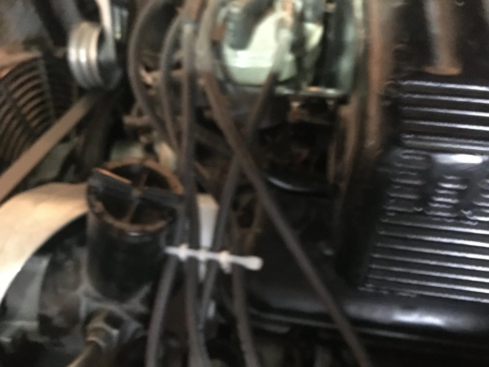

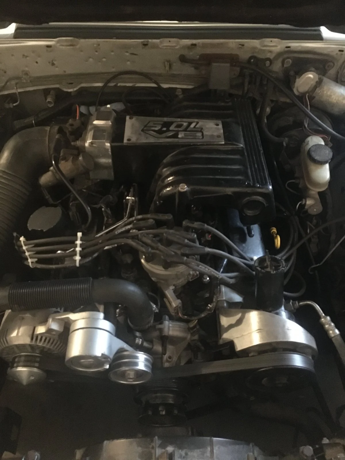

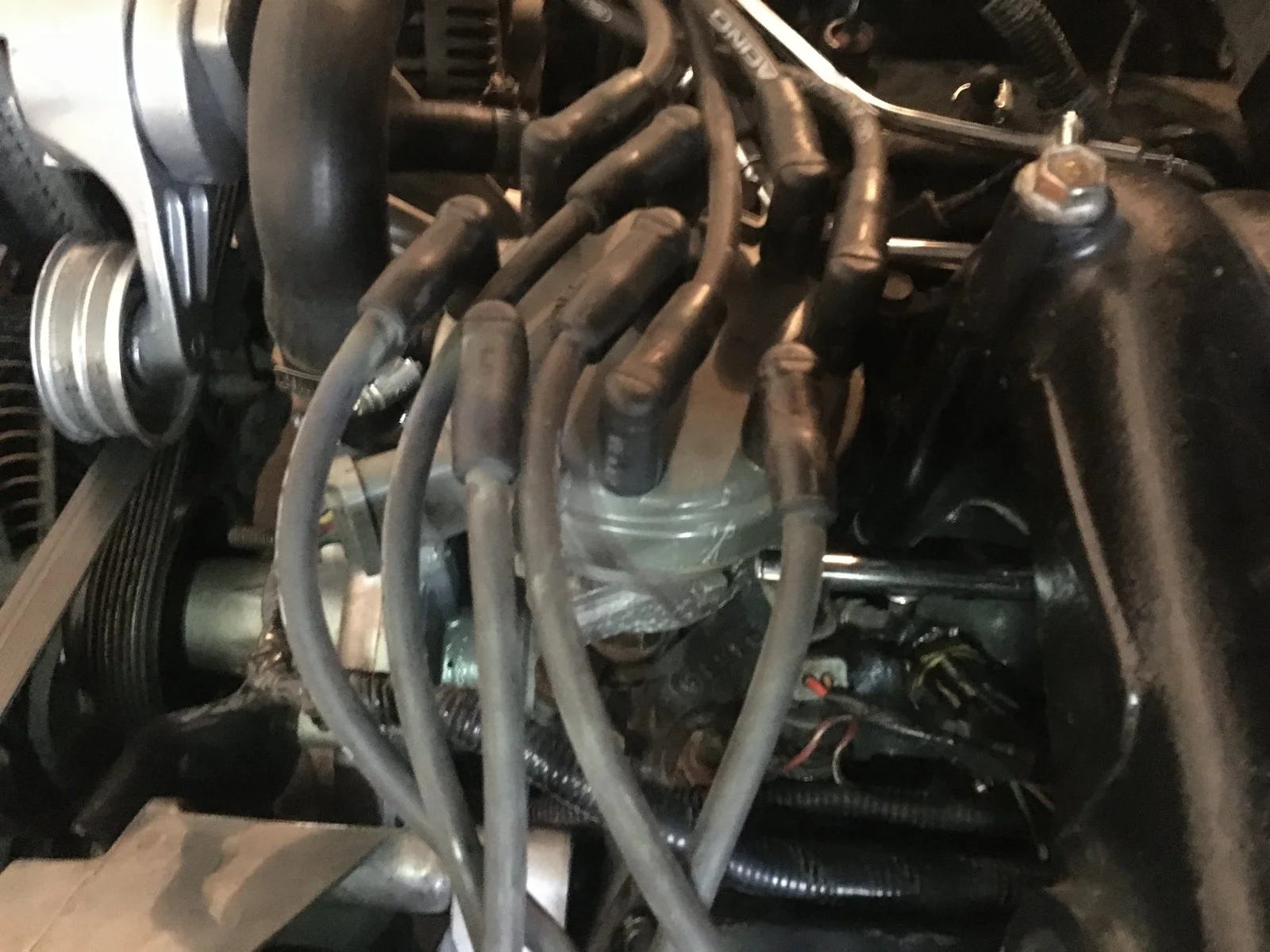

They didn’t need me at work today, so I spent some time trying to clean up the wires in the engine bay a little bit. Let me know what you guys think, I tried to separate the wires based on a diagram I found.

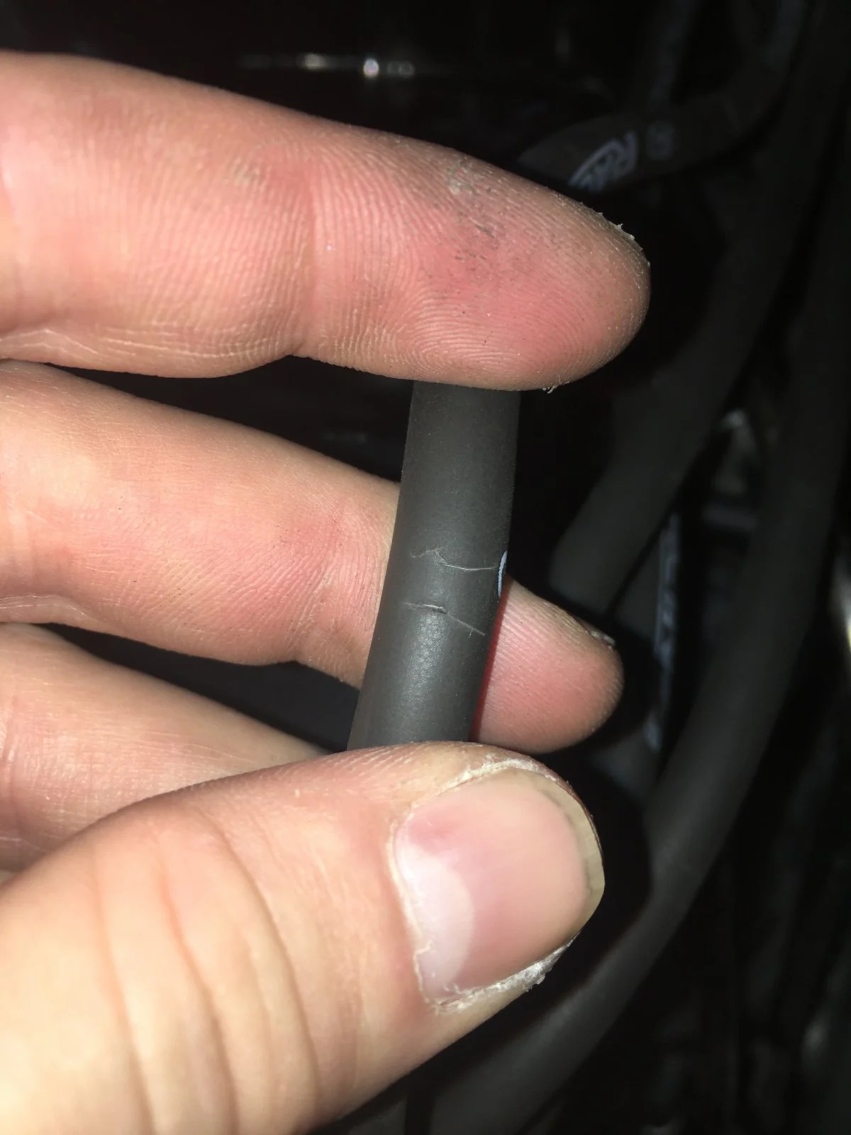

I did pick up a set of traditional wire separators from autozone on my way home from work, but they didn’t fit right, and they did this:
It looks like the plastic cut through the first layer of insulation a little bit. Do I need new spark plug wires?

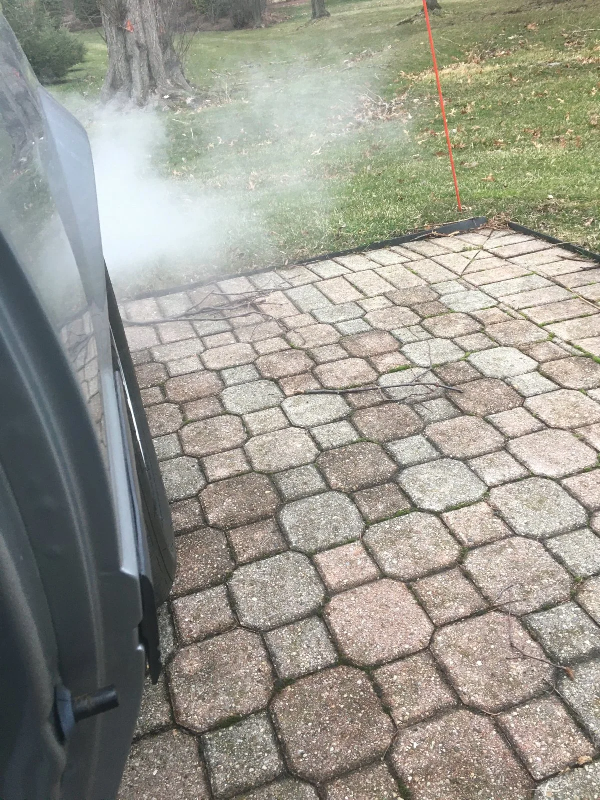

Also noticed that the car is idling at around 500-600 rpm and there's some smoke coming out of the exhaust. This is at about 2-3000 rpm:
and Ide:
It's a little chilly out here (40 degrees), so some smoke is to be expected. I also didn't smell any burning oil, so it's probably nothing.

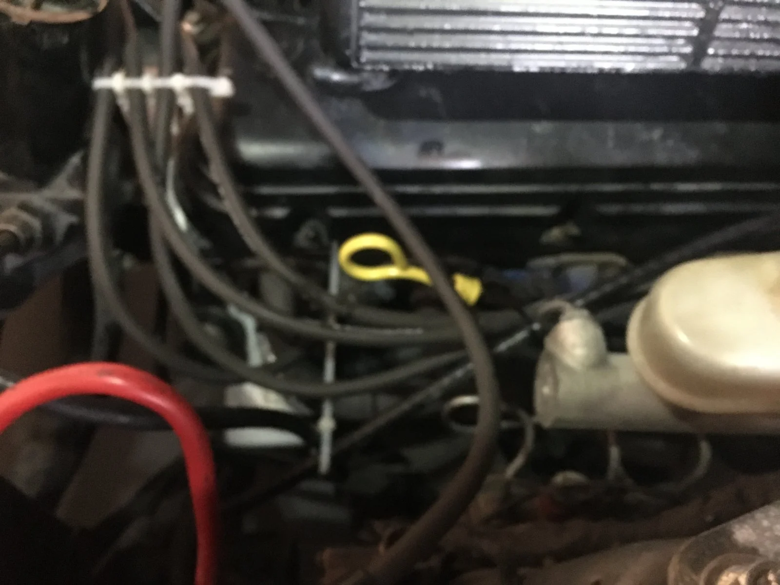

And finally, here's an extra photo of the whole engine bay Spark plug wiring situation:
That does not sound like a 500 rpm idle to me. Sounds more like 750-800 I would sooner suspect that the tach is not accurate.

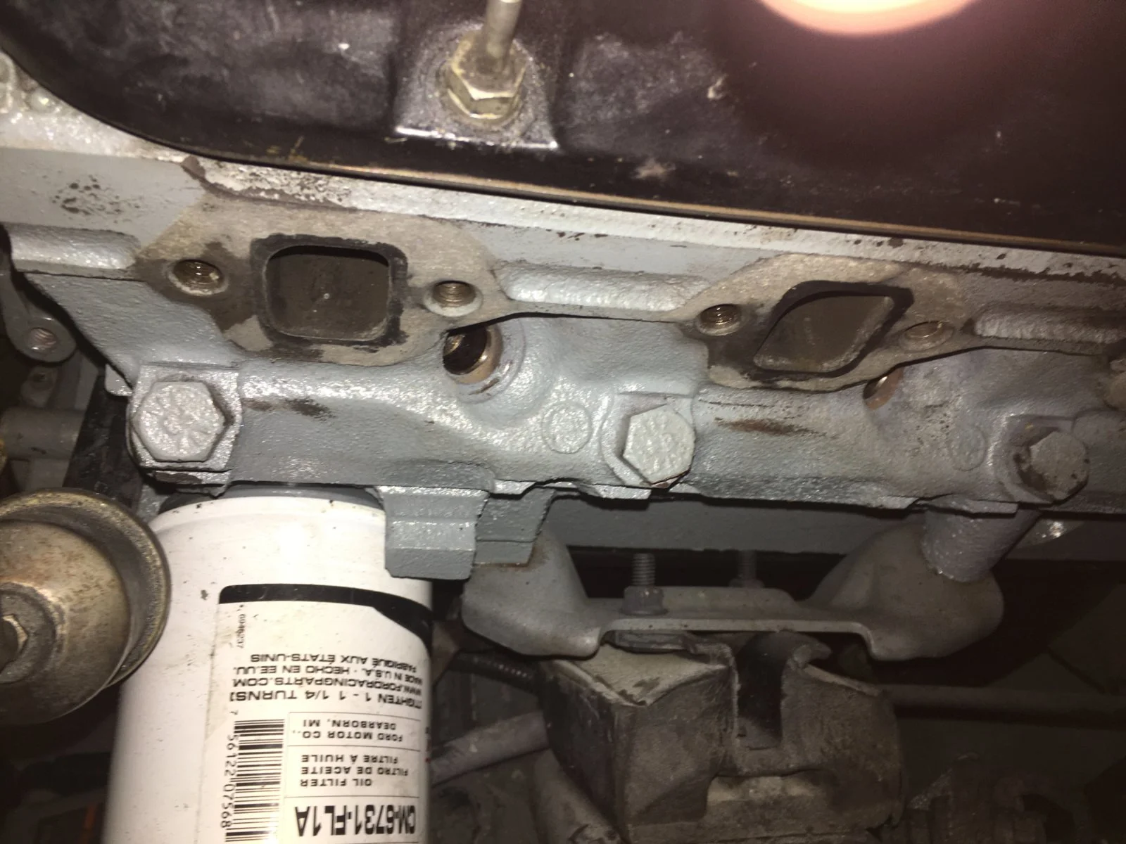

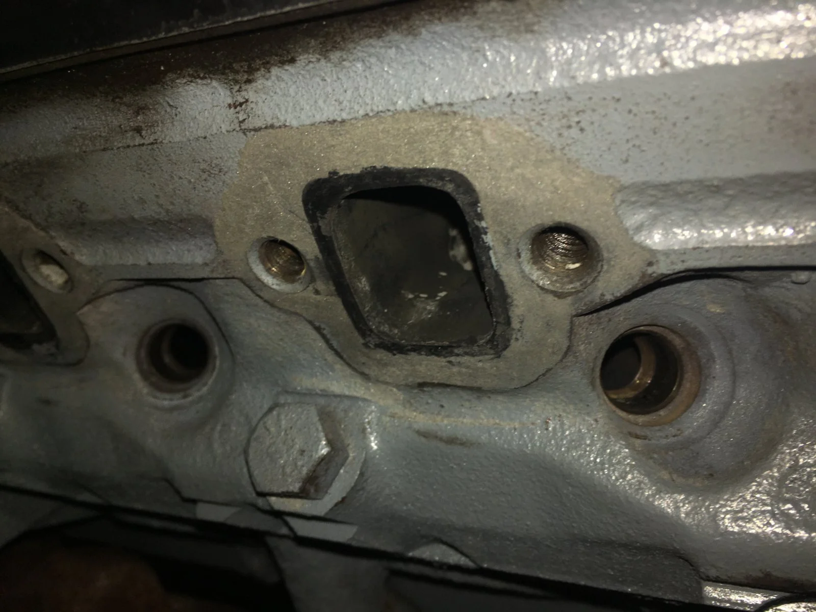

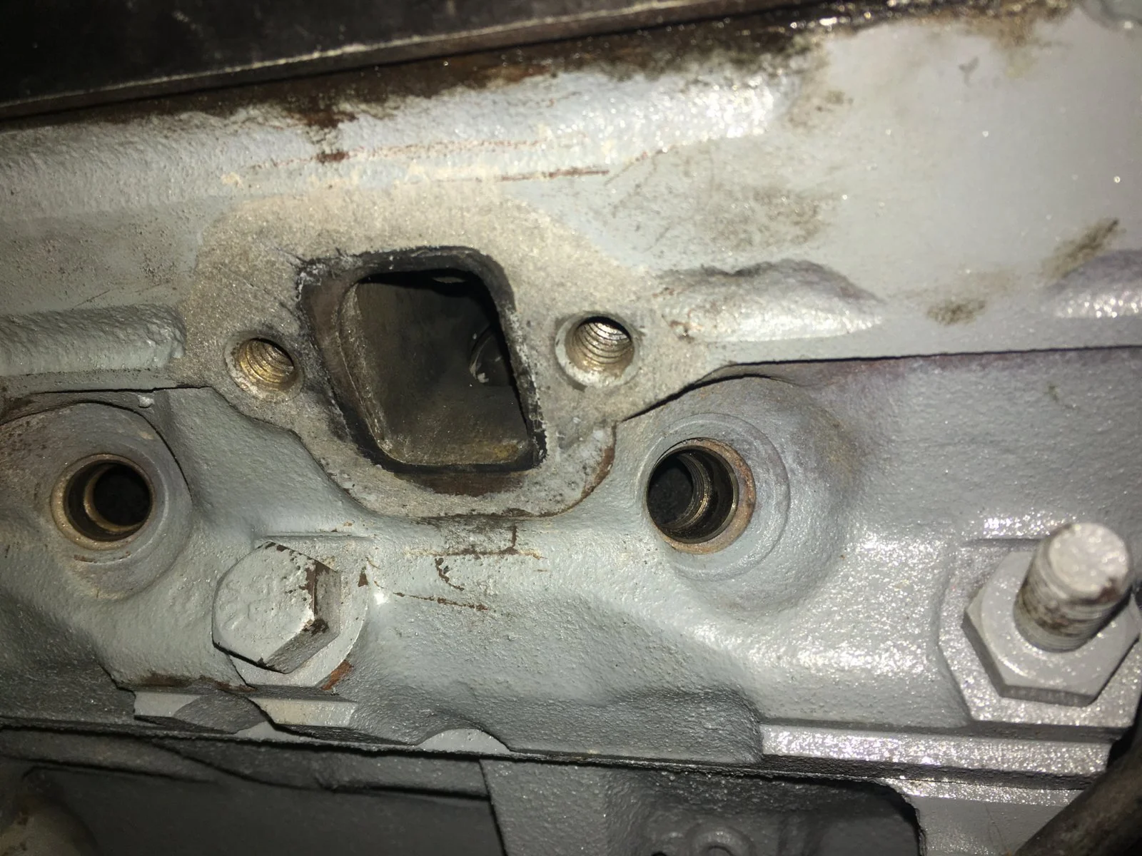

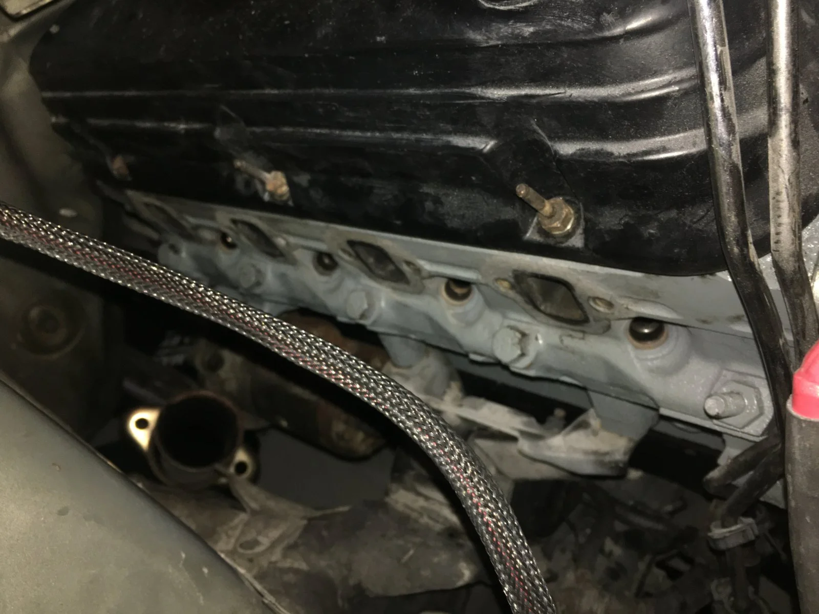

So I’ve been working on putting on the bbK headers I got a while back, but I’ve been having a real hard time getting the old gaskets off. I’ve been mostly successful with warm water and a razor blade, but is this good enough?
