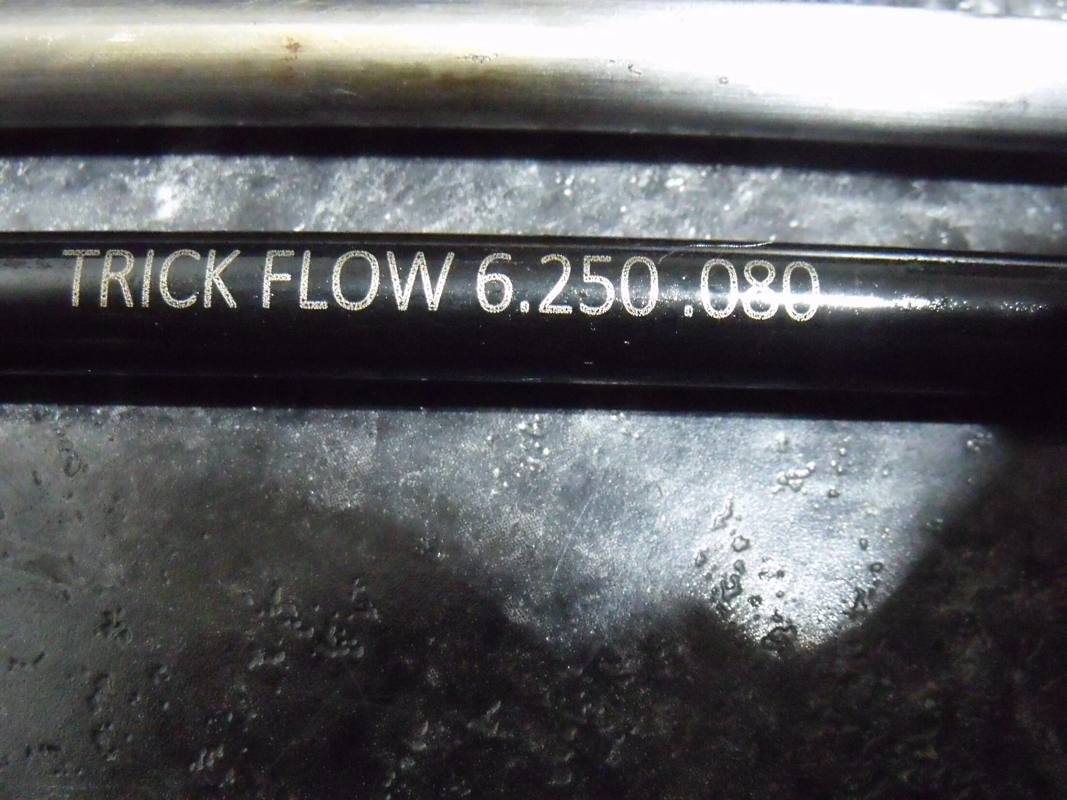

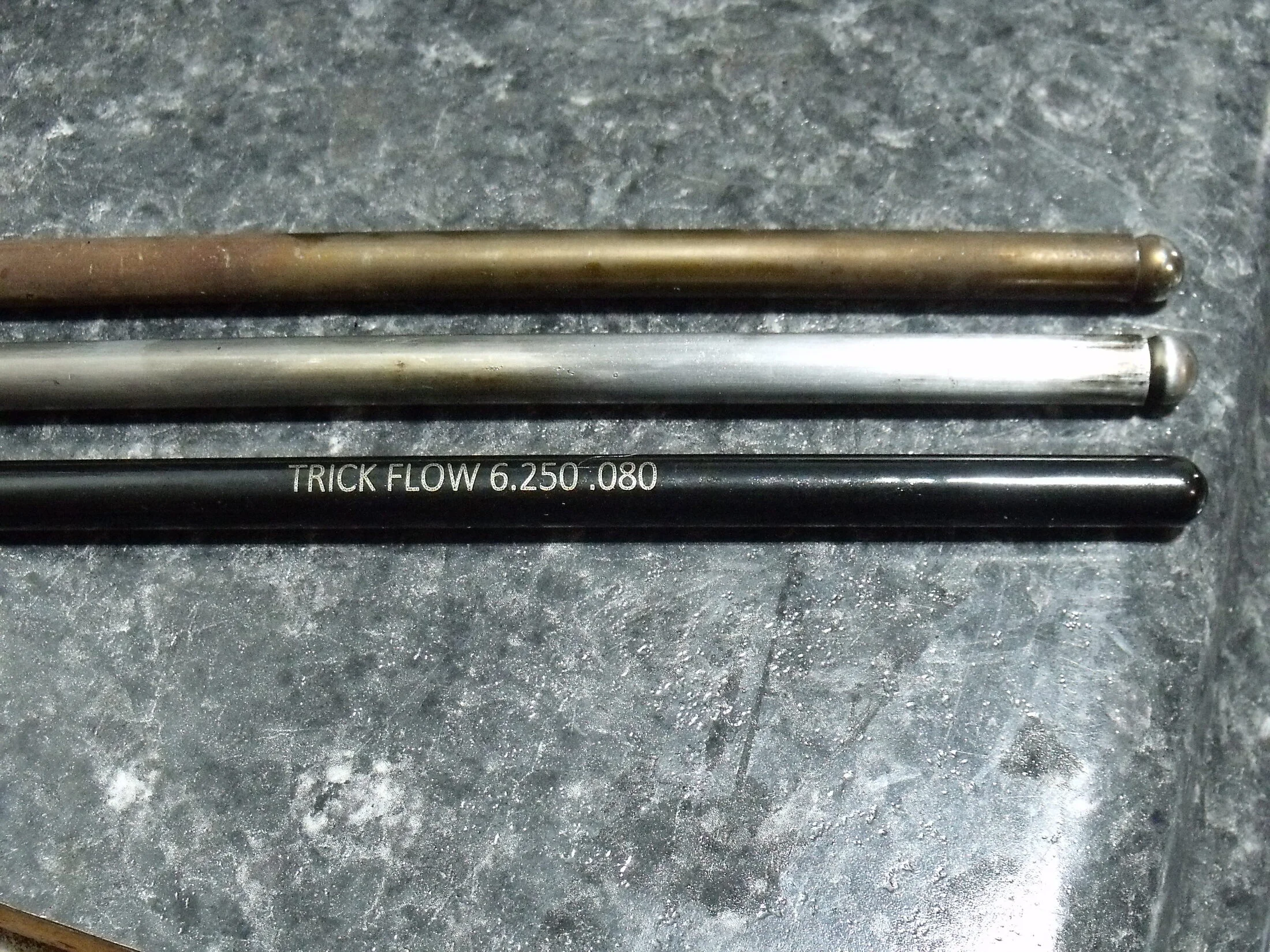

I ended up with these ( ordered anyways) pushrods... Everything else is new and I just couldn't see using the old pushrods....
I got one piece ( no welded balls at each end) 080 wall thickness ( stock is 060) and they havent pushed on a valve spring a couple of trillion times.. Yes, a bit of overkill for my engine......
I do appreciate the comments and I know the old ones probably would have been fine.... oh well.....
These are Trick flow 6.250 pushrods from Summit......

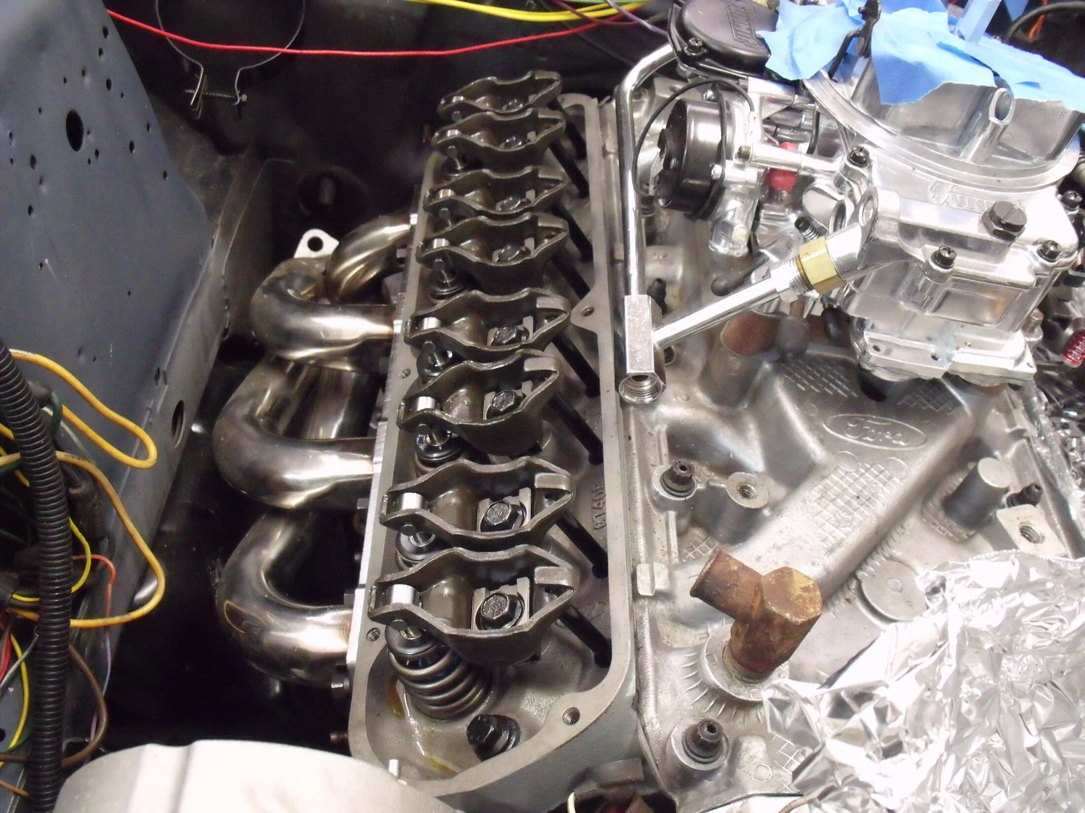

All installed and preload is +/- 3/4 of a turn......
I wasn't comfortable with the pass side bank so after sleeping on it I loosened them all up re did them..... They were fine..

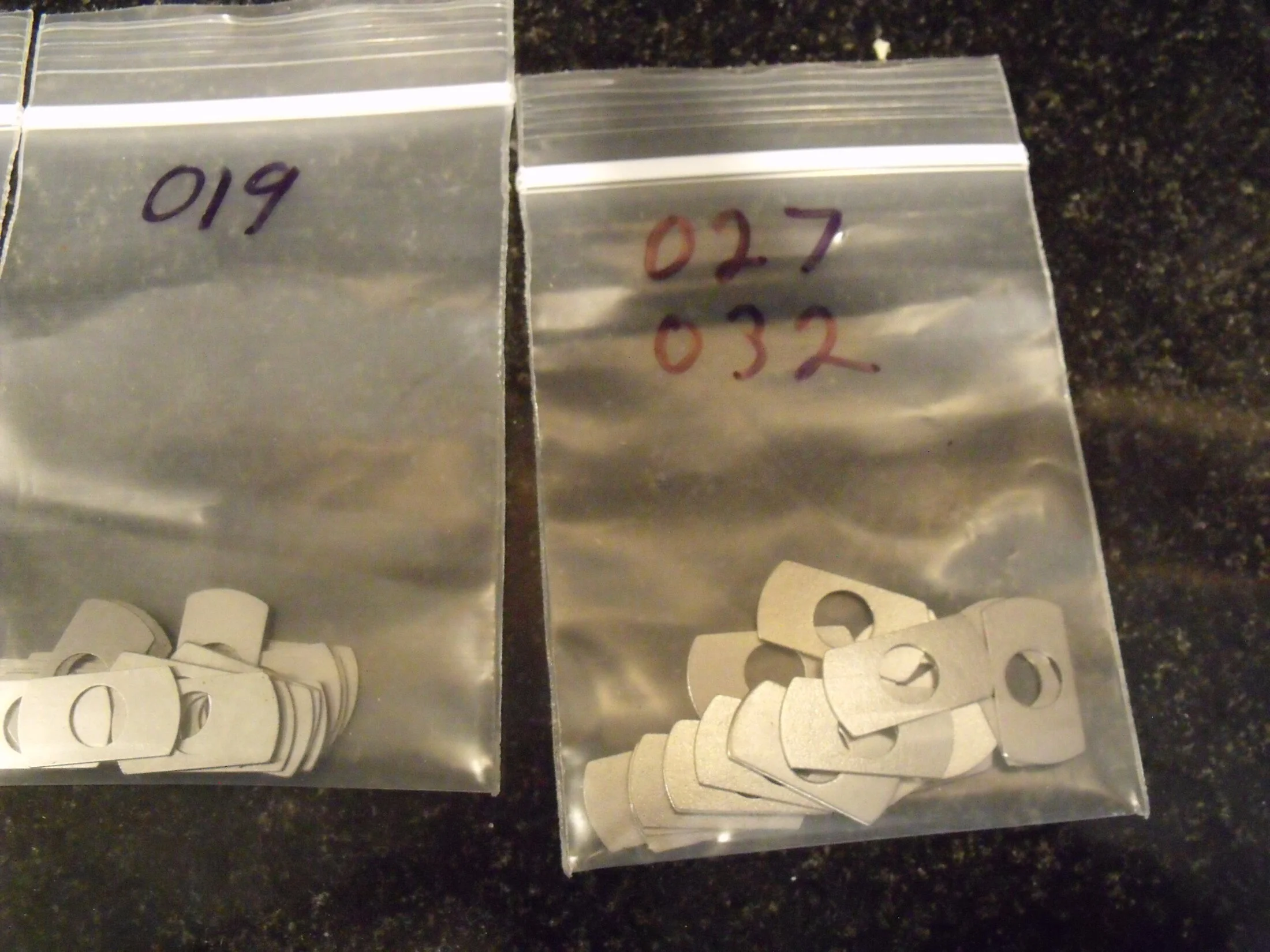

Tried out the smallest shim I have just for fun ( 010) and was surprised at how much it changed the preload... Be advised if you need to use the shims for preload adjustment...... Numbers on the packs are after I mic'd them.....
Watched #1 intake cycle and ran the timing to 10 degrees to help set the distributor for a hopefully quick first start......
And yes, there will be a new heater hose fitting on the intake......
