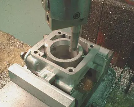

For my EGR spacer, I put it on a milling machine at work and bored it out. Took about 15 minutes. I also have a spare one punched out to 70mm.
