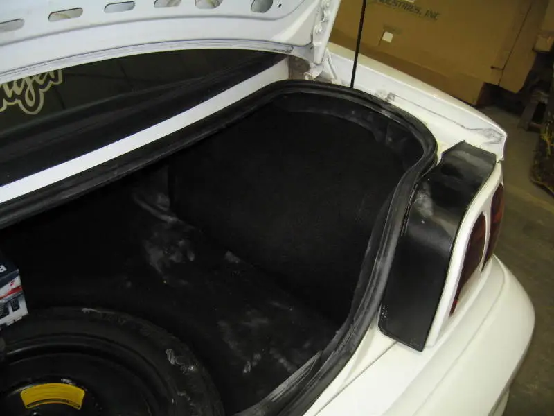

Mines pretty light.. Just use an efficient sub and small amp to keep it light...
